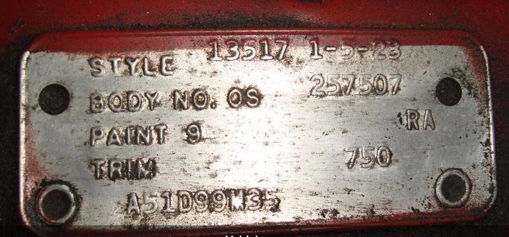

Below is a 67 Chevelle Oshawa trim tag. 9 and RA = enamel paint, R being Bolero Red (lower body color) and A being Tuxedo Black (upper body color).
Remember GM of Canada was heavily Chevy based.

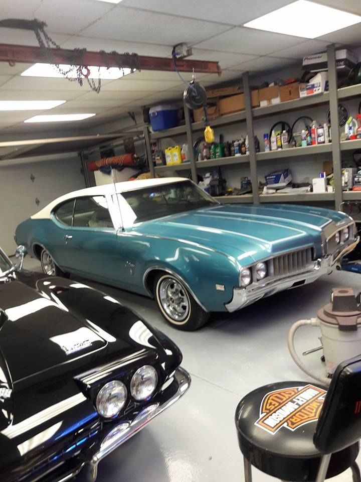

My 68 was a K code with a white top & pearl gut (parchment) Now resale red black/black. K Its actually quite striking. If I did my car over again I be hard pressed to not go K code parchment...with no vinyl top.
Regardless its a cool car to restore. You dont see many today, especially K codes.
K code 68 with white/parchment
69 K code white w/parchment
