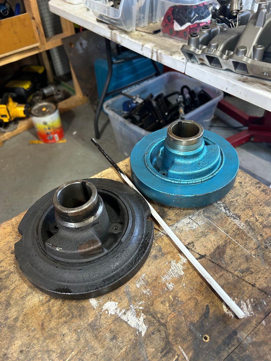

Originally Posted by Chuck22
382356
know where I can buy a new harmonic dampener ? 1966 425. All I’m seeing from parts stores is a 1968 part that needs to be machined down. Any suggestions ? Are these not sold anymore?
Blue is a 455 for comparison. Some sites say to have a machine shop turn down the 455 . I’m guessing on a lathe take down some of the weighted item on the back?
Old Feb 10, 2024 | 08:30 AM
66-3X2 442's Avatar
Posts: 5,193
From: Birmingham,Alabama
The 425 balancer is internally balanced and the 455 is externally balanced. Just do it the right way and have a 425 rebuilt unless you can find a good used unit.
Old Feb 10, 2024 | 05:04 PM
Run to Rund's Avatar
Joined: Mar 2008
Posts: 4,026
Both are externally balanced engines, but there is less counter balance in a 330-early 400-425 balancer than in the later ones for the 350-late 400-455.
Old Feb 10, 2024 | 06:02 PM
66-3X2 442's Avatar
Posts: 5,193
In other words they don't interchange. Tanks Dad for the info.
