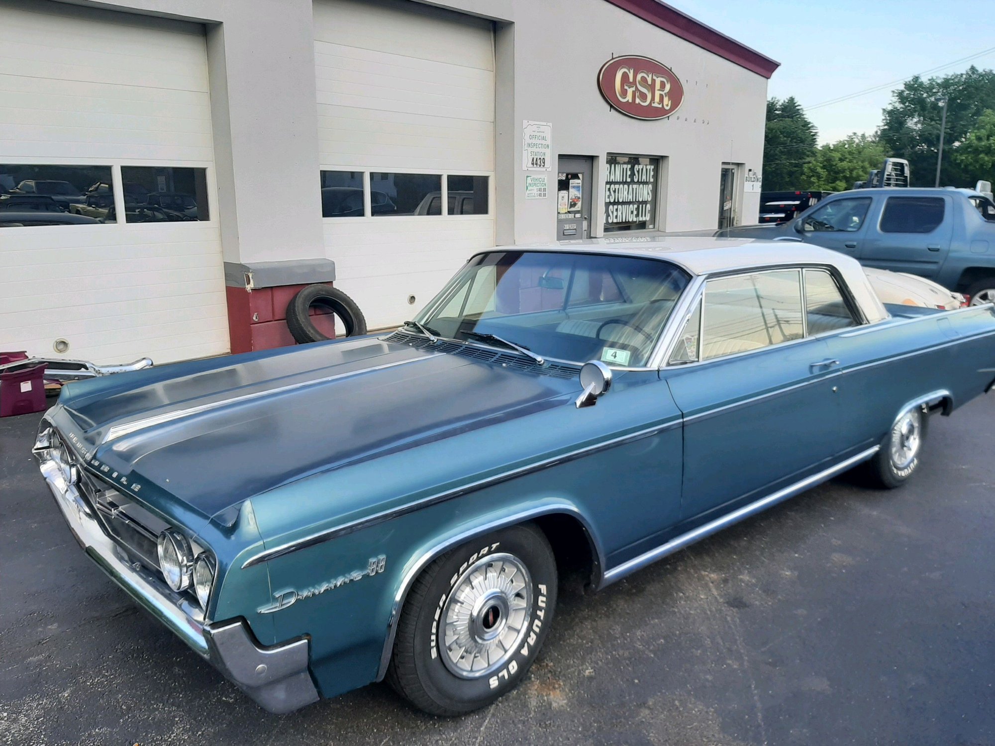

Hey all, new to the forum and excited to learn. I’m a medically retired Army veteran with admittedly no background in classic cars. I left the military with some really tough mental health, but buying this old car brought me joy and purpose in having a project and things to learn.
i recently found and purchased an 88 coupe and brought it to a shop to repair all the leaks and make a bunch of safety fixes. When I get it here soon, it should be in great shape and ready to drive daily.
My question is, what sort of daily maintenance should I be doing? I heard from someone that I should be adding some sort of additive when I fill up the gas tank (on premium). Other than that isn’t just regular oil changes and keeping up with issues?
Thanks so much for everyone’s help! Cant wait to soak up some knowledge here.

Welcome! Congrats! And that thing is gorgeous!
I will let some others chime in with fuel additives as I’ve never had a use for them personally.
As far as daily maintenance, they usually don’t require much if you drive them fairly regularly.
The charging system should be checked to see what it’s throwing out to the battery, you may want a battery tender if it’s just being driven once a week.
You also may want to check for any slow drains.
Theres nothing more frustrating than wanting to go for a ride and then having to charge it for an hour.
Be safe with your driving technique and give everyone a wide birth and your self plenty of time to slow down and avoid the dopes out there.
good luck man and thank you for your service.

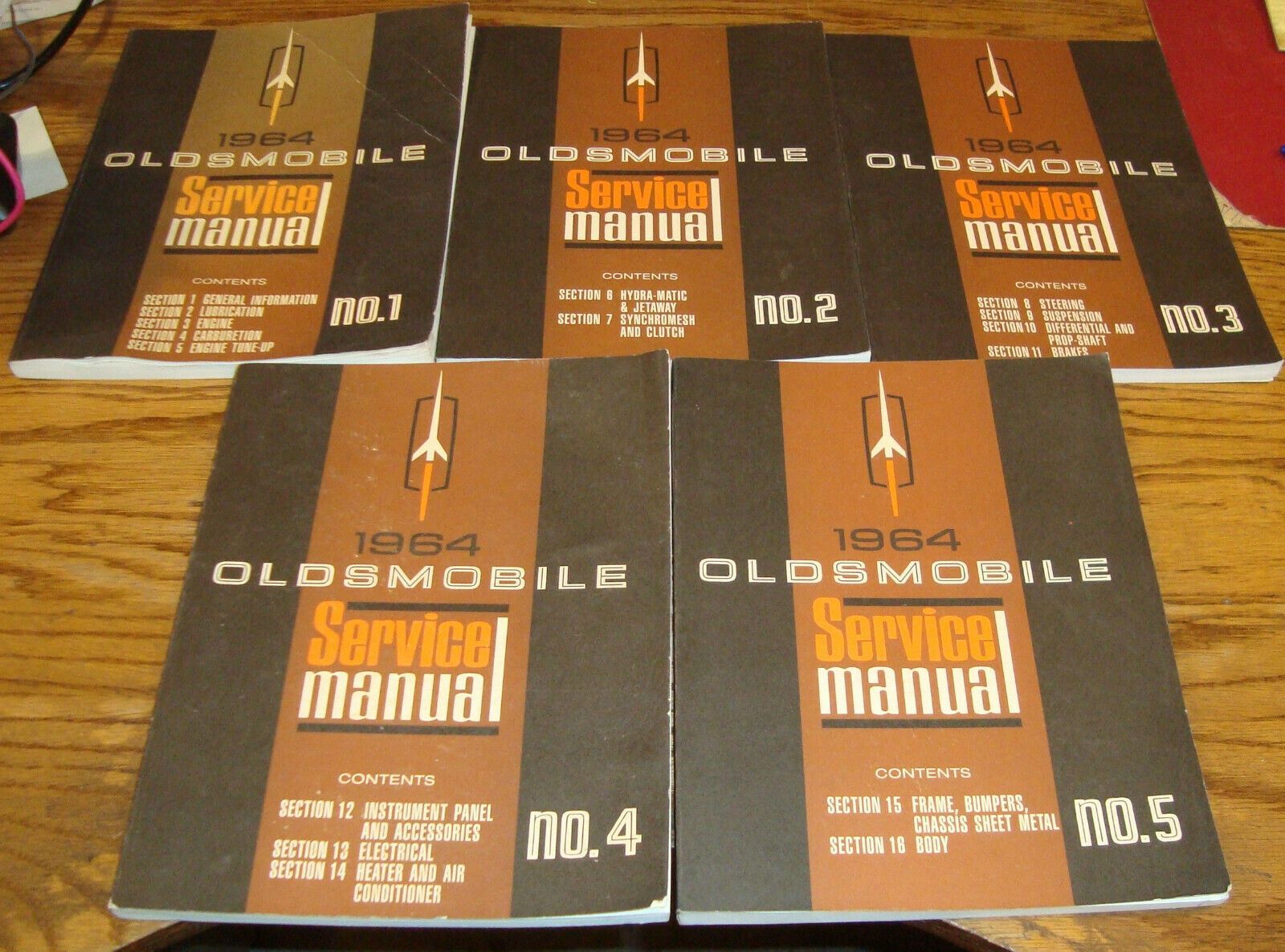

Welcome. I would strongly suggest that you purchase an original, paper copy of the 1964 Chassis Service Manual. It is a five volume set and the first section covers all factory-recommended maintenance and suggested intervals. Do not get a reprint or electronic copy, as those are all scans of a paper original and details get lost in that process.

Welcome and thank you for your service to our country. Beautiful car. All good advice above. The service manual will be the best thing you ever buy for your car. One thing I did not see mentioned above was motor oil. Zinc is important to these old engine with flat tappets (lifters) There are several recommendations but many of us use Valvoline VR1 Racing Oil. I imagine your car will use 10W30. It has all the zinc you will need for your engine. My choice is Wix filters. You don't really need any additives for you gas unless it is going to be sitting for a prolonged period. Then I would add some Sta-Bil. Enjoy your car. She's a beaut CLark.

Oh wow—do you know a good place to source those complete manual sets?

E-Bay is probably best place to look for service manuals.
1964 oldsmobile service manual for sale | eBay
Old Jan 23, 2024 | 07:43 AM
redoldsman's Avatar
Proud Viet Nam Veteran
Posts: 10,817
From: Rowlett, TX
Charlie is correct on ebay. Get an original manual and not one of the reproductions or CD's. Prices vary so shop for the best price.
