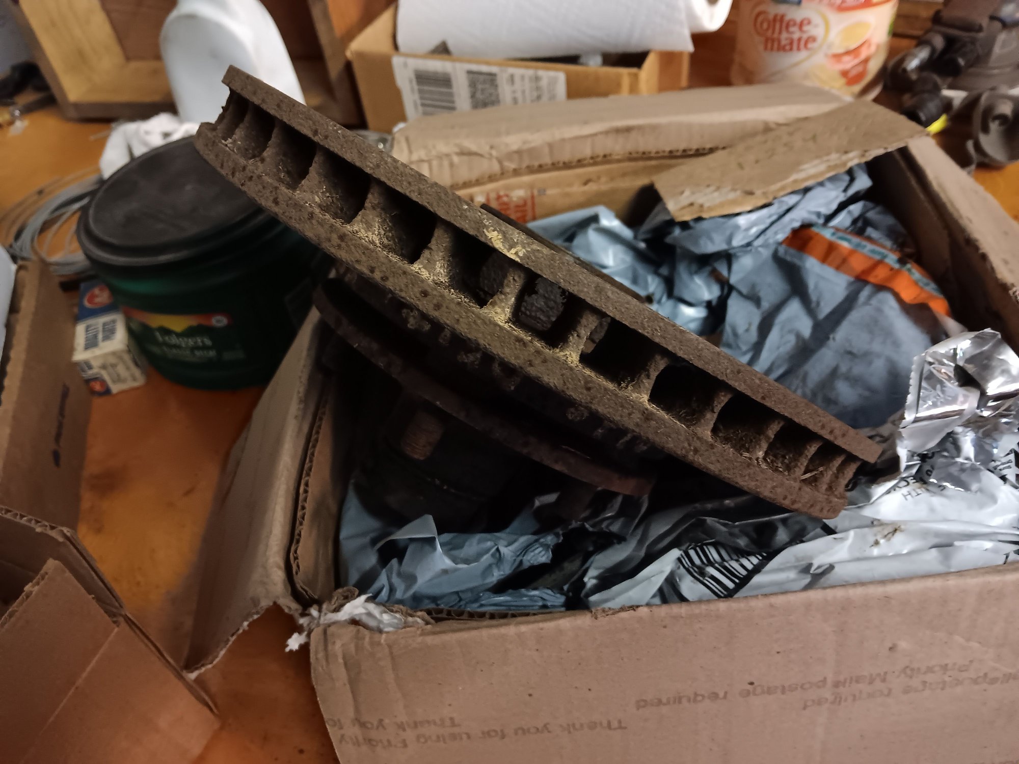

I got some used 1970 Delta 88 rotors.
They look like they might be OK with just a light cut . Pads didn't have much wear
looked for a min dimension stamp on them, but can't find it. Internet is no help either. This rotor measured 1.254 inches.

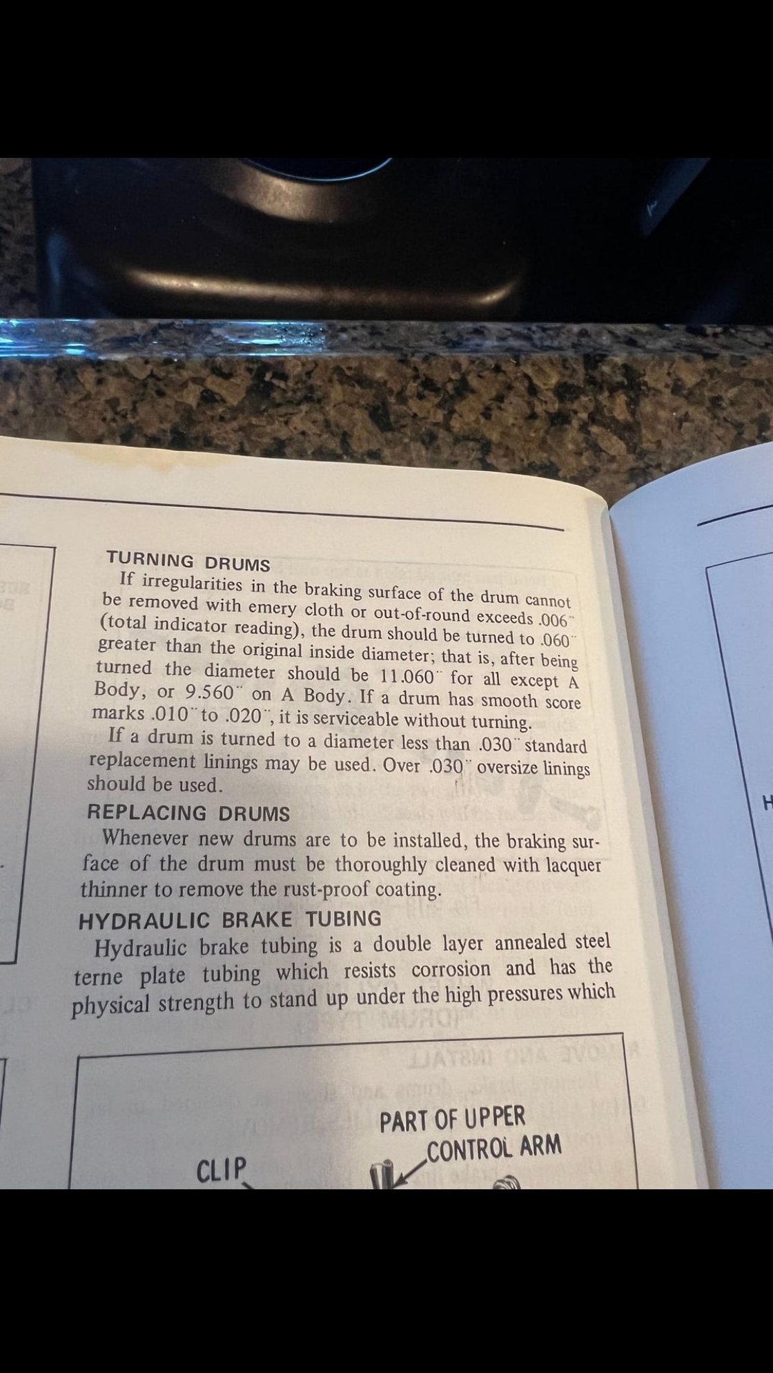

From the 70 Service Manual.

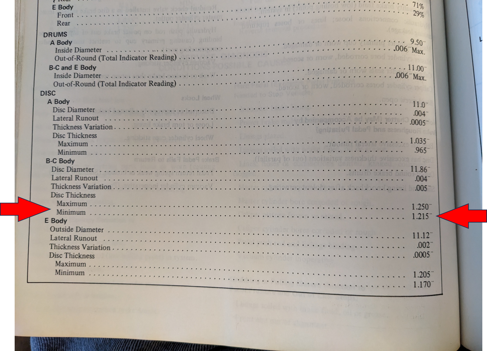

The OEM rotors should have the min thickness number cast into them. In any case, Page 5-52 of the 1970 Chassis Service Manual.

Thanks Joe!
Looks like I'm OK for several more light cuts on tis one.

Sorry for posting the wrong information, Ive been slightly exhausted and still paying respects to a good “Olds” friend of mine!😁. Glad that Joe was able to get you on the right track!
