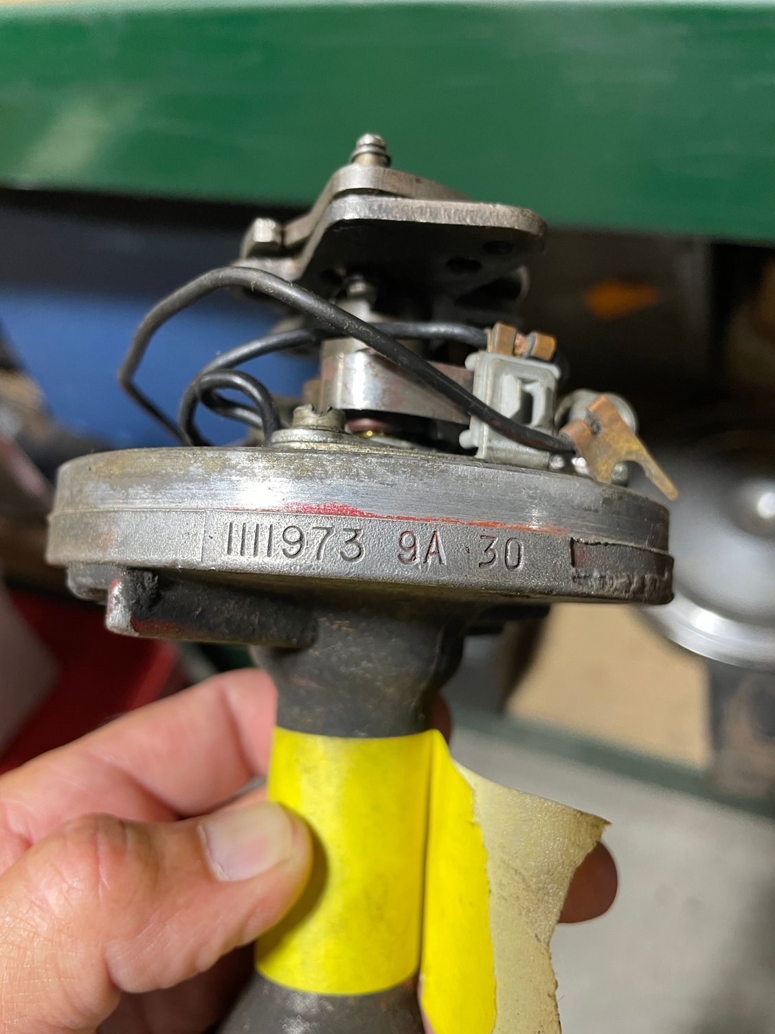

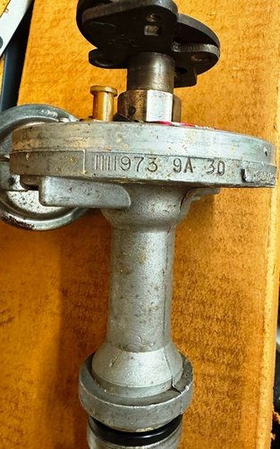

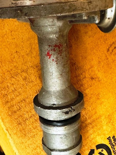

Parts of the collection from my dad in some of the boxes I’m going through. Don’t know the history behind it but it looks never used or an early take off. My dad owned three huge junkyards, a radiator and auto electric shop and he loved 69 and 70 Oldsmobiles. I can’t say for certain this isn’t a restamp but my dad wasn’t that kind of guy. Can anyone tell me the value???? I know this is not a give away distributor for someone who owns a Hurst Olds….thanks for any input. Open to reasonable offers. Dave

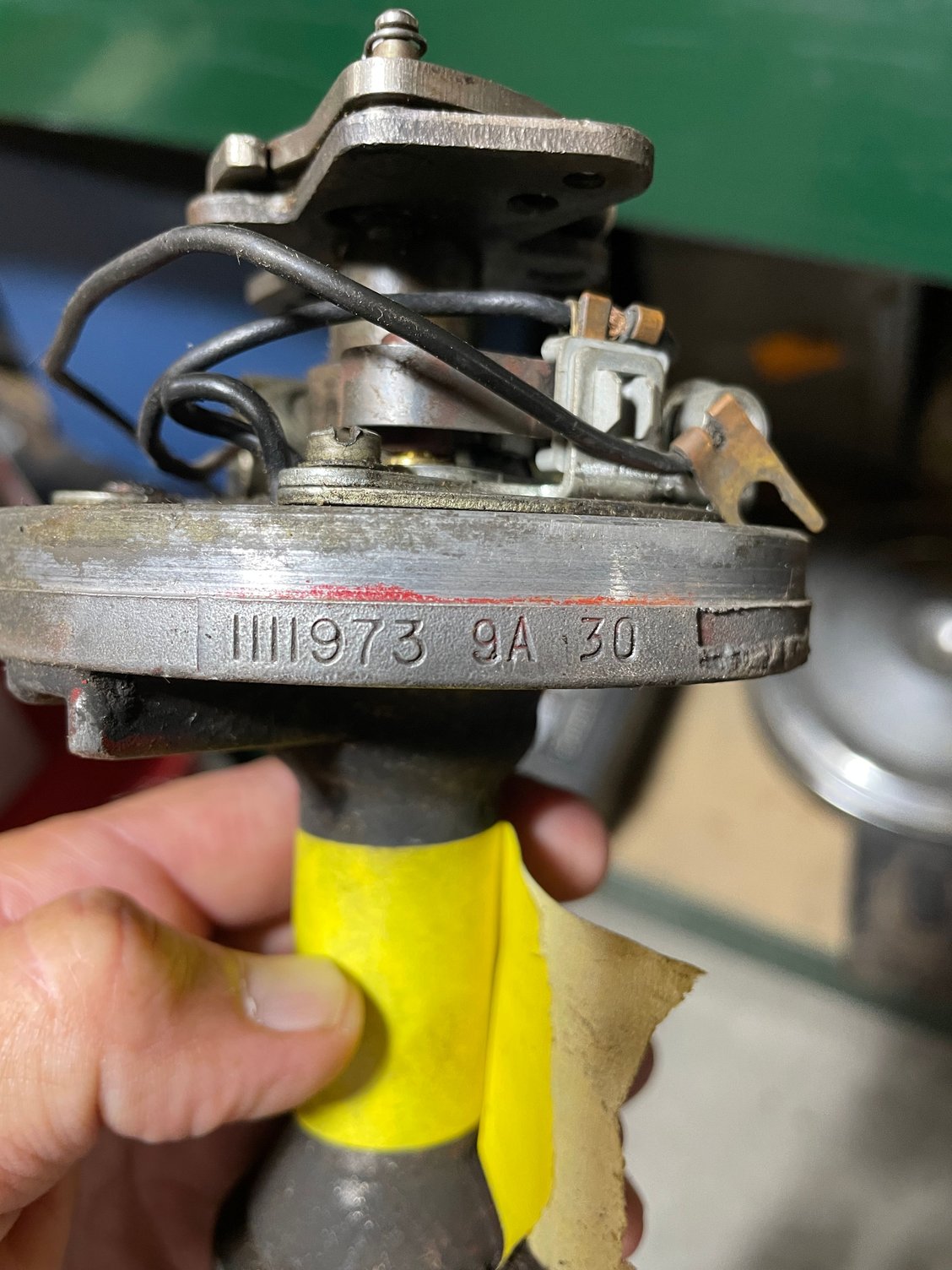

I really hate to say it, so I won't. But what bothers me about it is two things:
1) NORMALLY, the alignment of all the part numbers are in a straight line. The 73 by itself looks a bit high and stretched out. Date stamps are different than part number stamps.
2) Many many moons ago, there was a rash of "fake" hi-performance Olds distributors being sold on ebay and the like that were restamps, the 973 especially. They were pretty good fakes too as far as the stamps, but they could be debunked on closer inspection. I would venture to guess your dad didn't do it, but if one of the "fakes" came into his possession...just sayin'.
Wait, ok, make that 4 things:
3) The first 9 looks weird. So does the 3. Doesn't appear to be the same "font" as original. Also, the 3 does not seem to be stamped cleanly. Looks a bit deeper on the bottom side than the top. The date stamps were different fonts on the production units and seemed that they were stamped differently than the part numbers, but in all the examples I recall seeing, the part numbers themselves weren't haphazardly applied.
4) Hard to tell from only 2 pictures, but generally, on a stock distributor, there's more of a ledge above the numbers where the cap fits down. This APPEARS to have a smaller diameter base where the numbers are stamped. Again, hard to tell without closer inspection. Pretty easy to do, I guess. Chuck it in a lathe, take off a few thou, then boom, clean spots to restamp the numbers you want it to be. Not saying this is the case, it just appears suspect to me. Just something about it doesn't look right.
Not going to say it's fake, but I'm not going to give it a clean bill of health, either.
But for the sake of discussion, let's just assume it is a genuine article for a second...
Got a picture from the top?
The 973 also shares the same counter-weights as the Corvette HiPo 327 and certain carbed 427s and 70 Buick performance 455. They're noticably huge. Standard weights aren't correct.
It's possible the April 4, 69 date is correct, but most I've seen are late January manufacture dates. 9A30 comes to mind, but my memory isn't what it used to be. This is the first April date one I believe I've ever seen. Someone with a later-build 69 may know for sure. This one got manufactured a couple weeks after the start of H/O production, so while possible, I find it kind of odd as well. Come to think of it, I don't even remember the date of mine. Additionally, yours doesn't have any red overspray on it. Most originals I've seen had that. Anyone could have cleaned it up though. If it is indeed a correct, NOS one, Katy bar the door on the price tag. To me, just from these two pictures, it still looks used, and very possibly an early take-off at best. It'd be hard to determine without further inspection.
As a points distributor, about the only people that might be interested in paying the price is a 69 H/O owner that wants to restore their car exact. Which means big $$. All I can say is it's a hen's tooth. It was so scarce even when originally produced that they quickly superseded the distributor number for service replacement to the W-32 distributor, 1111989, which I find even rarer than the 973, but also less desirable. I used to have a 989 too and there are differences. At least the weights are "normal sized" on the 989 for sure. I did notice that. Can't recall which vacuum can it used. I've seen someone mention that the 989 is the same as a 1970 979, but I'm not thinking it is. Both are OAI hi-performance distributors, but I think the 979 would be better. JMO. Many many years ago I sold a spare intake and the 989 to Kurt Karch IIRC. I think I sold my spare heads to Jeff M. here on the forum. Again, that was like 20-something years ago or so.
If it's not a restamp, and the vacuum can works, and all the correct, proper parts are there, I'd probably start off with around $5K. That's just my estimate. If it's a fake, I might give you $30 for it.

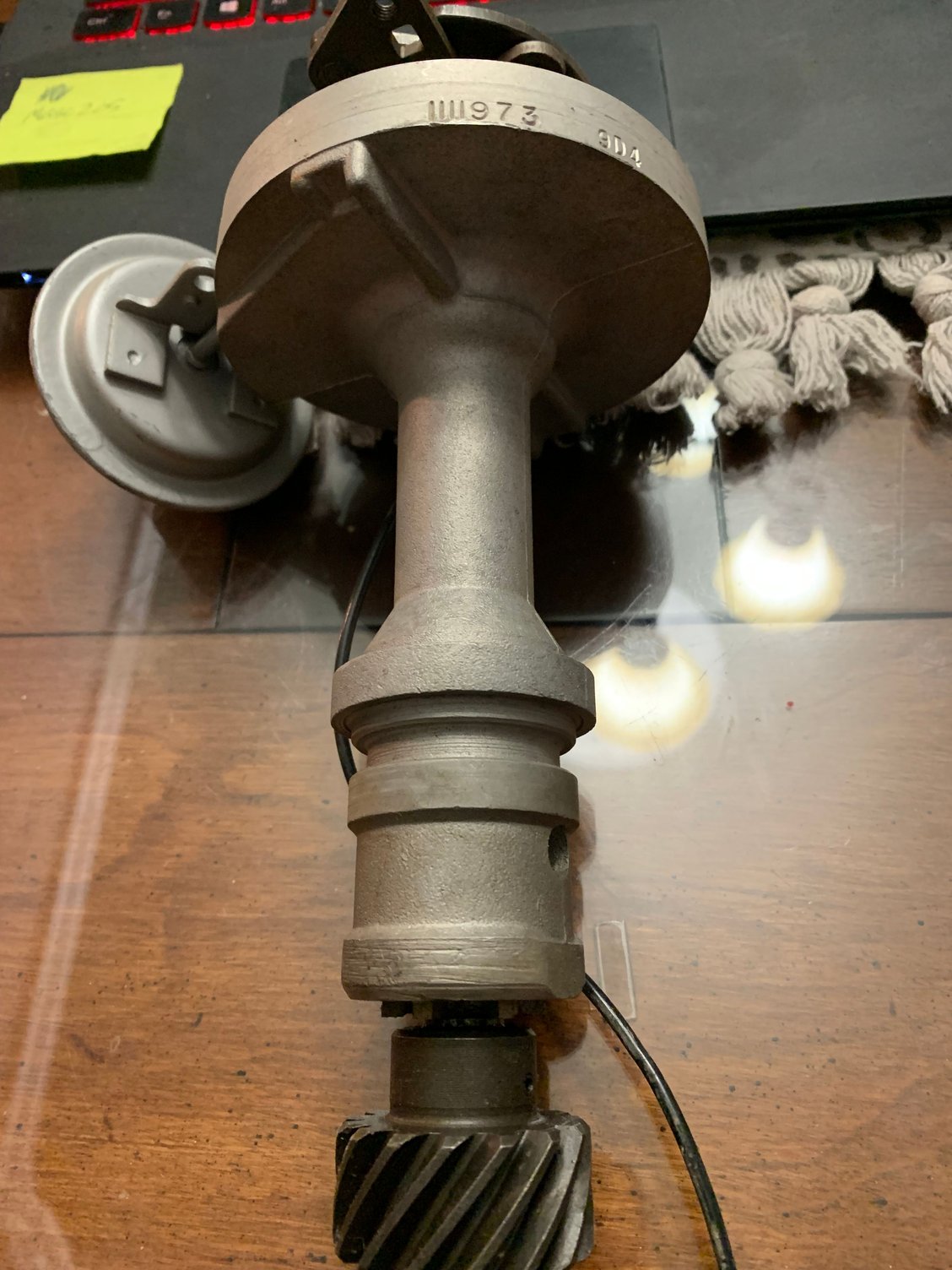

I'll try to find some pics of my genuine 973 distributor and post them up for a better comparison. Don't even see many pictures of real ones anymore.

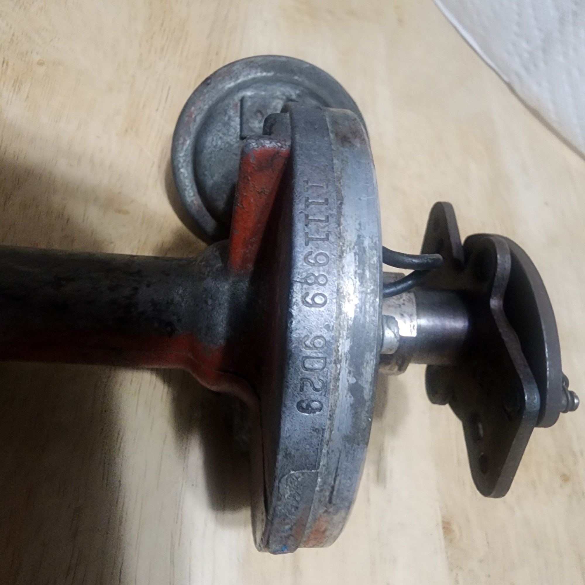

Here's a 989. Manufacture date of April 29, 69. Car was purportedly built in May. So a 4/4/69 973 is kinda suspect. But that doesn't really mean anything. Something odd about those "1" numbers being serif font, though. Honestly I can't recall what the numbers looked like on that 989 I used to have.
According to Hurst, their April 7, 69 dated tuneup letter and information still shows it should be a 973 installed in the H/Os. Of course paperwork trails are slow, so that may not mean anything either.

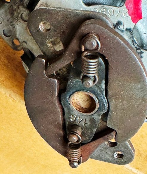

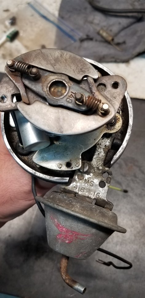

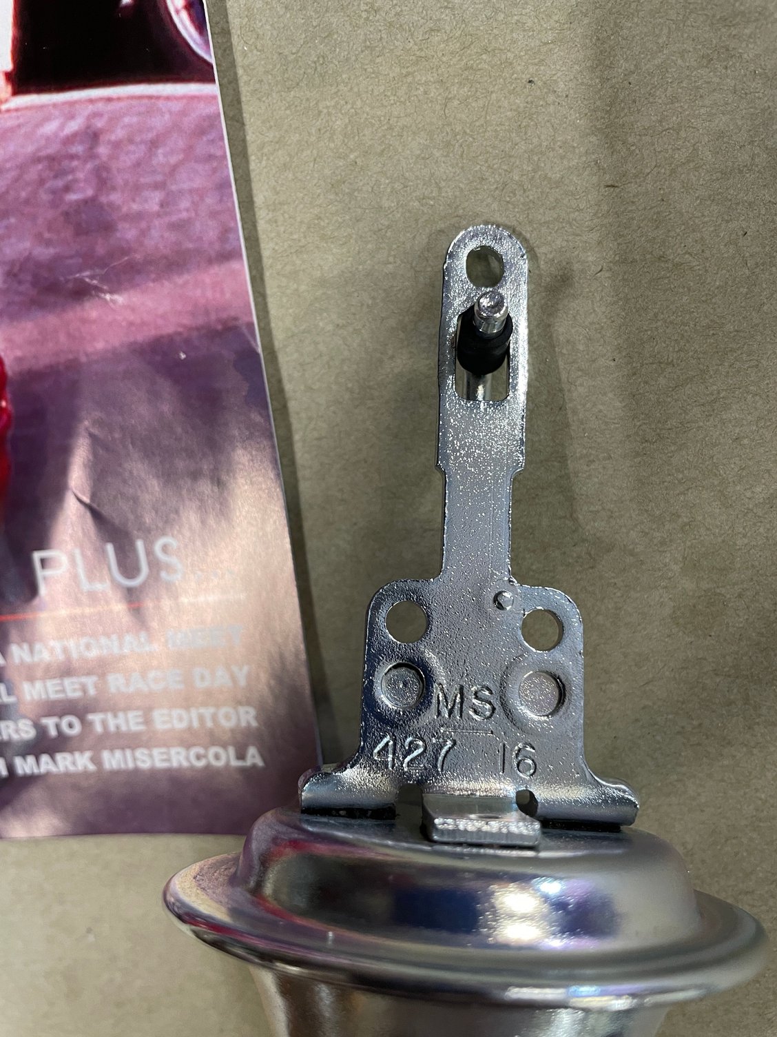

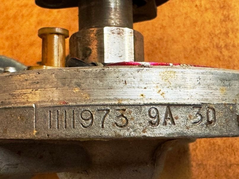

Here is my 973 distributor from my HO
GLWS
and the vac advance that was in it MS 427 16

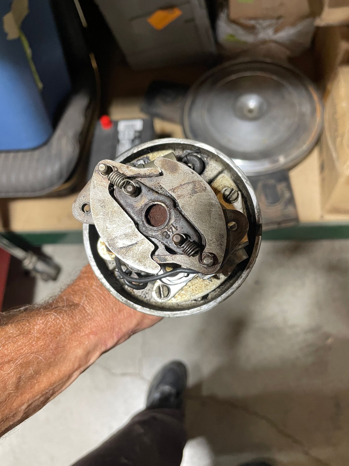

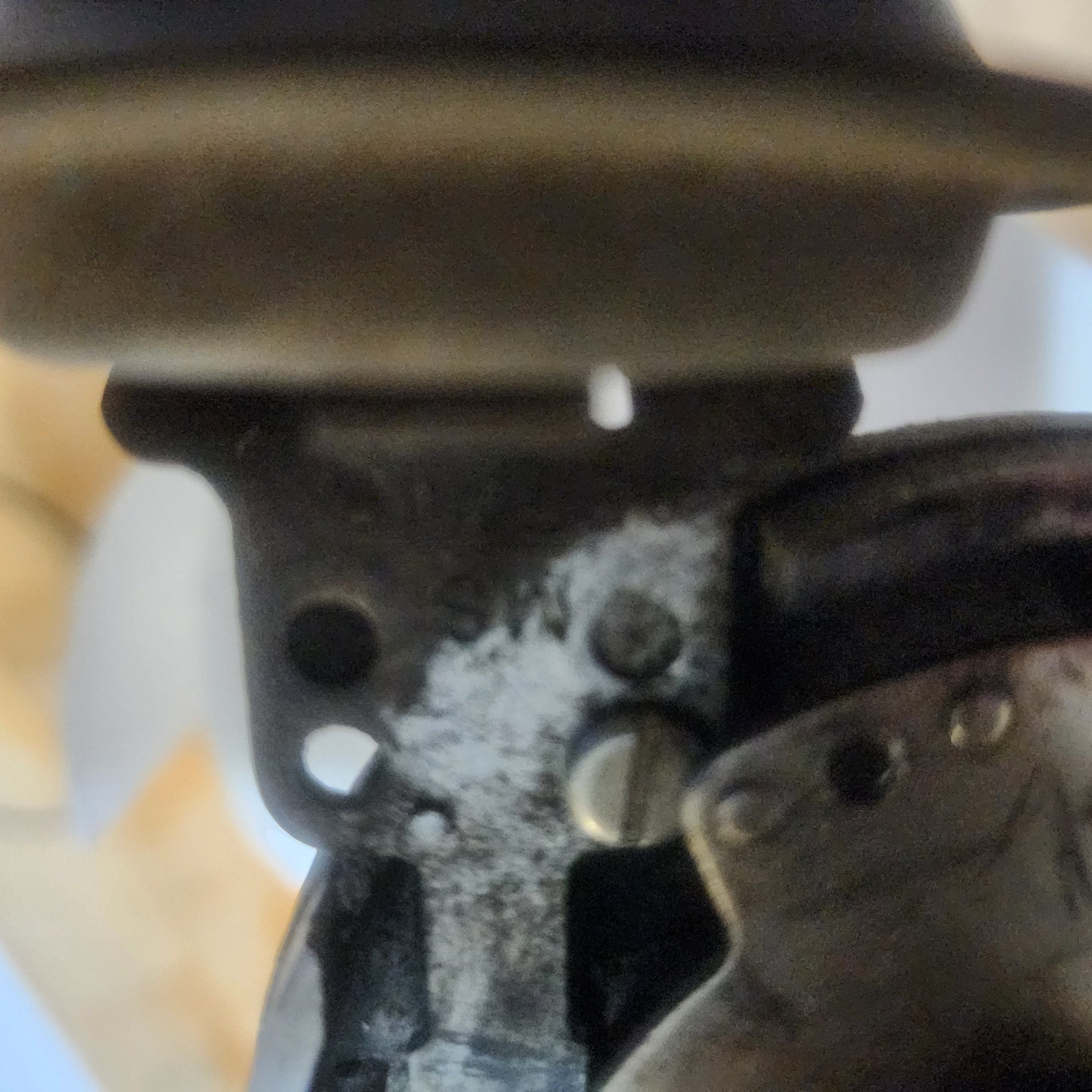

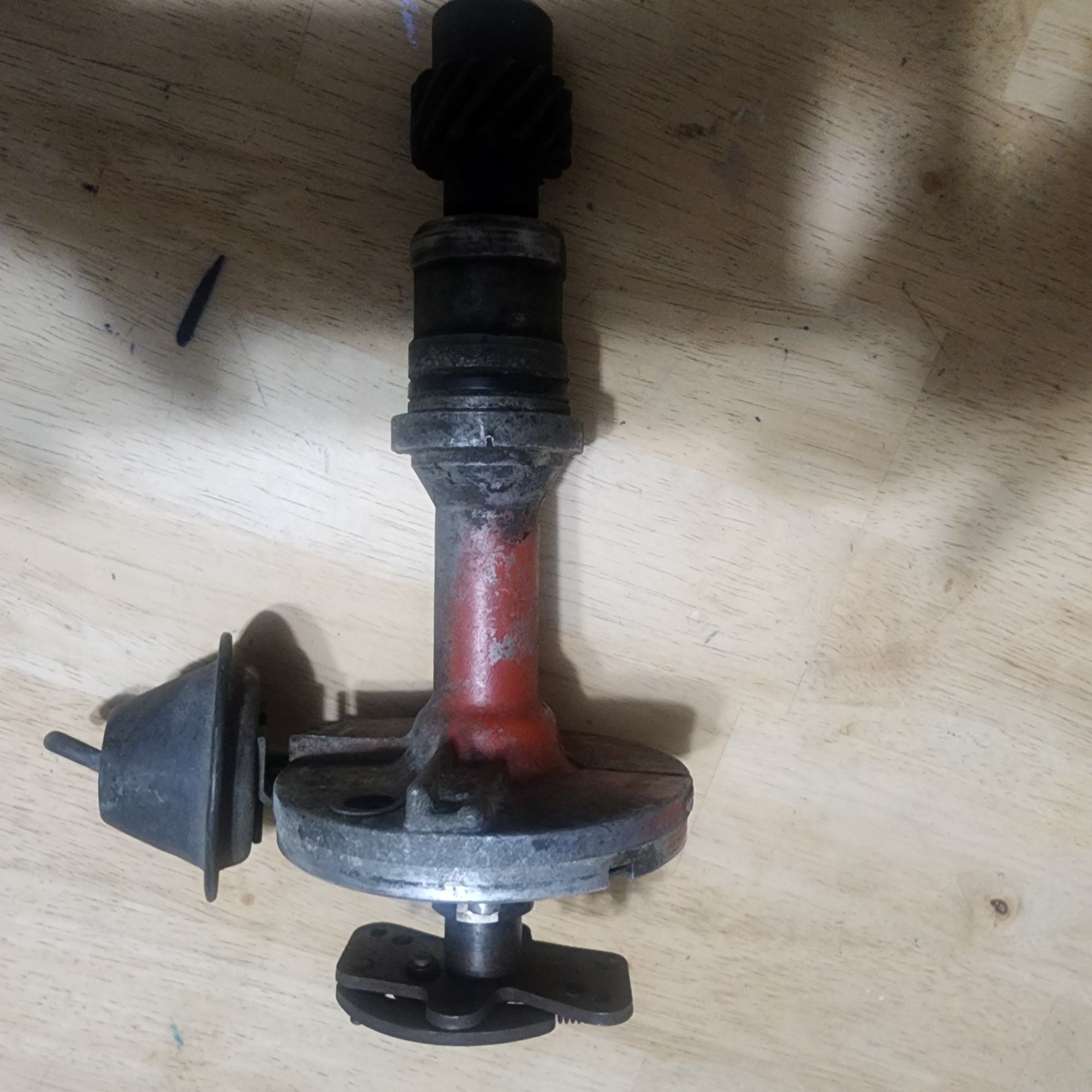

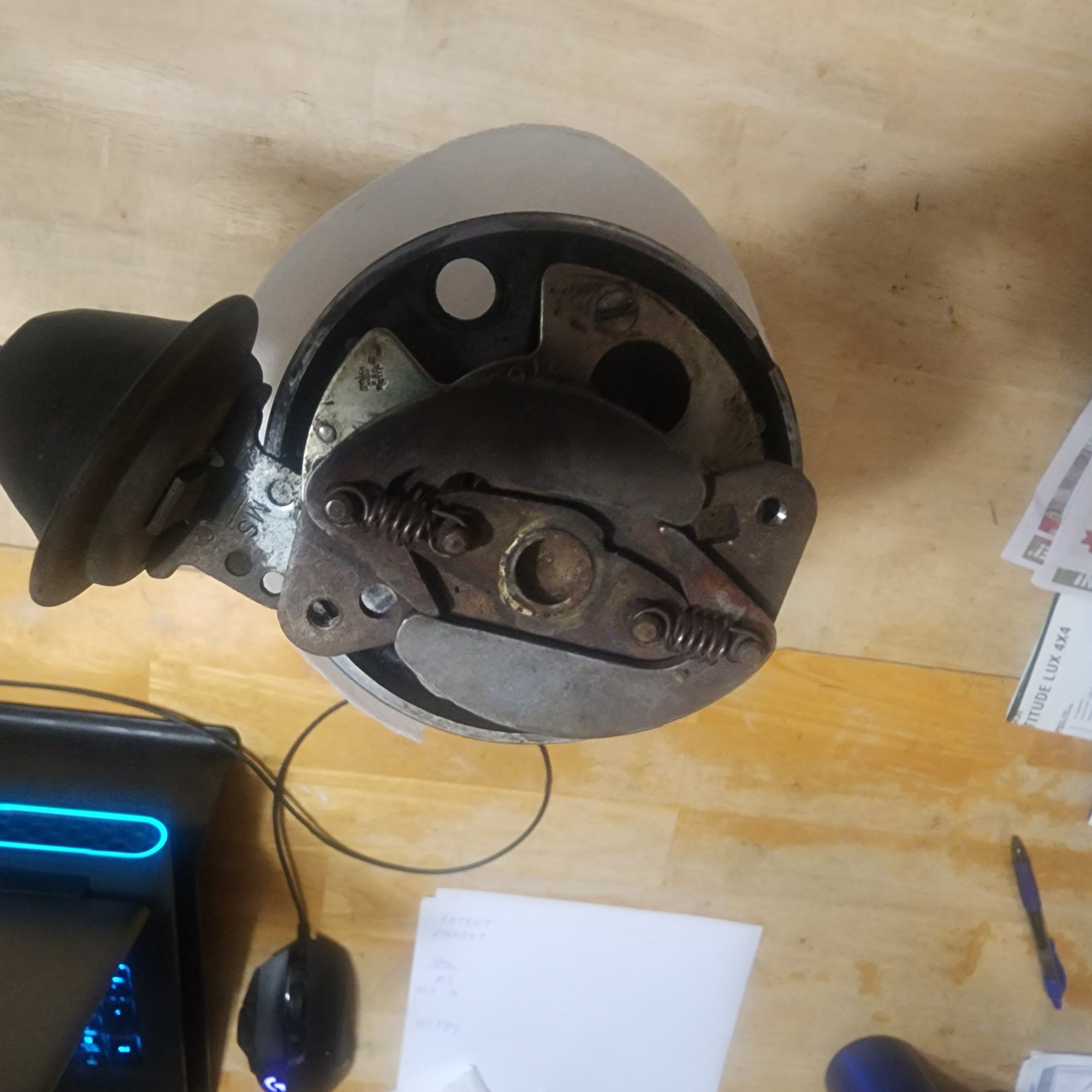

Thanks the input guys. Tim, do you happen to have a picture looking at the top down to the counter weights?
Not trying to pass this off as anything it’s not, just looking to verify so I can know whether to put it up for sale or not. Thanks

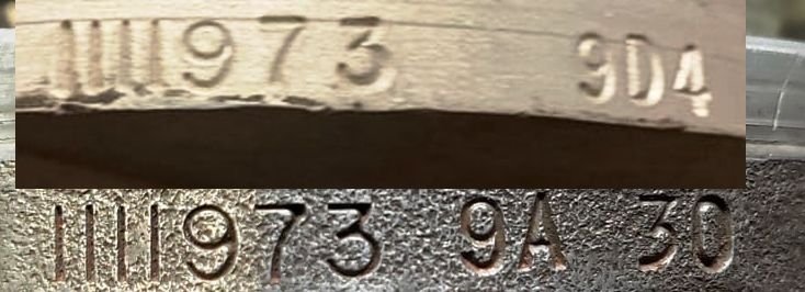

Sorry to say, but I can definitively state it is a re-stamp.
The other 973 distributor can show the differences.
The indents where the lines meet on the 9 7 3 are unique.
The distributor you have just does not have them among several other things incorrect.

Hi Dave,
Here is the pic you requested. Lmk if you need anything else.
I have had this since I bought the car in boxes in 1997, so it is in original condition as far as I know.

Great pics. Ironically, my distributor has the same manufacture date. Jan 30, 1969. Interestingly, the Hurst tune up specs show the vacuum advance can p/n as 1973418, but AFAIK, the cars should have came with the 427 cans on the 973s. Don't know wtf that was all about.
Note the date stamp font is different than the part number stampings. Also the date stamp floats a bit, not in a real straight line like the part number.
Red overspray engine paint

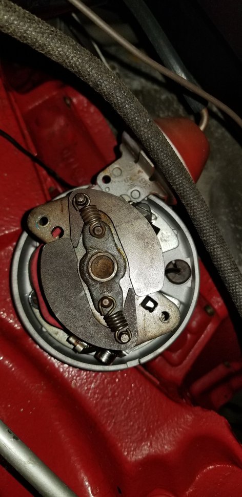

Here is the top view showing the weights on a 69 933 dist

I think he means where the corners of the top lines 7 and 3 meet with the vertical section. There's like an extra wide cut right in the corner. Plus, the 3 on the "real" distributors has the middle leg pointing somewhat downward at the tip, and as that top, nearly-vertical section is bowed a little bit instead of a straight line. The OP's distributor numbers are missing that. Here's a cut and paste comparison. Kind of obvious when looking at them next to each other. Real H/O distributor stampings on the bottom. OP's distributor stamp on top.
It is hard to discern the "several other things incorrect" as there's only 2 pictures. What vac canister does it have? The huge counter-weight setup? The 148 stamped on top of the main shaft? We haven't seen that yet.

973 distributor and the H/O is still installed. I'll get it out, next day or two and get pic #s
Old Jul 29, 2024 | 11:57 PM
Lone Star Motorsports's Avatar
Joined: Nov 2021
Posts: 19
Thank you for the pictures! That helps a bunch.
Your pics confirm that the BaT distributor is most definitely a restamp and also confirms that there are at least two batches of 973 distributors.
I wonder if any other batches exist?

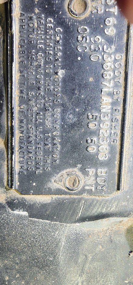

One of my 1969 H/Os vin# 392757 has the 1111989 Distributor with date codes: Car 05C data tag and Distibutor 9D29. Pictures if needed. It is original and still has red paint on it. It does not have the odd weights or the ms427 vacuum advance. Car is not in Demmer list but very well documented including window sticker. Information for determining date of switch from 1111973 distributor. Hope this helps.
Old Dec 16, 2024 | 08:08 PM
Joined: Nov 2021
Posts: 19
I also own a well documented '69 H/O which falls into the range of cars for which Demmer documentation has not yet been found.
According to my calculations your car would likely be approximately vehicle number 792 if the missing documentation is ever found.
It would be helpful to add photos of your distributor to help document the switch from 973 to 989 distributors.

Pictures of my original 1111989 H/O distributor
MS  427  16
MS 427 16
Data plate of H/O
Data plate of H/O
Last edited by MGBill; Oct 16, 2025 at 04:09 PM. Reason: Add data plate with build date

MS  427  16
MS 427 16
Data plate of H/O
Data plate of H/O
Awesome information. Would you happen to know what number your car is from the H/O registry?

My car is not in Demmer Registry but is estimated to be around car 792 Demmer if ever found. I purchased the car in 1974 from brothers who bought it new. Have all documentation on car including 318 dash plaque, warranty registration from selling dealer, proteco plate, hurst purchase option, and even the Original Window sticker. Took car apart in 1980s to restore and never got time to do the job. Thinking about selling car and all rare parts, (Missing original trans) Data Tag: 05C May 3rd week.
