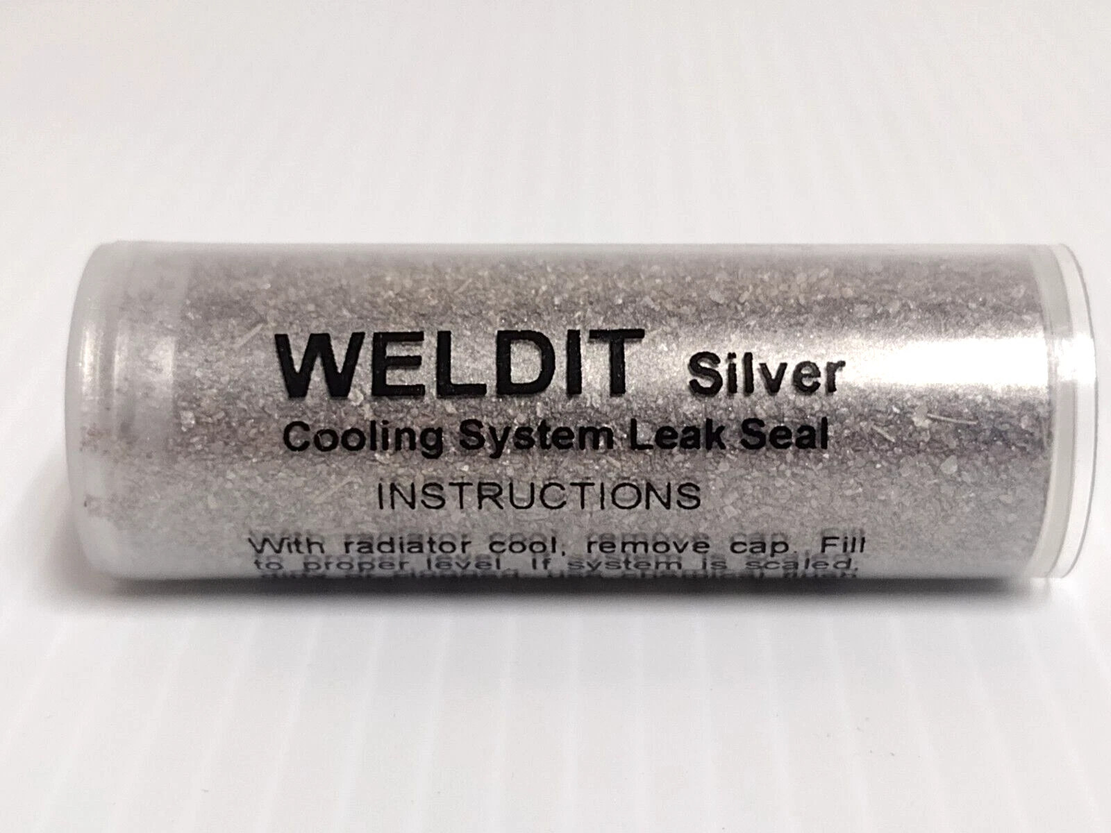

If you are set on trying something before replacing the housing, get a tube of solder seal
JB weld will not work on a crack like you have. The coolant will push out under it. Solder seal will most likely not work either, but it is worth a shot if you are looking for something to try before pulling the housing. I have used the sealer above on many cars over the years for various types of coolant leaks. I do not trust the headgasket-goop repair stuff in a car I care about.

Thanks, motorhead - may take you up on that, and appreciate the heads up loaded on the solder seal.

PM me your mailing address and I will send one you can try.. If you use it pay me a few buck$ in the future OR pay it forward somwhere else

Thank you, PM sent
