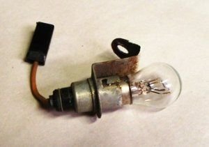

This is a typical 1970s GM trunk lamp and bracket. Mercury pill switch is in the bulb holder.
If you look close you'll see someone has installed an incorrect dual-filament bulb 🙄 , hopefully just for illustration purposes. But it makes you wonder if some of these people can change a light bulb in their own home.
