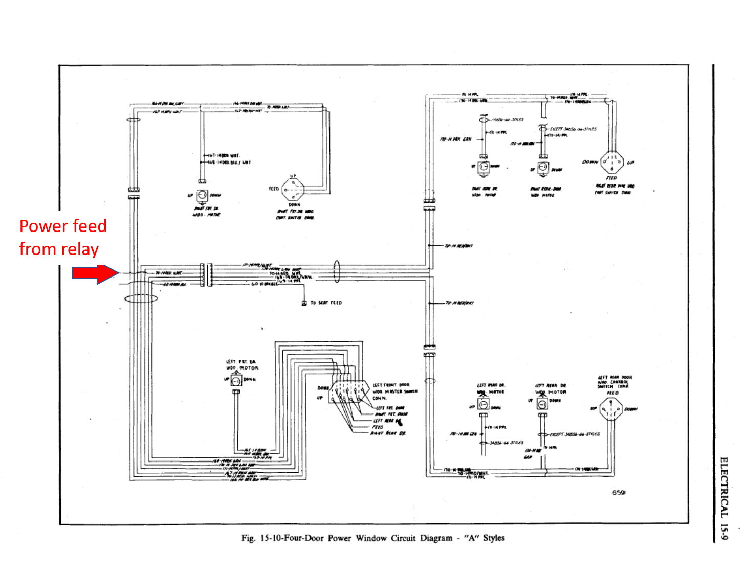

This is from the 1971 Fisher Body Manual, but 70 is the same. It sounds like either the master switch is bad or the crossover harness is bad.

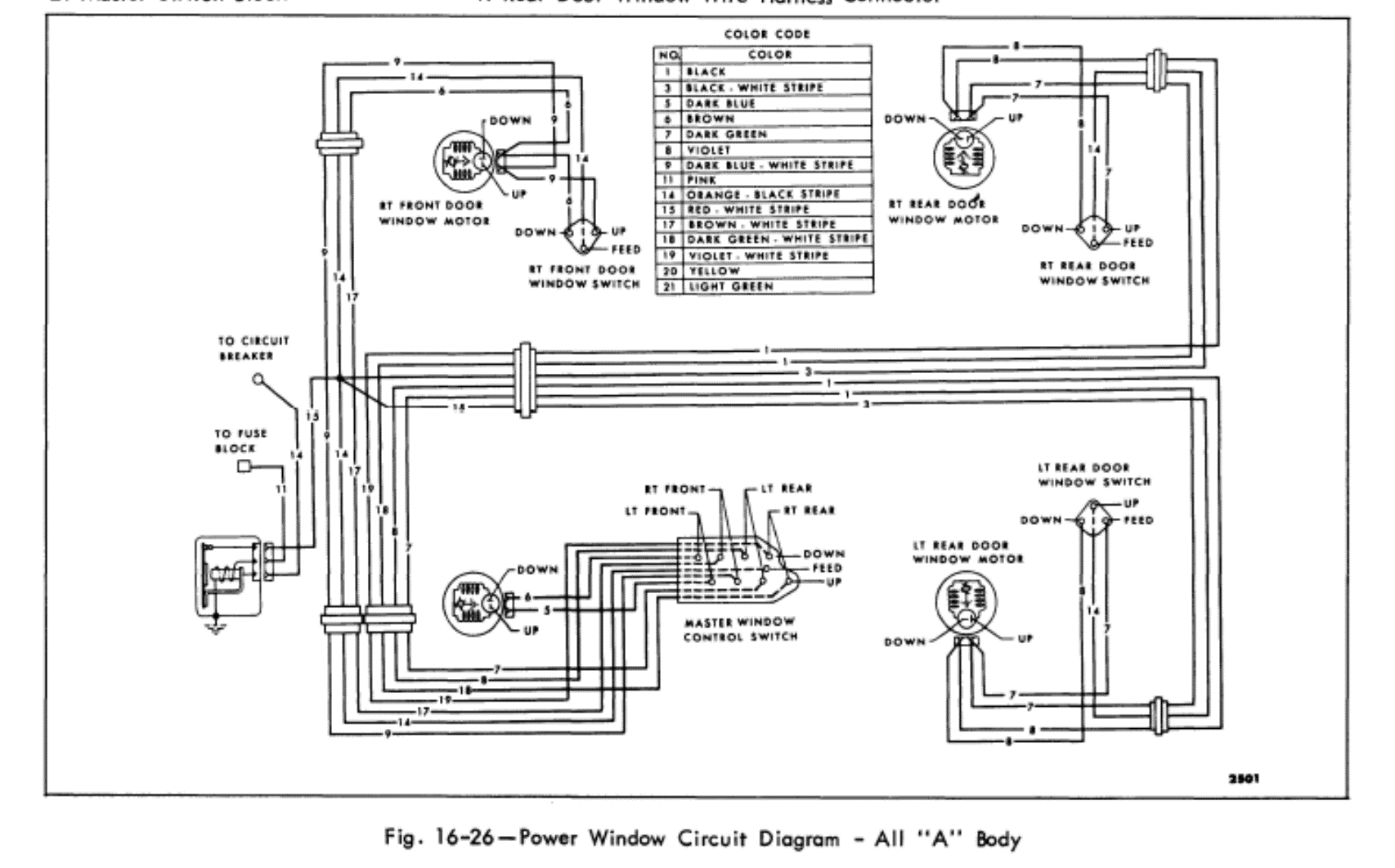

Here's the diagram from 1967. Same basic wiring, but easier to read.
