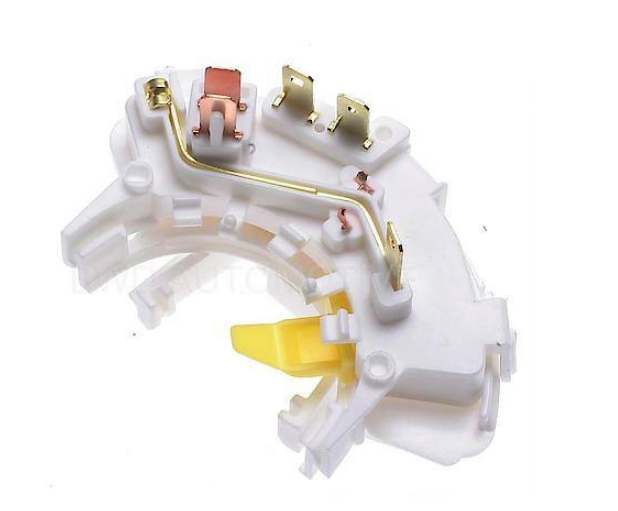

Seeking some assistance regarding the 'back-up' lights not working properly. Replaced both bulbs but reverse lights flicker on and off when moving the column shift from 'P' to 'R'. I would believe that this is a 'Neutral Safety' switch causing the problem. Is there any other part that may affect the 'reverse lights' not working properly? Any and all replies are most appreciated. Is the 'back-up' switch incorporated in the Neutral Safety Switch on the below vehicle?
1986 Oldsmobile Cutlass Supreme Brougham
5.0 Liter (307 C.I.) Vin Y
* Have not placed the car on the lift but I'm almost certain the Neutral Safety Switch is located on the transmission.
* Is this the part?

I'm not familiar with your vintage of Olds, but that does look like the neutral safety switch and its located inside the car, on top of the steering column near the floorboard. It can be adjusted so I agree with you this might be worth checking to resolve your backup light issues. John

* I believed the NSS to be on the transmission or am I wrong? Thanks.
* @2blu442 > You are certainly correct, my apologies.

Its on the column.

No, the mechanism for the NSS is in the column not the linkage. There are 2 small screws that hold the switch to the column with adjustment for the switch.

As Eric stated in his post, the NSS for your Cutlass is on the steering column and is controlled by rotation of the column... The only other thing that may cause your problem is item #13 of your posted illustration... This rod adjusts the trans linkage to the shift indicator and may be slightly out of adjustment... Adjusting either the NSS or the linkage rod, if misaligned, should resolve your issue... If, however, all the shift indicators are in the correct position, it is doubtful the rod is the problem...
Thanks very much. Can the screws be adjusted to compensate for any play or exactly how should the screws be aligned : in Park or Reverse?

The screws are in fixed locations, there are slots in the switch to adjust it. Not that complicated once you look at it. It can't be that far off if the engine starts in both park and neutral.
Thanks much, most appreciated. Can you provide some insight on how to adjust the NSS?

I just popped the cover. Here are some photos, difficult to get under there. Is the white piece around the column the NSS? How can I adjust that?

The NSS clicks right and left. Turned inadvertently to the right. How can I adjust? The NSS ratchets to the right or left in audible clicks.

* I just fixed the backup lights. Upon ratcheting the NSS to the low position as stated in the Oldsmobile manual: 'The backup lights did not work'; rather going on and off between P and R. Upon moving the NSS to the 'high' position (Left); the backup lights now work. I cannot understand how the Oldsmobile manual states to move in the 'low' position rather than 'high'. I believe this was contingent upon installing a new NSS but the wording was somewhat confusing, at least to me. Maybe, someone can chime in here with an analysis. Thanks very much for the help. Glad I had the Oldsmobile manual. Picture of page inserted denoting the NSS and as to the position. The setting position was believed to be P which I adjusted in.

I don't know your vintage but here's some pictures of a 1972 column switch. It has two fasteners that you'd loosen and then rotate the switch. You might get a mirror and flashlight to look up and see what kind of fasteners hold your switch in place.

Thanks very much for your assistance. The problem is rectified. I wished someone would have told me about the "high" and "low" position in ratcheting audible clicks. How did this occur, moving out of place? The audible clicks are very secure and not at all easily moved. Any reason to believe "sabotage"?
