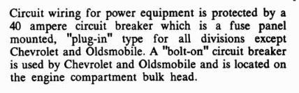

The service manual says the following:
There are body wiring diagrams in the manual for selected makes and styles, and the closest to your car is this one, which is for Oldsmobile B37 style. B37 was a Delta 88 2-door hardtop. I'm guessing that wiring was similar if not identical between Delta 88 and 98. Look at item #11, which is the only thing that mentions circuit breaker. It's likely located on the firewall in the area near the brake booster.

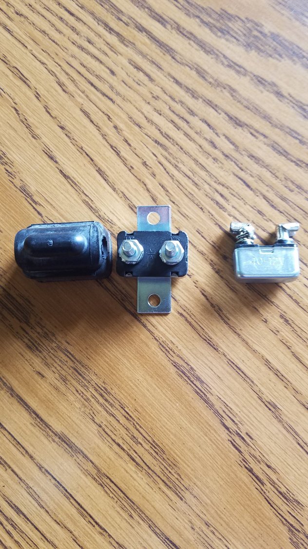

The breaker on the left is what you would find on the firewall (rubber boot should be covering it) on the right is what would be found on the fuse block. Since these are breakers and not fuses, they are less likely to go bad....I would look at wiring. Especially the drivers door wiring, looking at places where the insulation is cracked or shorting against the car body, there can be a lot of movement in the door wires, causing insulation breaks.
