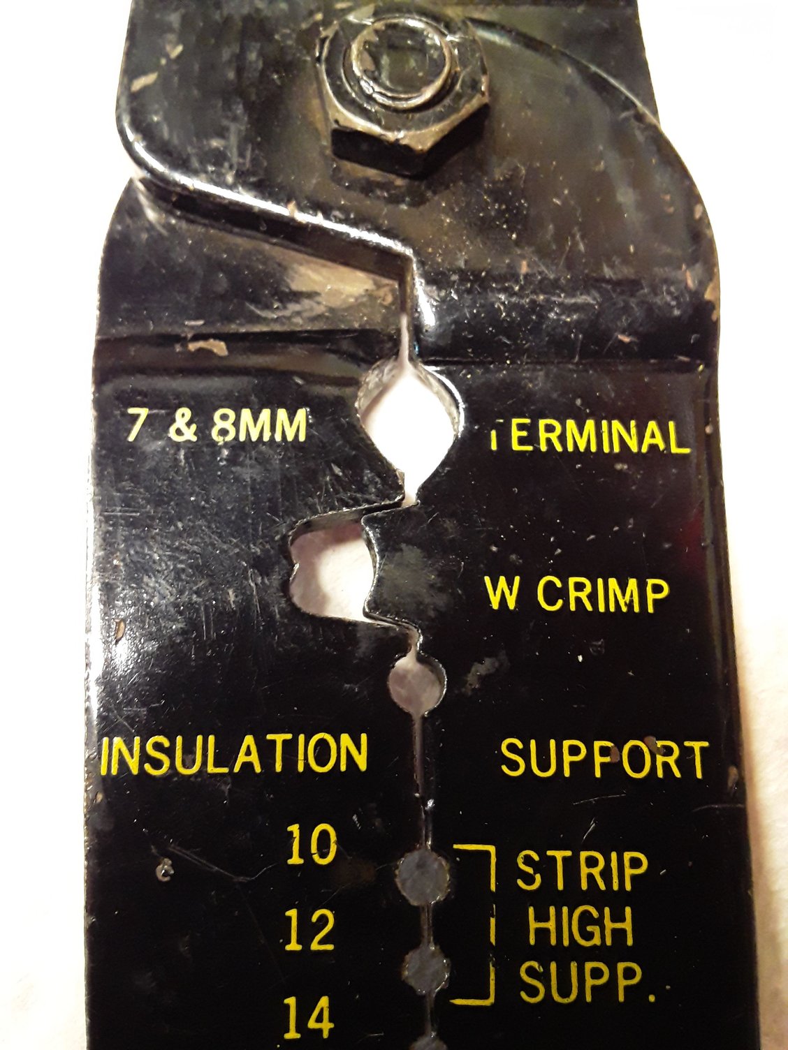

This ancient crimper will crimp a plug wire end properly.
Specifically this anvil marked W CRIMP:
I have Klein, G-B and NAPA Carlyle crimpers for most terminals but this thing does it on plug wires, so I keep it around.

The W crimp slot on the pliers RocketRaider posted are the same as the #2 slot on the ones I posted.
