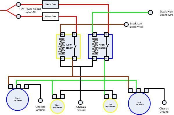

If you ran them off the headlight switch and not a relay on anything made before 2000 ish. they will flicker.
Most older vehicles, you use the headlight switch power as the relay feed/trigger. and power straight off the battery to relay.
This is a good Idea for any old vehicle that doesn't need to be 100% stock.
The voltage drop through the factory system wiring after 50 + years leave you with dimmer lights as most times you get 12 at the light with car running. with relay, you get 14.1+/-

Old Aug 8, 2025 | 05:20 AM
CutlassMarc's Avatar
Joined: May 2025
Posts: 236

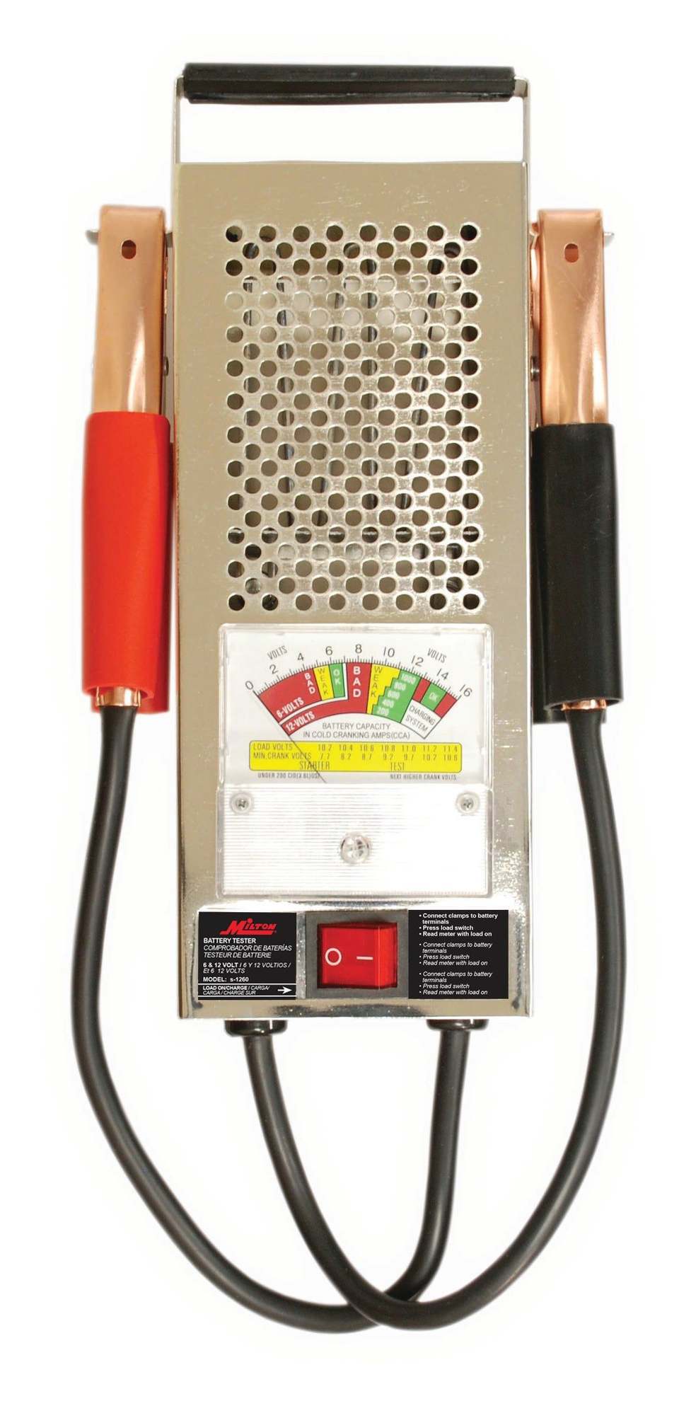

Okay, so given all the thoughts here I actually got the car in a spot where I could do some testing.
I *think* it is a bad battery- or a battery on its way out.
I never gave that a thought given it starts just fine, and the whole thing with headlight flicker while running, but not while just being on battery- threw me off.
Also my tell-tale sign of bad battery is if it doesn't make it through storing the car over winter (I detach the negative cable)- and this one started the car right up after winter.
I have a battery tester I tested with- which stated "charge and test again". Before I started the test, I noticed the battery was in the lower 12's for volts. When the car is running, the voltage at the battery is at the upper end of where things should be (14.6/14.7V). I guess makes some sense if the battery isn't holding a charge / is low and its trying to bring the battery up some.
From the above too, I guess it could make sense if the battery is not 'smoothing' the power out when alternator is running and if battery is not in good health? I noticed a 2019 sticker on the battery (I bought the car last year) so I'm not even going to bother charging up that, will buy a new one and see.
Old Aug 11, 2025 | 05:54 PM
Posts: 50,802
The battery will always be 12.5-ish volts. The alternator puts out at least 13.8. Do you have a battery load tester? Voltage is not what you need to be checking.
