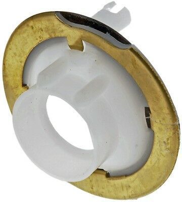

Had a similar problem on my '72 Supreme and after extensive troubleshooting, I figured out that the "insulator" ring was missing from the cancel cam and this caused a dead short to the brass ring in the cam. I would check that.
If you look closely, you can see a portion of the insulator ring I'm talking about.
