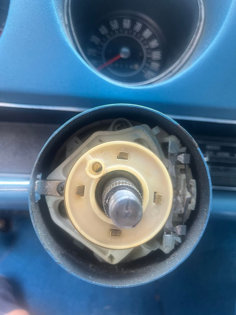

there's a fuse? I checked the box and the spec sheets and didn't see one for the horn. Looking online just now I also don't see one labeled horn for a 68. But here's another confusing element. Just about all the videos/pics I see of the column with the wheel removed show a black plate over the plastic horn cam. LIke this one:

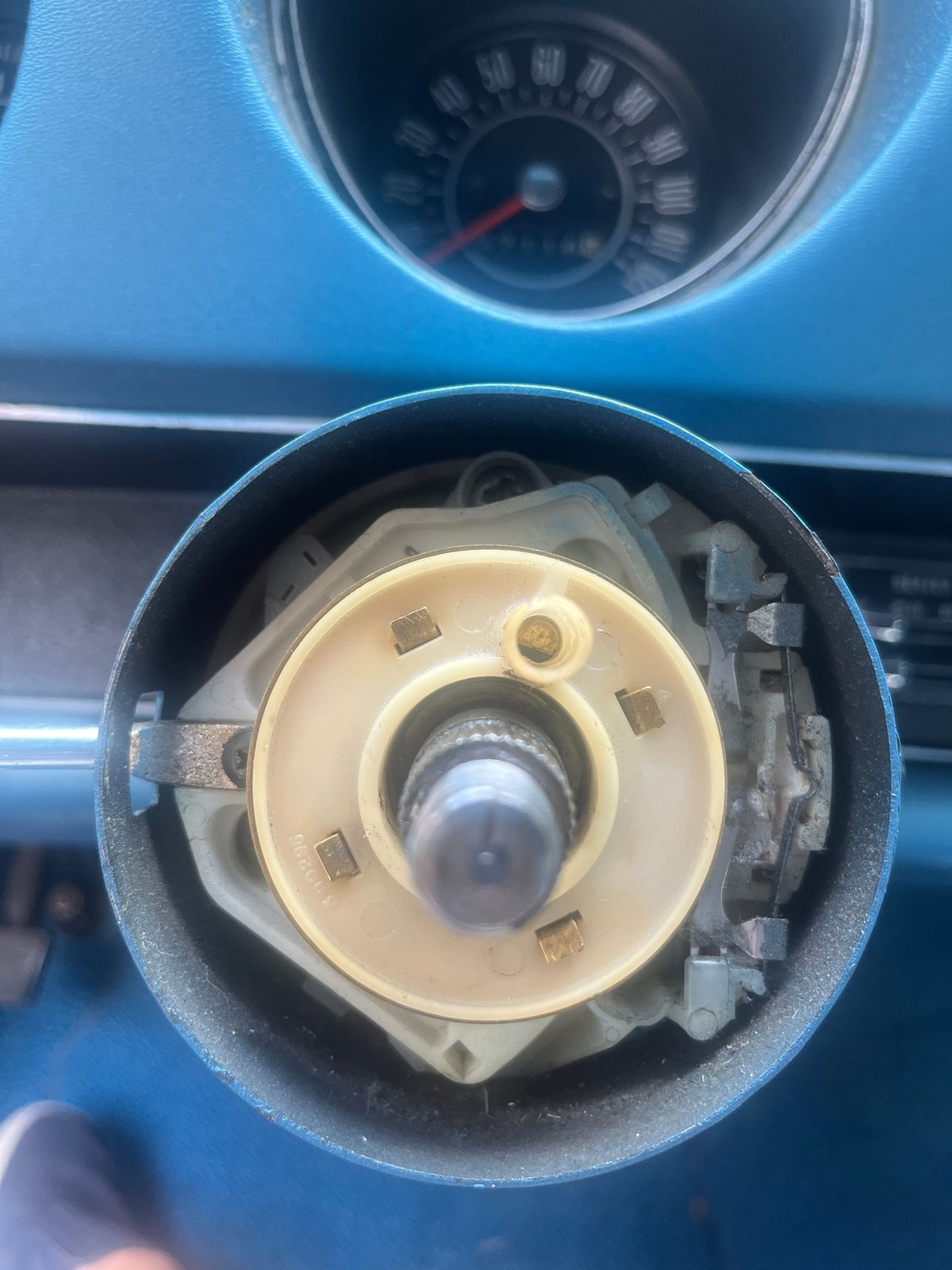

My 68 doesn't have that... And, all the instructions I see show the horn cam at the 10 o'clock position, but, without that black cover, mine cam can be placed anywhere on the shaft (as I think it should, so it has constant contact with the horn plunger). While, I don't think this is a major factor in the overall functionality of the horn, I am trying to get everything back to the factory-correct setup, and having the cam seated correctly seems like it might be important for one reason or another. Here are some pics.
PS — the pic where I am holding the cam: is that the correct placement for the tubular metal ring?

The black metal plate with the spokes on the outer edge are for locking the steering wheel. It looks like you have the correct placement of the parts although again I am not familiar with the metal plate in the last photo. The plastic ring with the copper ring attached is so that the wire from your horn button will always be in contact with the copper "button" inside the turn signal canceling cam/emergency flasher switch shown in the first photograph. Then when you depress the horn button on the steering wheel you are completing the circuit to ground and the horns will sound as they are in series with the button, ring, and finally the switch. In the last photo, I think the "top" side of the retainer spring should somehow be held down to keep pressure on the copper contact for the horn wire to the copper ring on the plastic ring, again the aftermarket metal plate is confusing me a bit.
