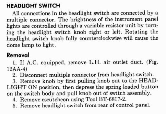

looking to replace the headlight switch on my 68 Cutlass, this does not look like its going to be an easy job...any suggestions ??
Old Apr 28, 2018 | 05:05 PM
jaunty75's Avatar
Posts: 15,176
From: southeastern Michigan
Yes, follow the directions in the chassis service manual. There are no shortcuts. The switch comes out from behind the dash, so you will have to reach up from underneath to get at it. The "spring-loaded button" mentioned is behind the dash.
From the '68 Chassis Service Manual for the A-body lines.

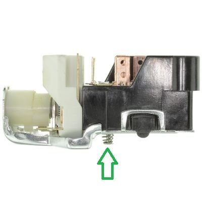

Location of the spring-loaded buttom (on the bottom of the switch).
