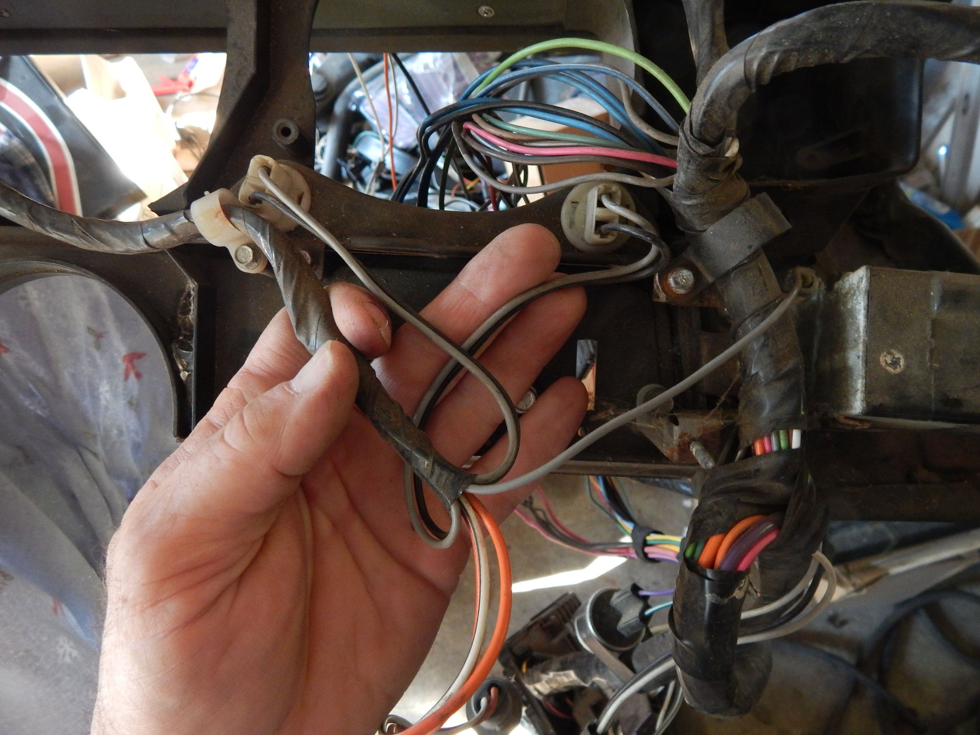

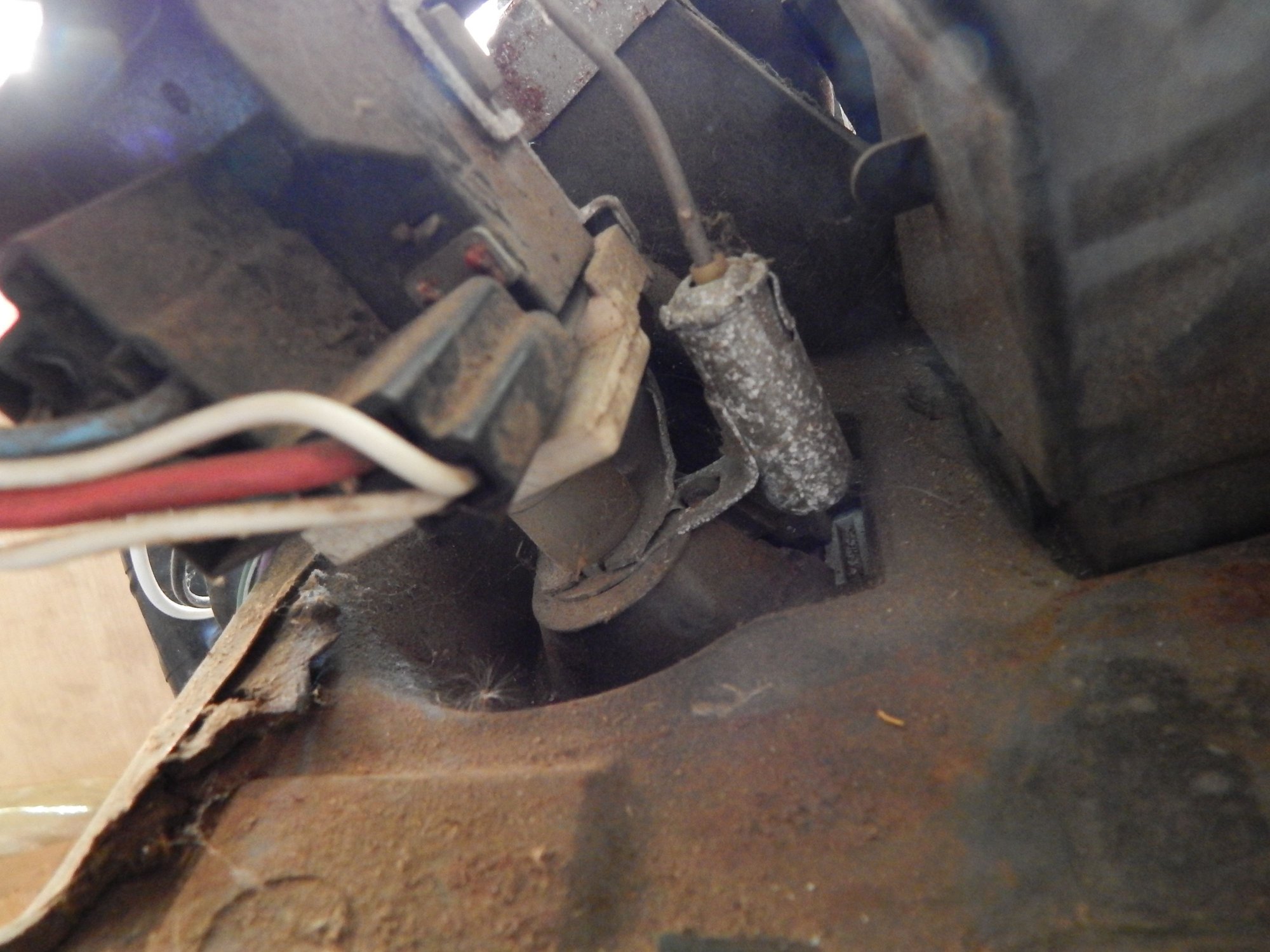

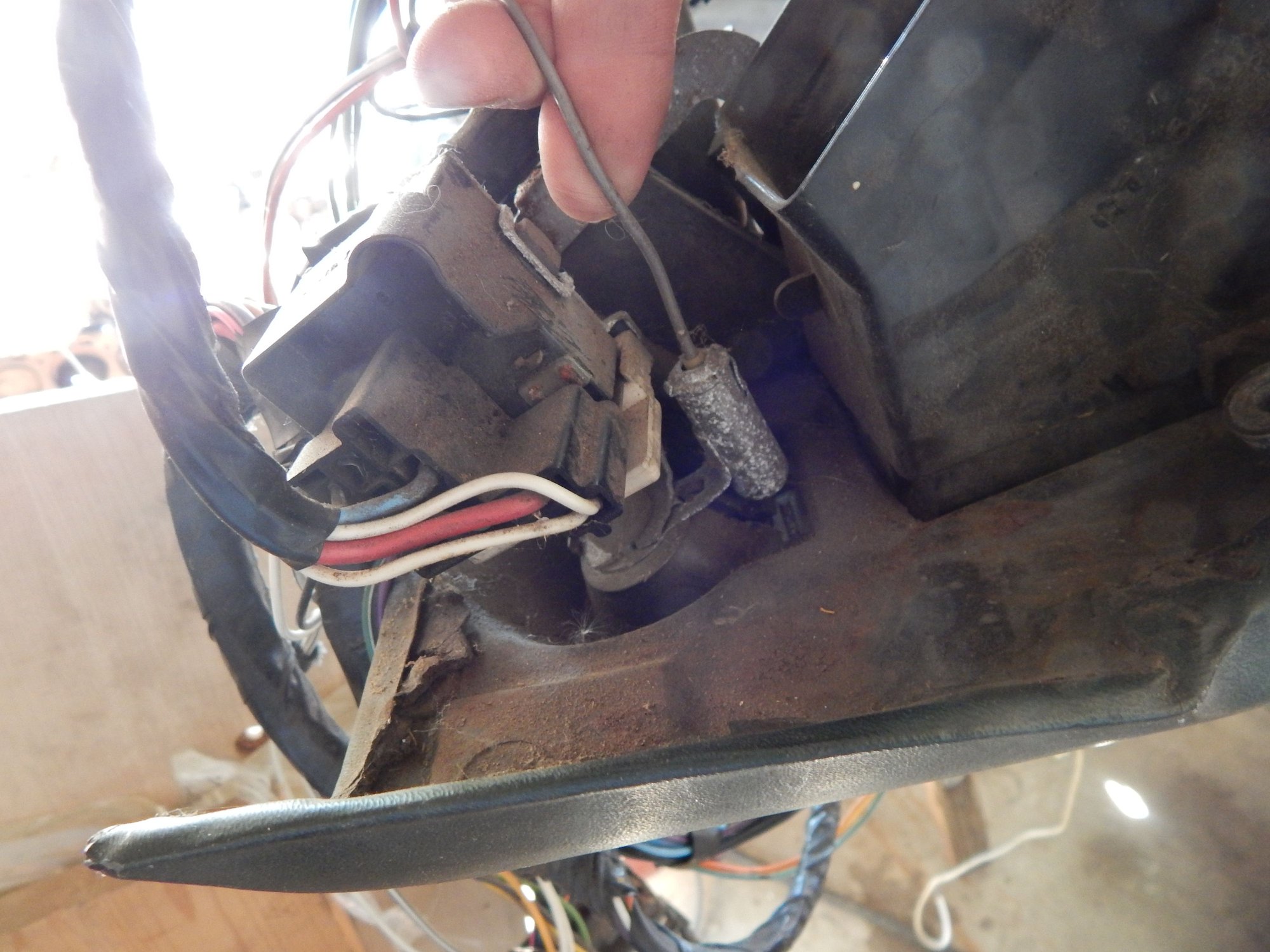

Here's some pictures from the backside of a dash with the wiring harness hooked up. There's a bullet shaped thing that has a bulb in it, and its got a grey wire running to a portion of the harness that has other lights coming out of it. Check out the photos and let me know if you have any questions.

John, As usual your response and pictures were spot on. You are a real asset to this forum. Thanks so much
Unfortunately, I have nothing in my harness that looks remotely like that. The only single, gray wire lead I find in that area ends in a plastic spade type housing. Not sure of my next steps but suspect it is going to be expensive. Thanks again,

Do you have the other lights, the ones over the wiper switch and under the idiot light pod?
Old Jul 6, 2017 | 06:30 AM
rand5204's Avatar
Joined: Mar 2012
Posts: 787
From: Merrill, WI
Yes, but I don't see them on my harness either
Old Jul 6, 2017 | 06:37 AM
2blu442's Avatar
Joined: Jun 2006
Posts: 510
Email sent. I'll see if I've got a good used harness to offer you.
