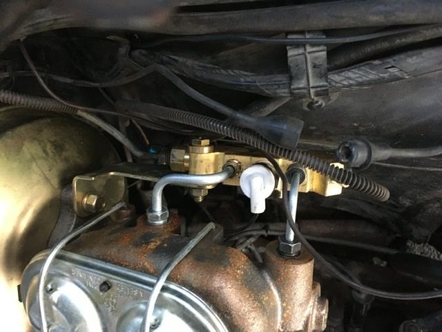

Here’s a picture of the connector on the d/s fender well.
Fuse line?
Old Jan 13, 2020 | 07:32 AM
Page 1C-16 in the 1970 CSM, General Specifications table. AGC 30 amp.

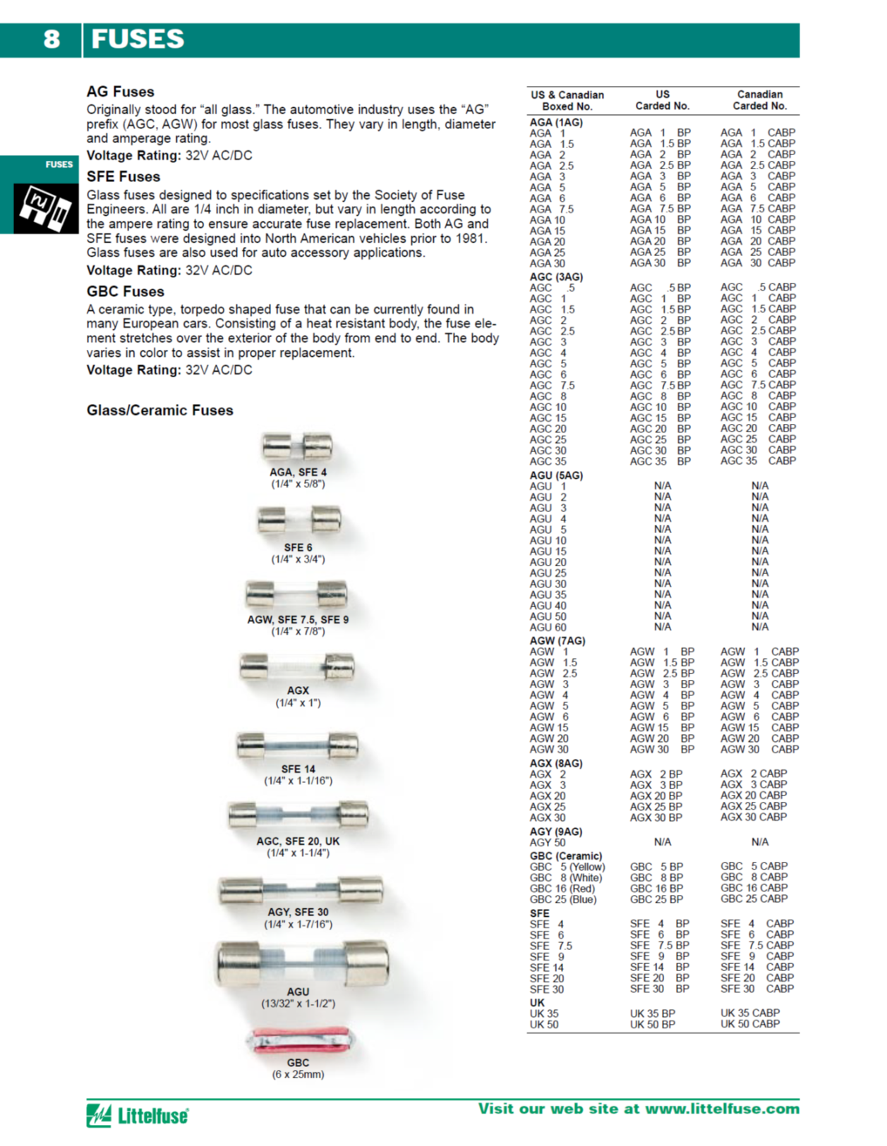

the 30 amp fuses I have are to long, the connector isn’t large enough. Do they make a shorter size?
Old Jan 13, 2020 | 12:39 PM
There are a multitude of different glass fuse standards. An AGC fuse is 1 1/4" long. It sounds like you have an SFE 30A fuse, which would be 1 7/16" long. AGC fuses are all the same length no matter the amperage. SFE fuses are different lengths for each amperage. The intent of the SFE standard was that you couldn't put a higher amperage fuse in a circuit designed for a smaller one.
Yes, They make the shorter one you need.
I replaced my Fuse with ones purchased from Autozone or Advance Auto Parts, they sell them
I am at work or I would take a picture of what I picked up. They are made by Buss, If I remember correctly.
Gary
Old Jan 14, 2020 | 09:59 AM
It's an AGC 30A fuse. They are available everywhere. Do not confuse this with the longer SFE 30A fuses.
