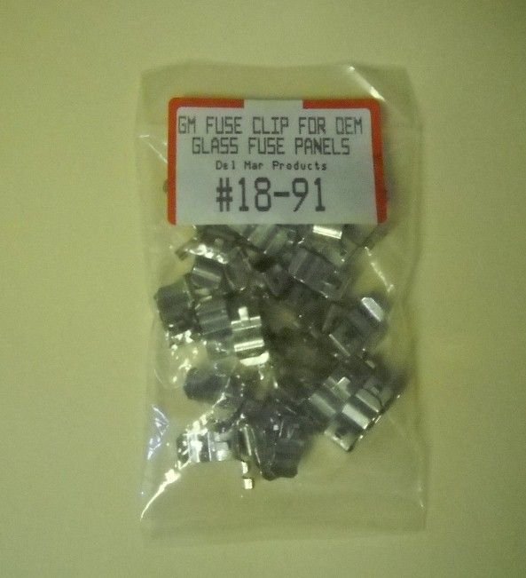

OK, boys and girls. Once again, Google is your friend. Del Mar Wire and Products has the fuse block terminals for glass fuses. P/N 18-91 for 18-20 ga wire and P/N 18-90 for 10-12 ga wire.
Old Dec 30, 2015 | 02:40 PM
Posts: 50,815
OK, I just ordered 50 of each size. These puppies aren't cheap, so be warned. The small ones are about $1.50 each, large ones are like $1.75. Considering that a 1968 fuse box only has 10 fuses, that's about $30 if you need all of them.

I have to admit, finding this took a while. I tried a bunch of search terms with no luck. There was no direct link from Google. The Google search finally led me to a Nova forum, and one post in that forum had the URL for Del Mar along with photos of the clips.

Nice find, Joe! I've been looking for those for almost 2 years!
They even have the unobtainable twin lock terminals for the bulkhead. I had to pay ridiculous money for those off E-Pay.
Too bad they don't have the 14/16 clips. Probably previously gobbled up.
Just put an order in.

A couple of additional notes.
First, there are other vendors of similar clips, but all the other ones I've found are designed for either solder mount to a PC board or rivet mount to a fuse holder. These are the only ones with the locking tabs on the sides that snap into the plastic fuse block.
Second, some of the factory clips are riveted to a bus bar behind the fuse block instead of being crimped to wires. You'll have to do a little fabricating if you plan to use these clips in those positions. Cut off the crimp feature and drill a hole for the rivet. Again, SOMEBODY makes those particular clips, since you can buy a fuse block rebuild kit for Corvettes and some Mustangs that have the clips pre-riveted to the bus bars, but so far I have not found a source for just the clips. The hunt continues.
Of course, if you don't care about 100% originality (since the bus bar is not visible once the fuse block is installed), you can also ignore the bus bar and simply wire all the clips as needed. The factory used the bus bar to save labor, but for a single car, that's irrelevant.
