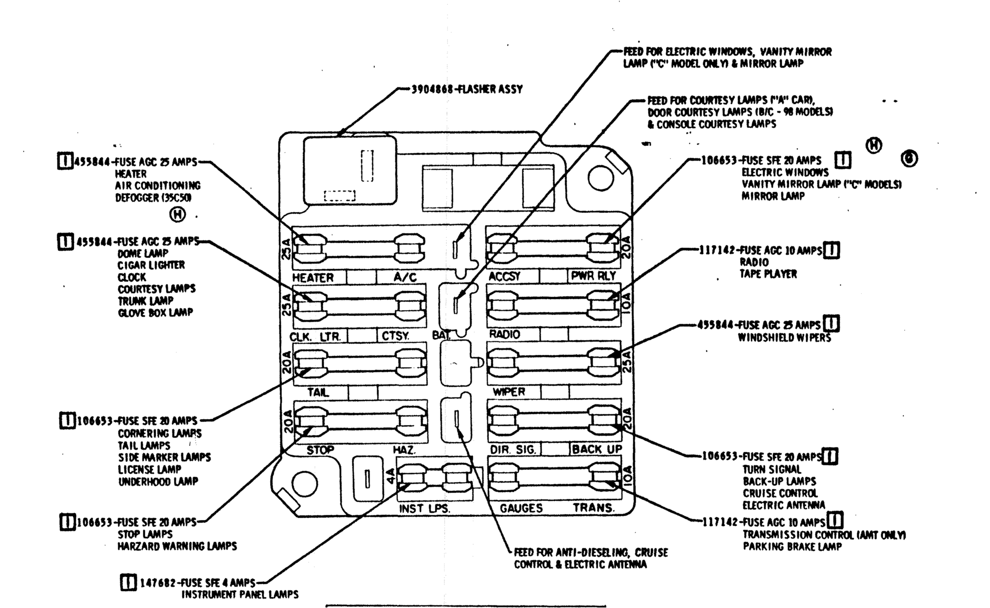

Welcome. Here's your very own thread rather than resurrecting one that's been dead for five years. When you say the dash lights won't turn off, are you talking about the illumination lights in the gauges? If so, these are powered by the headlight switch. They come on with the running lights (park and tail lights) but then the circuit runs through the rheostat in the headlight switch so you can dim them and then back to the fuse box to the 4A INST LPS fuse before feeding the lighting circuit. Is there anything aftermarket added to the wiring (stereo, aftermarket gauges, etc)? When you pull the fuse, are you pulling that 4A fuse or the 20A TAIL fuse?

yes the gas and speed gauges stay on even with car off i pul;led that 20a fuse and it went off along with access lights dome cigar light
i turned on and off the headlights and dash still wont dim or turn off
i looked under the dash and saw a orange wire connected to the light dimmer/headlights that went to fuse box but also saw same wire behind sterio that was disconnected i reconnected and got the dome lights to work but now dash lights wont go off

OK, replace the 20A fuse and pull the 4A INST LPS fuse. Do the lights stay on or go off? And please answer my other questions about any non-stock equipment or wiring. The mind reading thing still isn't working.

thank u , the lights stayed on when i removed the 4a fuse and yes i do have an after market radio hooked up
also it was actually the 25a fuse that i pulled to make the lights go off but like i said it makes the other lights like dome cigar acess lights not work

If the lights stay on with the 4A fuse removed, you have a short to power. My guess is the aftermarket stereo wiring. Unfortunately I have no way of knowing how it was wired up. The dash illumination lights use the gray wire. Short of tracing every inch of that wire to find the problem, there is no easy way to do this.

thank u very much i think i saw a gray wire in back wrapped togther with orange wire that was disconnected and when i connectedit made all lights work but i think there is a constant power to the dash wire . like you said i should check the radio wires to see if its connected somehow

So what was it? The gray wire connected to the orange, which is constant, not a keyed source?

yes gray was connected to orange i disconnected and everythings fine thanks again
