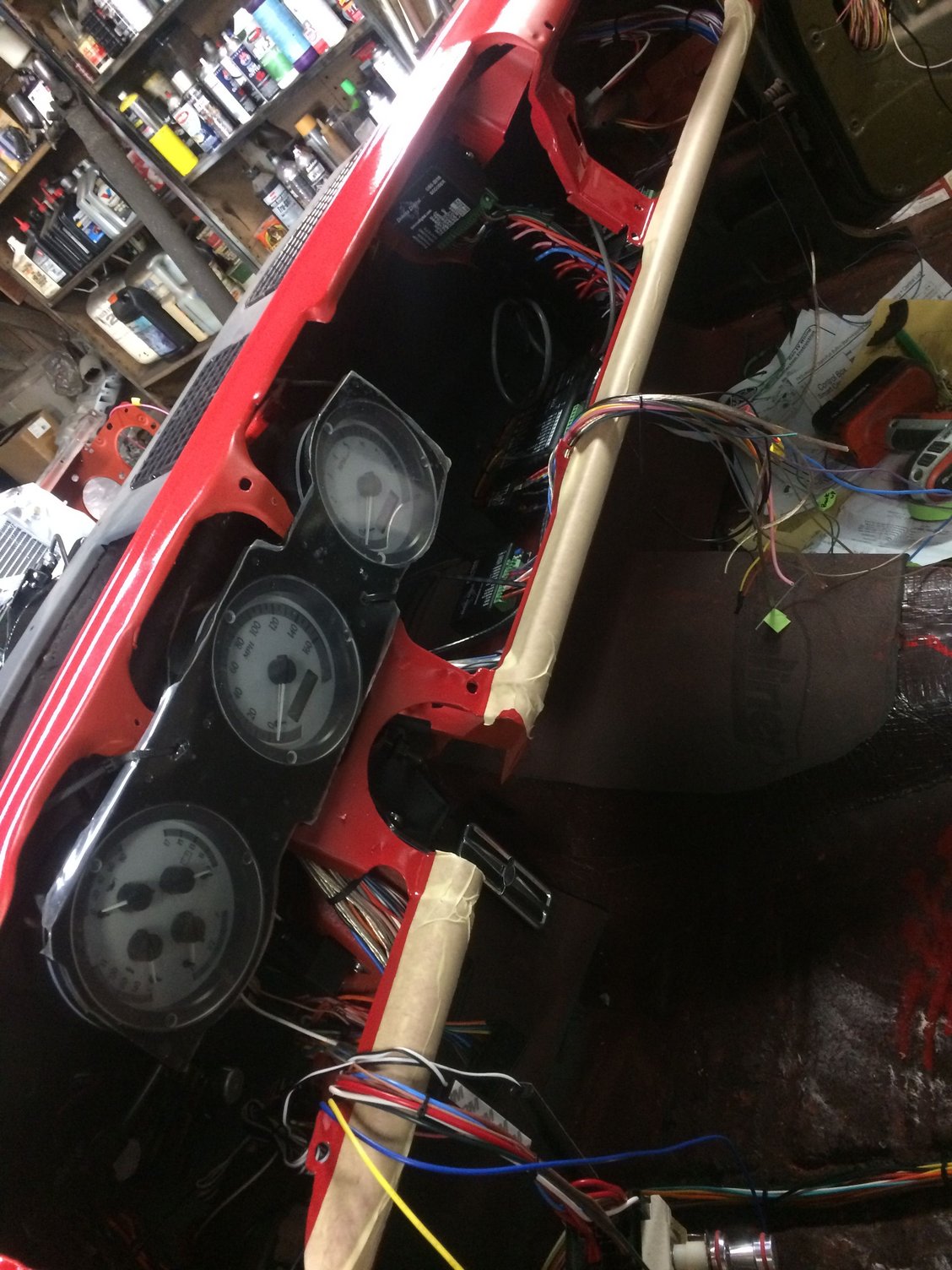

I used a new 21 circuit harness with plastic style fuses when I rewired my vista cruiser and the dash modules account for 6 (main dash module, gear shift position, fuel pressure, air tank pressure, trans temp, power steering temp) of the 20 or so modules and computers in the car so I can't help much with photos of integrating the module into a stock harness. As for the question about the brake light, the factory light is connected to the parking brake and the differential switch in the distribution block (parallel and independant ground connections). This junction is made in the fuse block just behind the bulkhead connector so if you use the wire running to the back of the dash it will be connected to both just like the factory light is. I do not know of a connector that will attach to the factory dash plugs. You could possibly cut up another harness and find pins that would allow you to plug your existing dash connectors into the connectors from the donor harness. Something like a nail that would act as a male insert into both female connectors (original and donor dash plugs). Then use the donor connectors/ harness to make your connections to the dakota digital dash module. To me that seems like a lot of trouble and places to lose continuity (if you find copper or brass pins/ nails you could solder them to the donor harness connectors which would eliminate some possible issues making it almost like the stock dash circuit board). I would just cut off the factory dash connectors and use the wires from the factory harness for the dash module. As a tech tip, these moduels use a small set screw to secure each wire. I prefer to tin (solder) all of these connections before inserting the wire into the module connectors.

Sounds like you have a heck of a customized set up in the wagon. Good point regarding the factory brake light wiring, I overlooked the fact that both switches are on the same circuit, TY. Another thing occured to me, do avoid damaging the factory harness I could de-pin the connectors as needed then solder the DD wire to the female connector and use dry shrink tubing to insulate.
Good point regarding tinning the wires on the module end, those set screws work way better with a solid core.

Andy---a few thoughts and tips from the ones that I've installed and I've done lots of DD clusters, wiring harnesses, and such in these vintage cars.
First, on both my personal cars, I installed a new American Autowire harness. In my opinion, they are the best and most capable as far as what they offer and the quality of what you get. There are many advantages including the additional circuits that are included for use as well as clearly marked wires, great schematics, and good tech support if you need it. I just finished a complete re-wire of a 68 Camaro last week with this harness and a DD cluster. Turned out fabulous. People love the harness because you can tailor the length and routing of each wire in order to keep them allot cleaner than factory ever did.
On the DD cluster...there is an I/O box that must receive all signals from the various inputs to include the ones you asked about related to the brakes. Every signal that you want the dash to display must be landed into the I/O box. In order to get the signals into that box, one could take them from the factory harness with connectors or terminals into the I/O box without destroying or contaminating the factory harness if you wished. I'm sure that DD may even have small harnesses that are meant to go from each trunk of the harness to each branch. Possibly these branches could then run to the I/O box. I'm sure there's a way. It's also of note that the DD clusters require their own calibrated sending units for oil pressure and coolant temp. These sending units also have specialized wire whips that are in soft, pliable, black conduit and run from each sensor to the I/O box. At some point, you would have to vary slightly from that factory OEM look for certain things. It depends on how "original" you want it to look.
If you would like pics of the I/O box or have any other questions---let me know. I do love my DD cluster in the 442 and the ones I have installed for others.

That could be a good option as well or you could solder the wires direcly to the factory female connectors as long as you don't get any solder in the female end of the terminals as that would defeat the purpose of trying to save the ends. Another usefull tip, once you have all of the connections de-pinned if you soak the copper connectors in lemon juce for a few minuites it will remove any oxidation. Then, wipe each one down with laquer thinner to remove any remaining juce, add flux, and finally solder the new wires to the crimped portion of the connector where the original wire is attached. Once you add heatshrink over that connection it should work very well.
By the way here are some shots of the backside of my dash from when I was wiring the car. Hard to see everything, but as you can see there is a lot going on.
