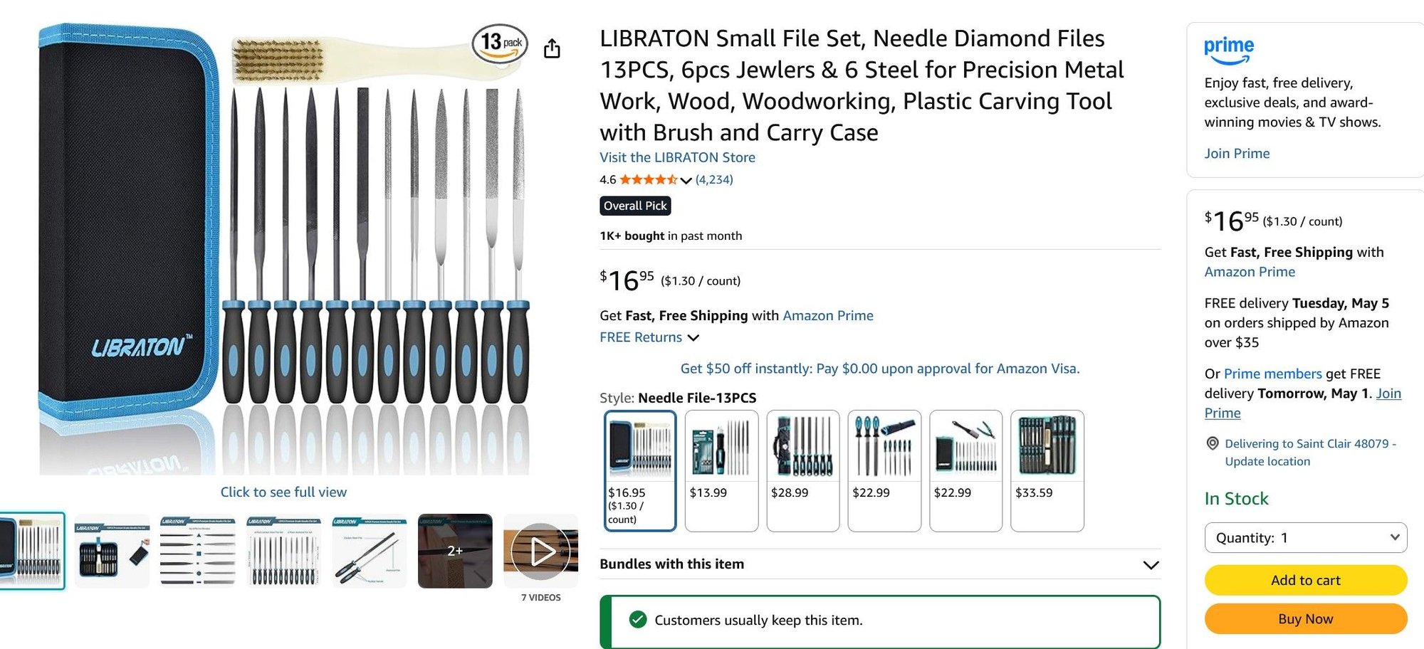

To clean the flat lugs (male and female), for many years I have used a set of small files. I picked up this set for about $2 in the markdown bin at a drugstore probably 25 years ago, and I go back to them all the time. In particular, the flat one at the far left is pretty much perfect for fitting into those plastic shrouded flat lugs and rubbing it back and forth to clean the corrosion.

Those can be called jewelers files
I use them for the exact same thing.

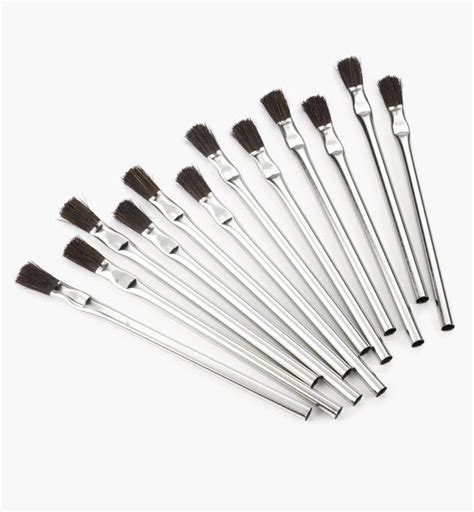

In addition to using this, I use acid swabbing brushes and cut the bristles down to about a 1/4" to 1/8" to make a stiff cleaning brush.
Veritas Acid Swabs or Glue Brushes | 12 Pack – Hardware Centre

Those can be called jewelers files.
Thanks! I would have never thought of that. Here's a set on Amazon for all of $17. A little fancier than mine. These have actual handles, and a nifty carrying case.
Good suggestion. I do same. I have a full bag of those acid swabbing brushes.

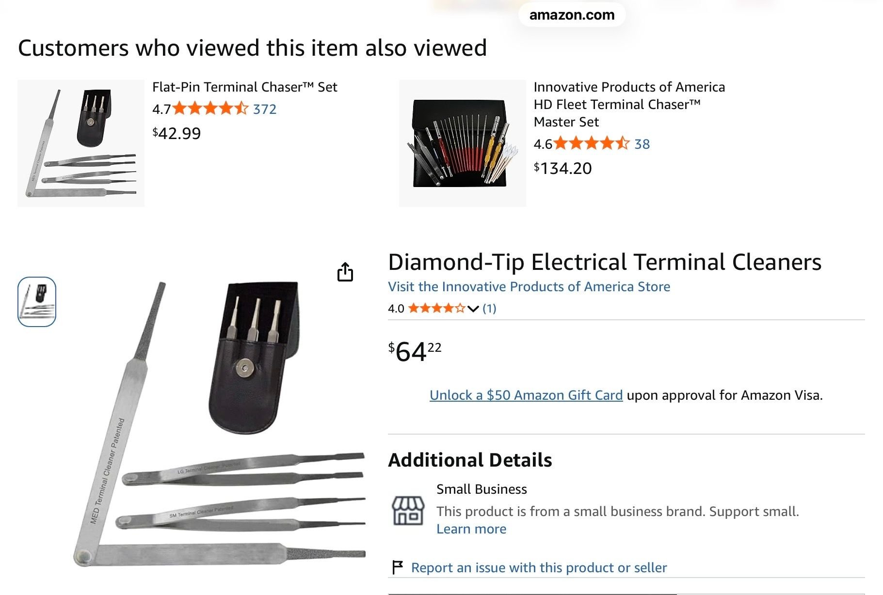

My typical go to terminal cleaners. Not pictured is trailer hitch/bulb socket cleaning kit. The ones I have come on a keyring but I never can find them. Mine probably came from one of the tool trucks.
I have a kit similar to this.

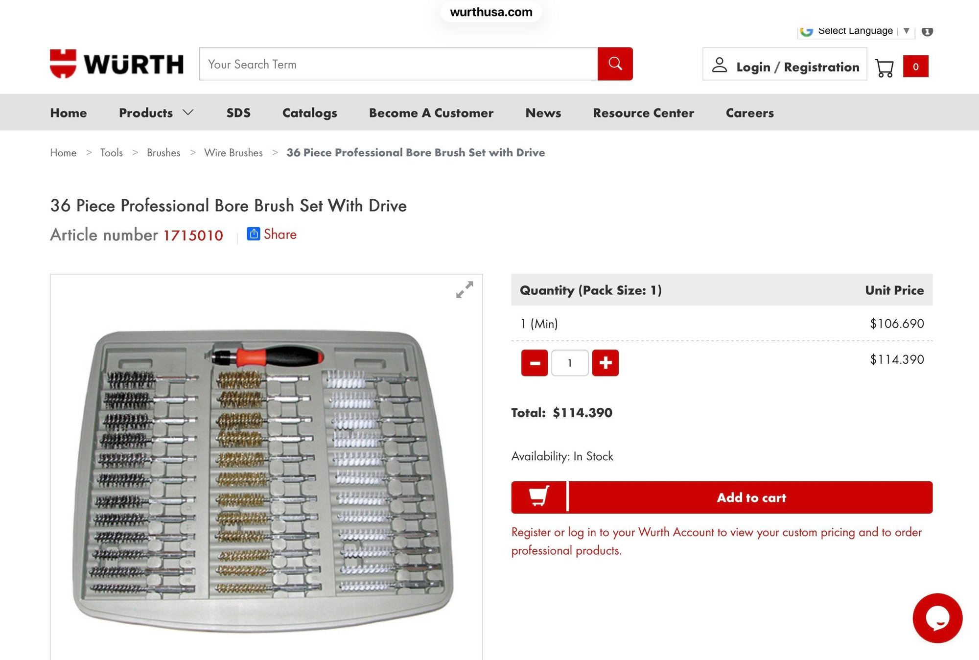

Bore brush kits can be quite handy for electrical connections as well.
