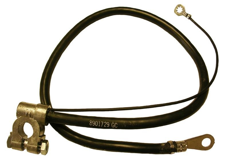

What is the best way to make the negative battery terminal cable head larger without marking up the metal ? My battery terminal is a little larger. I want to be as meticulous as possible and have the cable seat on the battery properly.

I’m putting the finishing touches on my restoration on my ‘70 W30. The negative cable I bought is from Fusick. I just put a newer, more powerful battery in the car. I do not want to mark up the battery cable. The cable end is too small for the battery terminal - but not by much. The cable end is malleable - which is good and bad. Easy to expand I would think but also east to mark up. I restored the car to as close to factory stock as possible - trying to keep it that way. Is there a way to expand the cable head without marking it up ?

Is it the style with a bolt clamping it closed, or is it the style with a spring clip holding it closed? If it has the bolt, you just remove the bolt and slide a large thick flat bladed screw driver or chisel between the ears and that will spread it without doing damage.

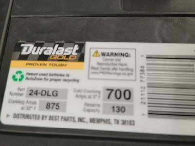

This is the battery.

Mikey, to get clearance, buy a set of plastic pry tools at a local parts store, remove the clamp bolt, and drive a plastic wedge between the opening in the clamp halves. If you did this from the bottom you would have zero worries about leaving marks.

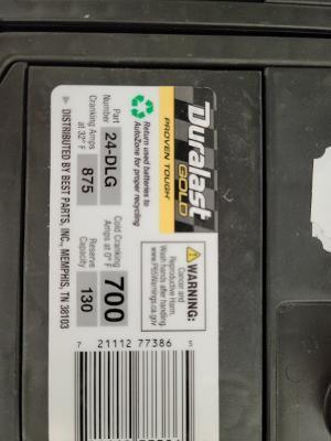

Thanks Gary. No it’s not a concours battery - I use the faux Delco cover. This is actually the battery. If anyone is looking for a decent battery that retro cover fits then this is the best I could find - after experimenting with a bunch. Some batteries in Size 24 have the terminals on the opposite side of the battery. Some have the terminals reversed. Some batteries do not have the lips on the bottom of the battery to get secured properly.

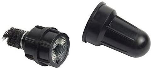

Posts: 15,394
Maybe one of these battery terminal cleaners could be used to slightly ream the inside diameter so it fits better.
That's similar to one of mine.
Old Dec 6, 2022 | 12:42 PM
Posts: 25,789
If you're not off by much, my first approach would be the hard metal wire style battery post cable end cleaner. If you don't have one or have never used one, they're excellent.
