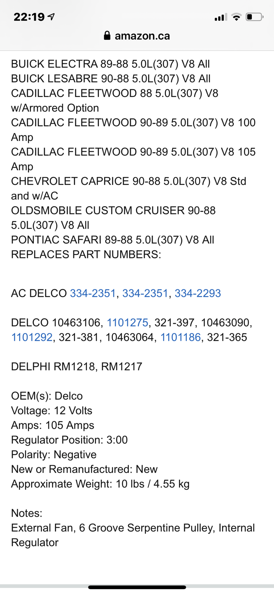

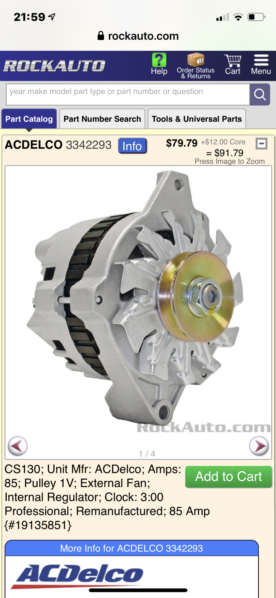

Looked for it at rockauto and found this one, acdelco partnumber 3342293.
Googled on the part number and found this;
So if I find one that fits one of the cars above it should work for my car?
I see this one don’t have the v-belt pulley. Do you know if it’s possible to swap my v-pulley to a “serpentine model alternator”?

Once again, the RockAuto online catalog is NOT a reliable source of information. The photo shows the actual alternator. Note that it comes with a V-belt pulley. In fact, if you look at their catalog on a real computer instead of a phone, note that the listing says "Pulley 1V". I'll also point out that right below that 85A rebuilt is a 105A brand new version for less money. That's the one I have, FYI.

I noticed that one below also, but wasn’t sure about it as it didn’t mention “CD130”. But if that’s the same one it’s a better choice of course👍
