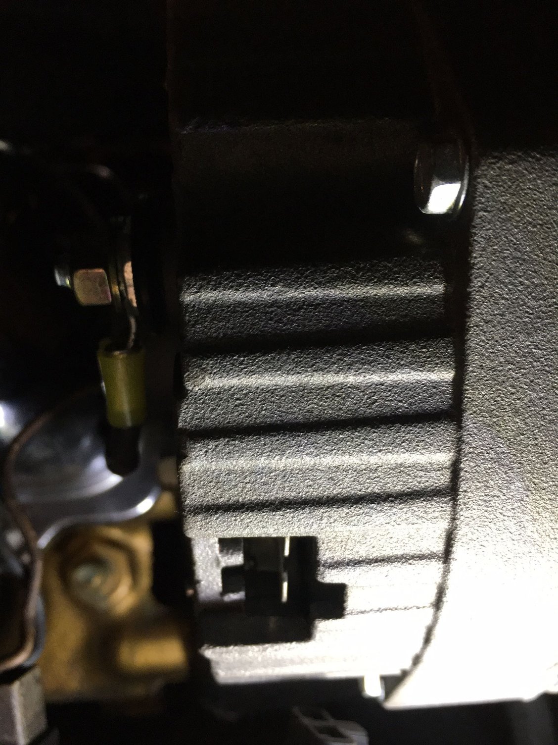

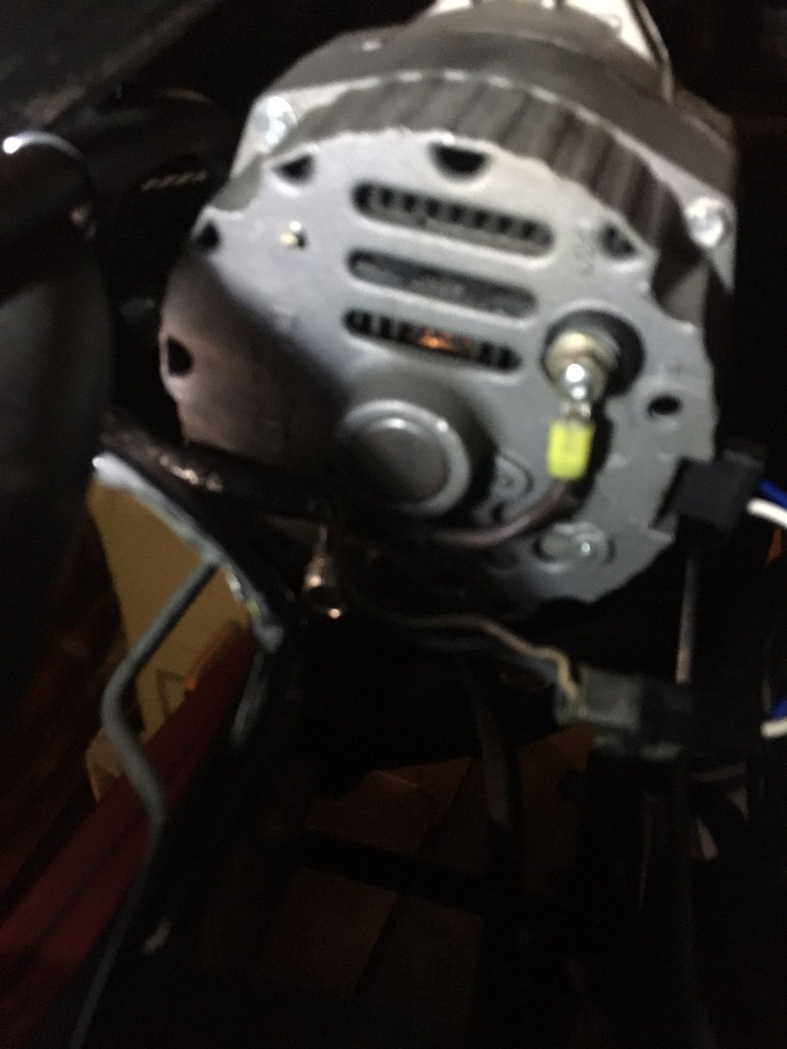

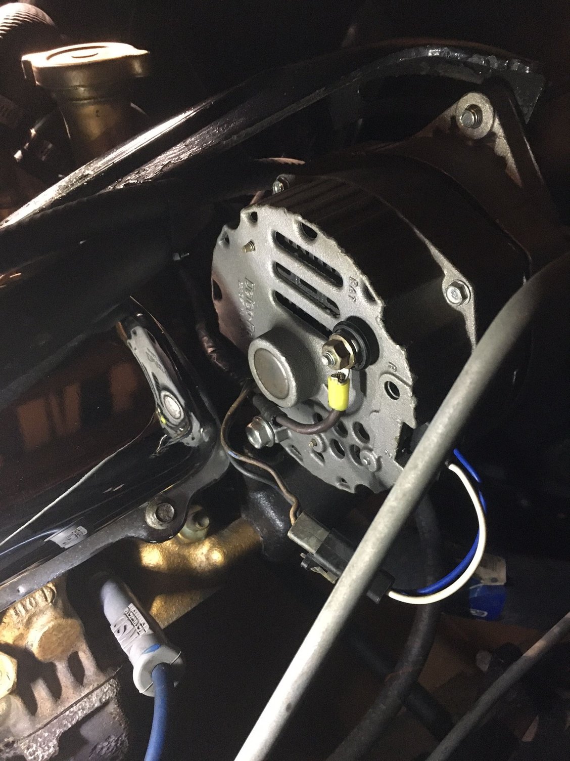

Alternator photos
All wires, bat wire and other two, go to the terminal block at the horn relay and branch from there. There is no external VR hook up. I realize this is not original, neither is the motor or trans, but I think the guy who restored it around 2005, tried to make it appear original as possible, Hence using an older one and converting
DN and rebuilding it.

This is the money shot. You have an internally-regulated alternator. You don't need the external regulator. You need to ensure that the wire harness is correctly modified to accommodate this alternator.
