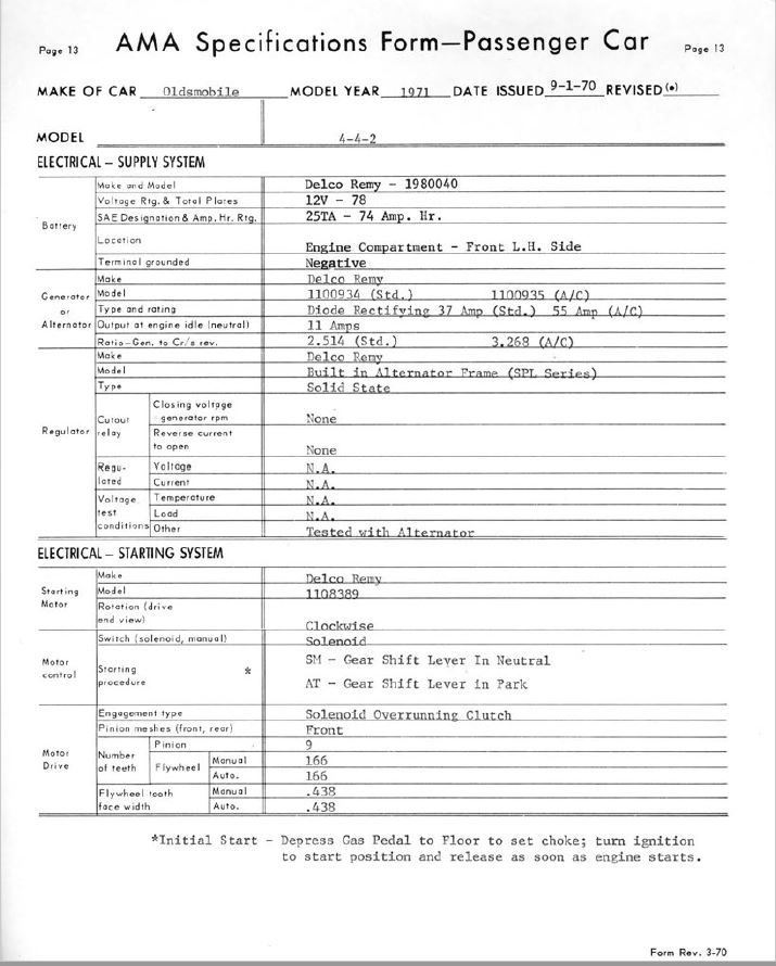

Would anyone know the correct OEM battery part number for a 71 442 4-speed with A/C?
Also, need this battery for show
thanks

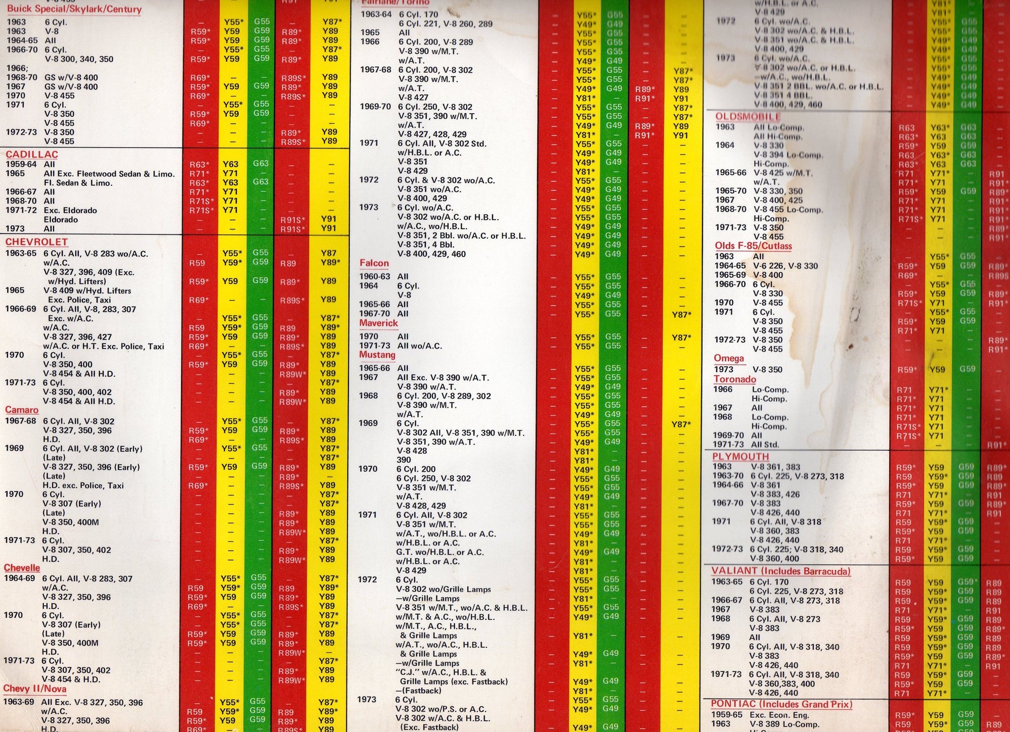

R-71

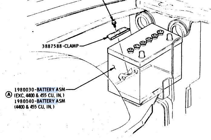

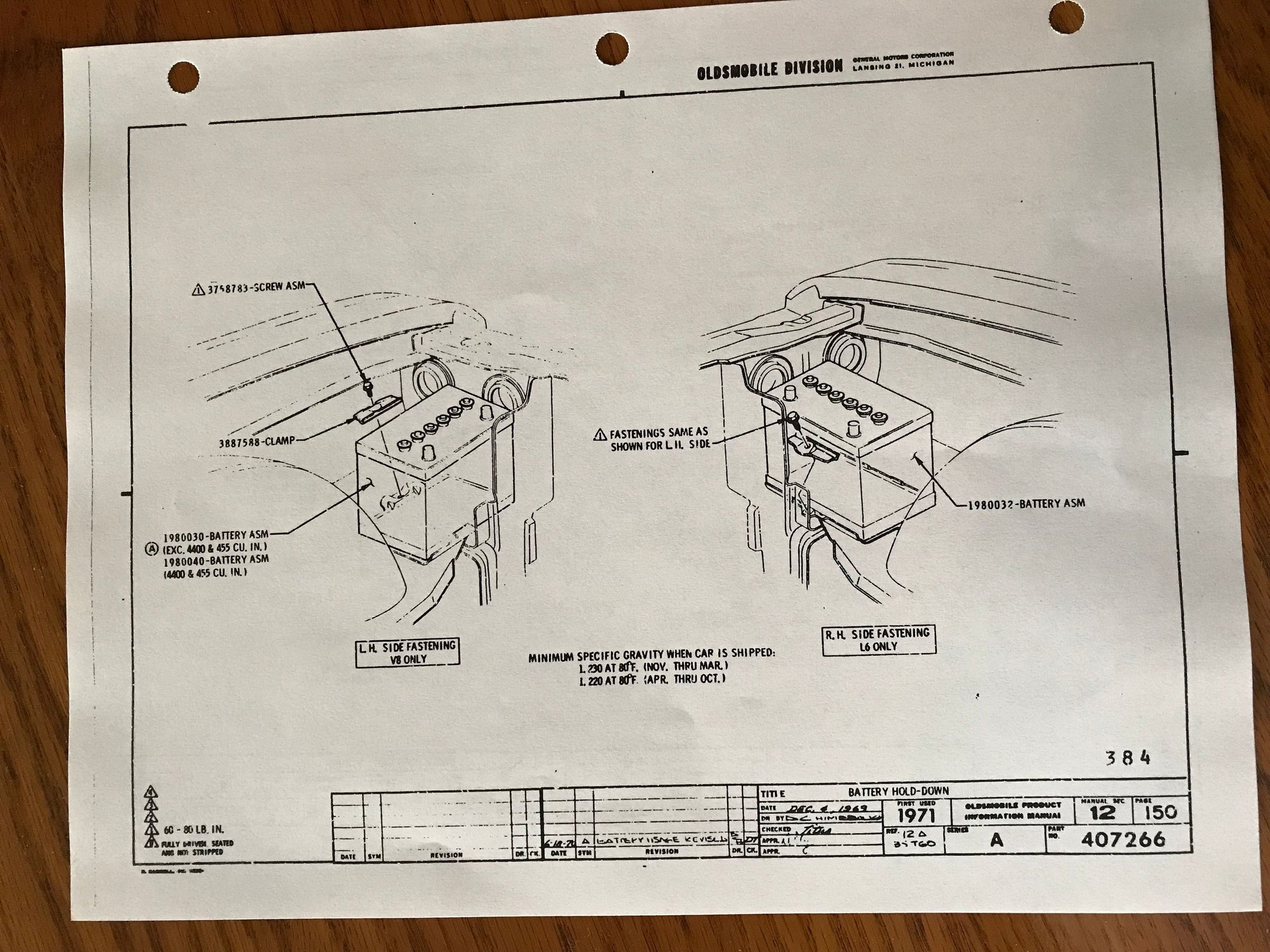

Sometimes you get lucky, sometimes you don't. Happens the 1971 PIM demonstrates the OEM battery number. Section 12, Page 150 (384)
Last edited by Vintage Chief; Oct 8, 2021 at 08:38 AM. Reason: page 150 not page 50
Old Oct 8, 2021 | 08:36 AM
Posts: 26,066
1980040

You guys are great! thanks so much, really appreciate the help! Now if I can find one.....

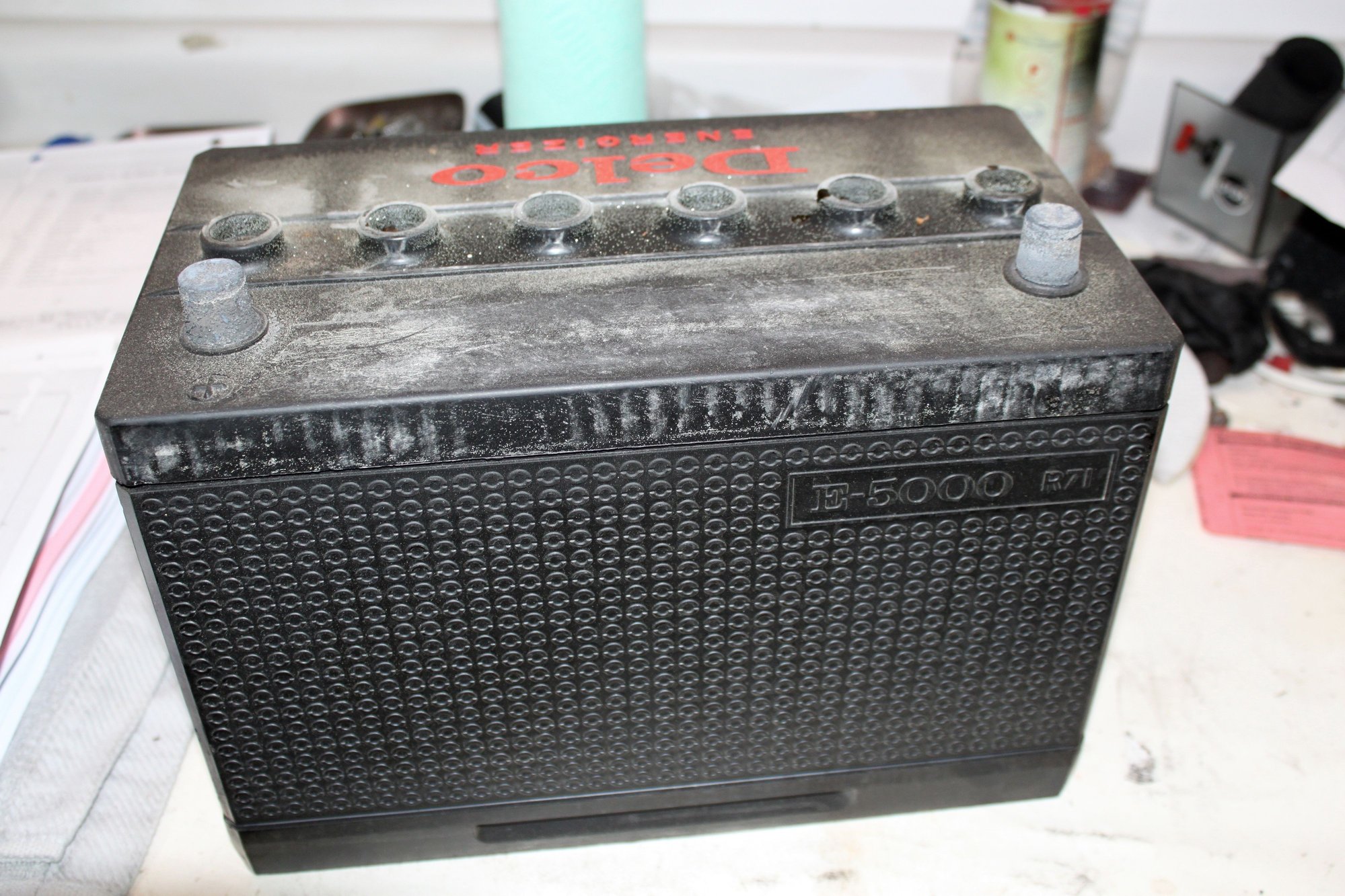

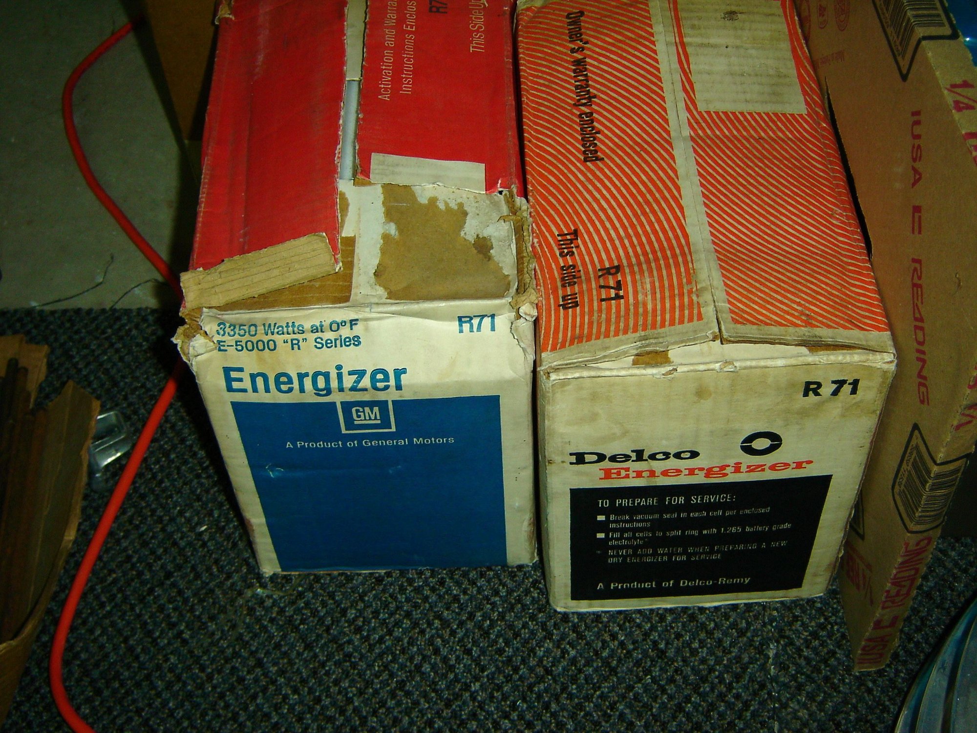

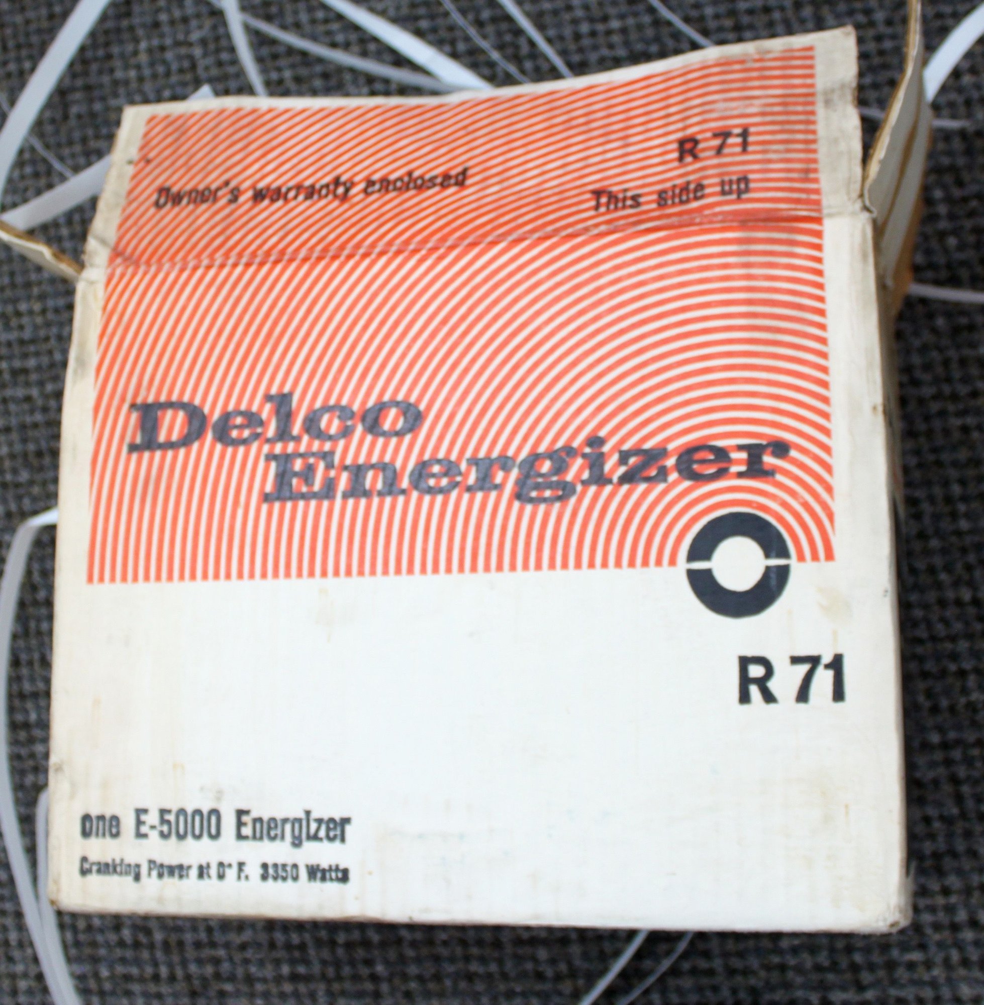

This one went for one pretty penny today.
NOS GM DELCO ENERGIZER R71 E-5000 BATTERY BUICK CHEVY OLDS PONTIAC
