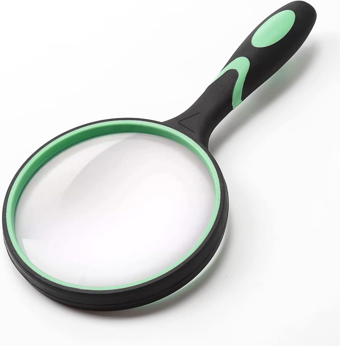

You might consider owning a magnifying glass to read the paperback color wiring diagram in the CSM.
