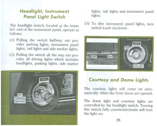

Originally Posted by sportcutlass
now the turn signals work and signal lights on the speedo work correct, the high beams light works on the speedo. However, I still can't get the actual speedo lights around the numbers to turn on.
You might check to see that the headlight **** hasn't been turned to the right. It thermostatically controls the brightness of the dash instruments.
Old Feb 14, 2019 | 03:59 PM
sportcutlass's Avatar
Joined: Oct 2018
Posts: 27
Thank you, I have attempted that a few times. I've tried turning it on/off whenever I test and it still gets no light. Turning to the right will turn off the high beam light but turning to the left doesn't make any of the others turn on
