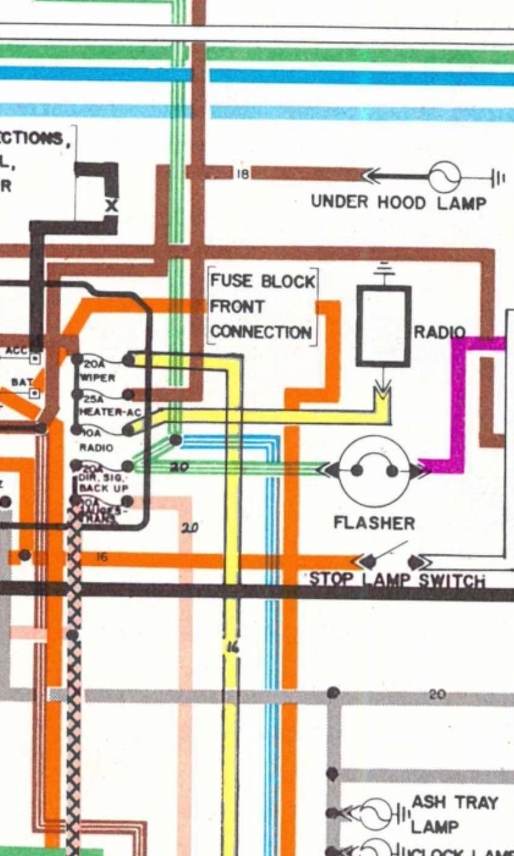

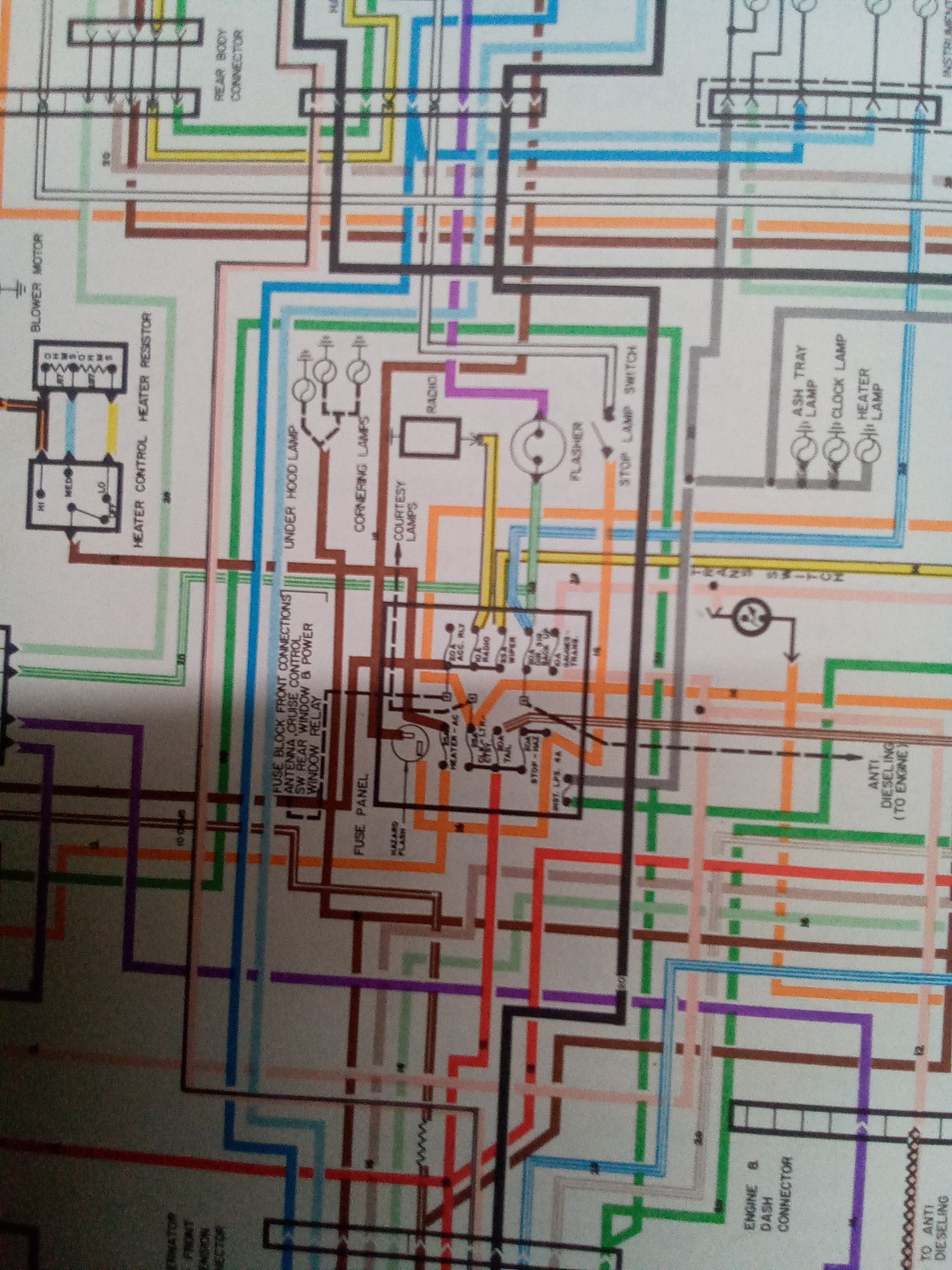

68 diagram more clear
Thank you! IMHO, the 68 diagram is more clear. In the 69 diagram the key is the dotted lines. Nice to see the battery connection labeled on the 68 diagram for us challenged folks
Old Oct 24, 2021 | 06:22 PM
Posts: 25,663
Agree. The ‘68 diagram better illustrates the fuse panel front connection is a direct path to the battery spade terminal. Different design illustrators for the two years, perhaps?
