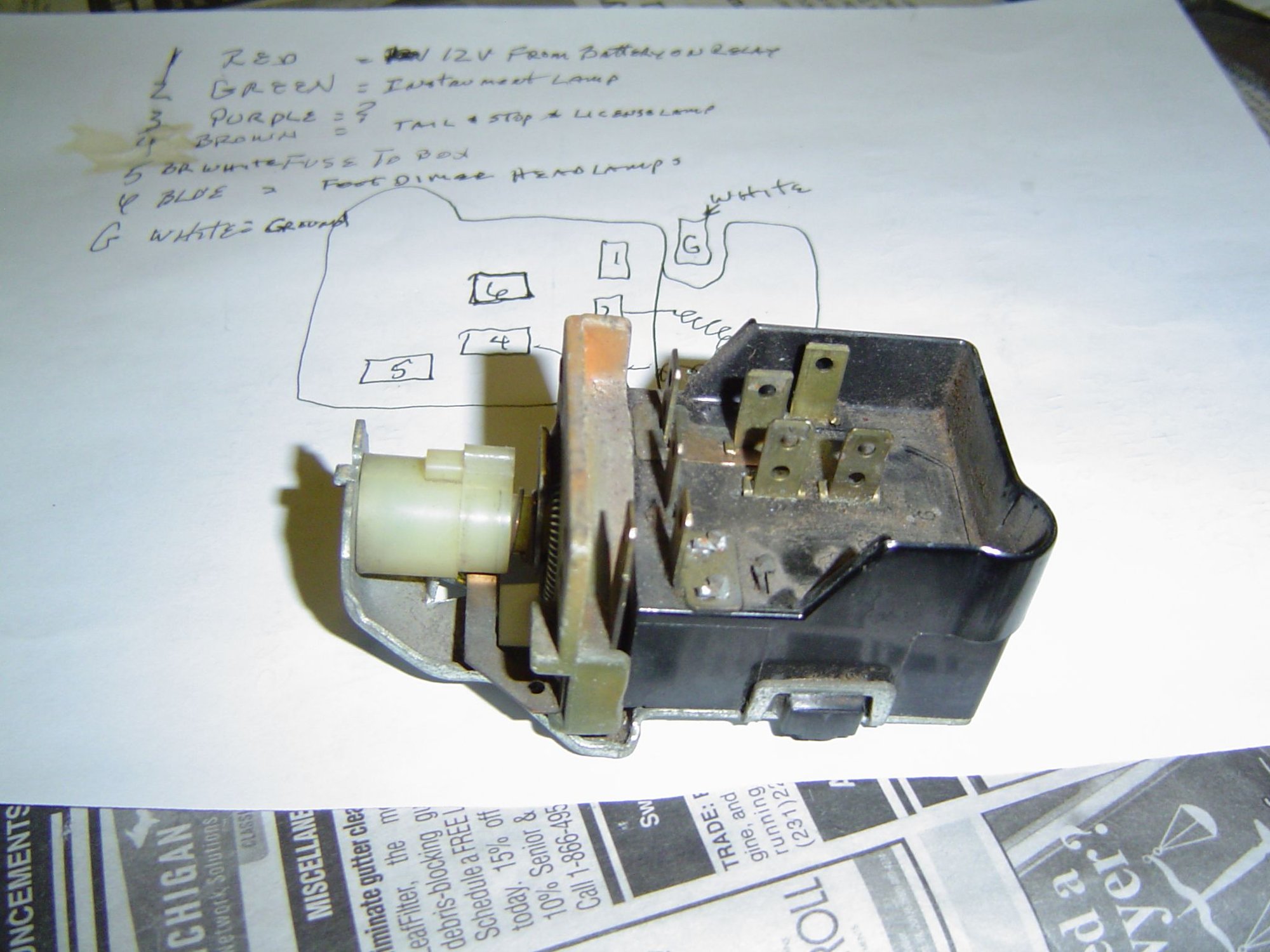

I seam to be taking 1 step forward and 2 back! I went to replace my headlight switch and found an 8 pin switch in the car and it should be a 7 pin! My problem is that it looks like some one switched some or at least one wire and I am not sure of which wire or wires that is! does any one know what wires go where in the plug or a picture of the wires going into plug! I am sending a couple pics of my plug
Old Mar 4, 2022 | 03:42 PM
Bills67's Avatar
Posts: 203
From: Cadillac Mi
headlight switch issue
on my 1967 442 I found out that I had the wrong switch in my car (8 pin) I replaced it with a 7 pin switch! So I move the purple wire from #8 pin position next to the green wire #3 pin and now my parking light do not work! does anyone know why? did I put the purple wire in correct place?

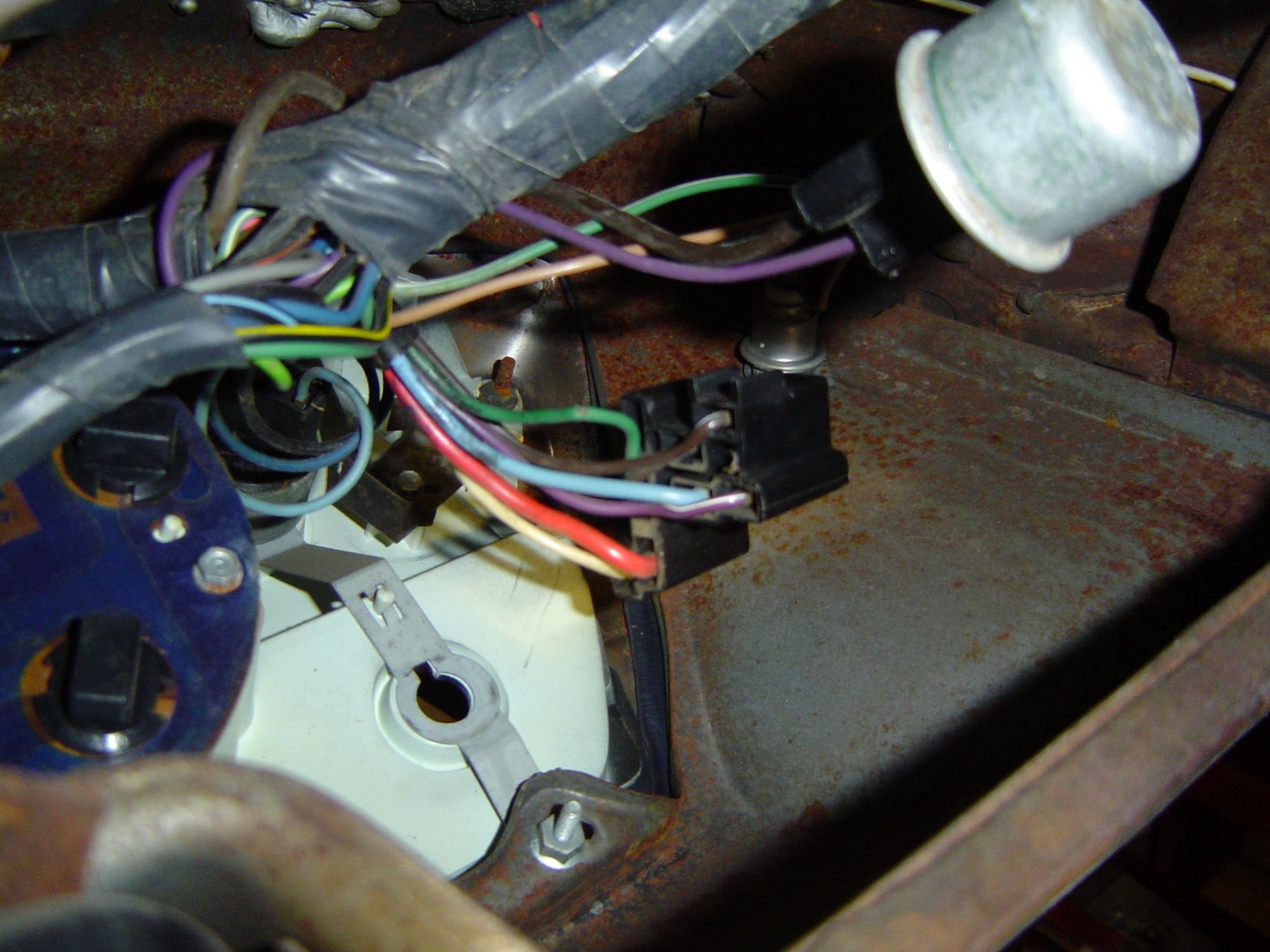

When you say they do not work, do you mean they never come on? I believe 68 was the first year that the parking lights stayed on with the headlights. Prior to 68 the parking lights, dash lights, and tail lights all come on with the switch pulled out to the first position. When you turn the headlights on (pull switch out to the second position) the front parking lights turn off while the dash lights and tail lights stay on. This is how the lights work on the 64-67 chevys I've owned (Impalas, chevelles, camaros) and I beleive it was that way for all of GM as well but I have not had a 64-67 olds on the road so I can't say that for sure.
Old Mar 4, 2022 | 04:30 PM
Loaded68W34's Avatar
Joined: Jul 2020
Posts: 1,942
From: Pennsylvania
I just pulled one of my early harnesses out and the purple wire is located in the same position as the first pic. What made you decide to change the switch in the first place? Were the lights working properly with the old switch?

I can get some pics tomorrow. I would say the switch you had was probably correct. If the rheostat for the dash lights in the original switch is bad you can replace it with the one from the new switch.
Old Mar 4, 2022 | 09:44 PM
Posts: 6,105
hopefully some of that is useful

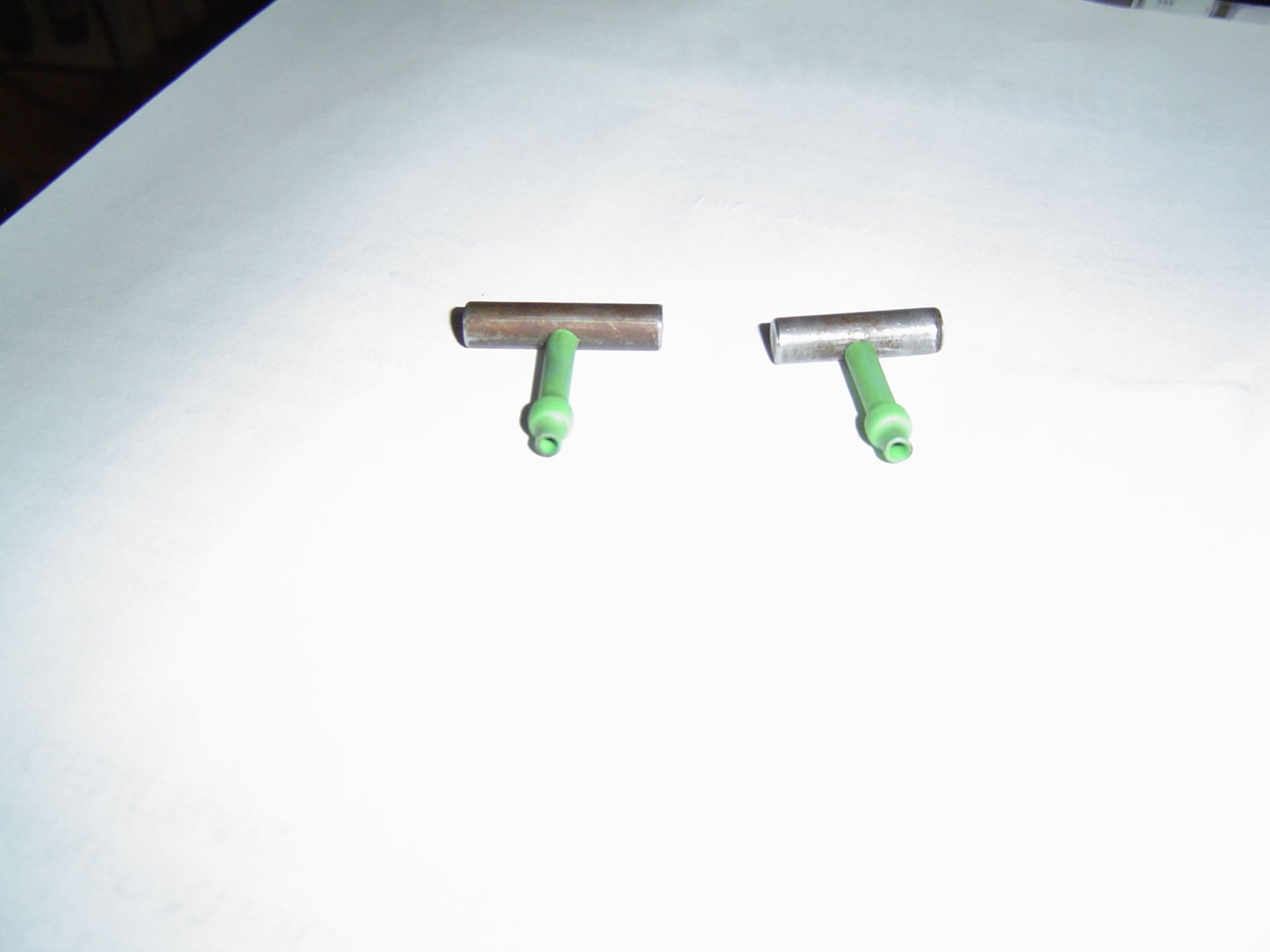

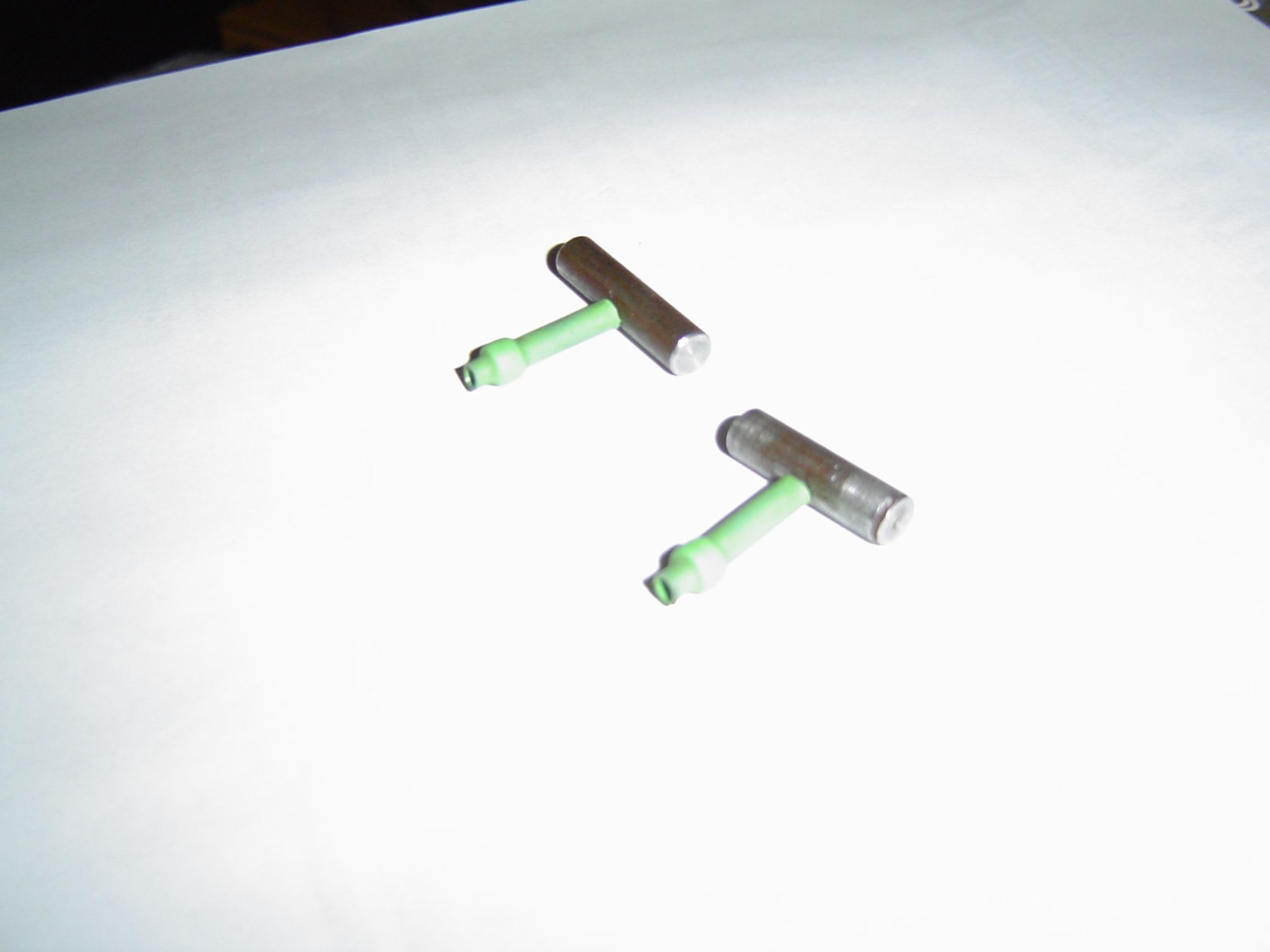

I thought that I would send some pics of the tools I made to lap the contact on my fuse block, just like I do for my scope mounts on my rifles!
