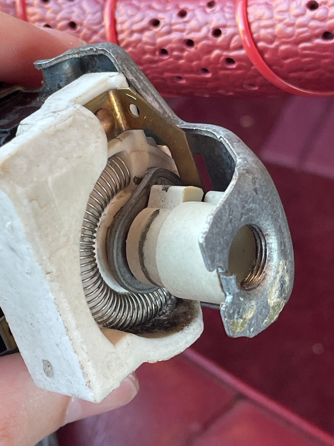

I’m seeing lots of bad reviews for modern production replacements. I think I’ll try cleaning this original one first—I’m certain it’s just resistance built up on the contacts from age/corrosion.
Sure enough, my switch has heavy heat damage/signs of arcing on the rheostat. It was a matter of time before it was gonna burn up.
I bought an aftermarket unit on Amazon for around $17. Comparing to the original Delco Remy switch, I found it to be of good quality and identical in size.
I had the old one out and the new one in and working in about 10 minutes. Super easy job with no removal of dash parts necessary. One big electrical connector plugs in, making installation very simple. Very satisfied.
