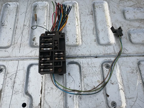

I found a replacement fuse box (original) and just bought it for $50.00, plus shipping. I'm thinking I can simply, one wire at a time, replace wires, old to new!
1964-65 Olds Cutlass 442 F85 Original Under Dash Fuse Box GM OEM
1964-65 Olds Cutlass 442 F85 Original Under Dash Fuse Box GM OEM - Picture 1 of 21964-65 Olds Cutlass 442 F85 Original Under Dash Fuse Box GM OEM - Picture 2 of 2

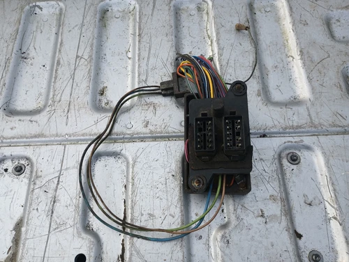

Two Wires!
I'm replacing the entire fuse box; there have to be at least 20 wires coming into that box.
I WISH it were "2 Wires:"
Here is what your "2 Wires" looks like

That replacement fuse block is pretty corroded in itself, hard to believe it's better than the one you have.

The "connecting wire" I was speaking of, which showed "power", key on or no,t is either the "back-up" or "license plate" lamp based on where it is going. The "trunk lamp" wire is easy to identify, also a "connection".
So the question now is "why" is there "power" going to that assumed "back-up" (reverse) wire or "license plate" lamp when NO KEY is on?
As for the following
  1. No external light circuit is powered simply by key on - Agree, knew that but again, the "why" to the question above.
  2. The backup lights are only powered when the shifter is in reverse - Again, obvious and knew that..
  3. The tail lights and license plate lamp are powered from the headlight switch - Agree, and when I have "power" to the back-up / license plate lame, switch IS NOT ACTIVATED?.
  4. The turn/stop lights are powered from either the turn signal switch or the brake light switch, depending on which function is being used - Obvious and known..
  5. Only the trunk light circuit is powered by the key, as the light itself has a mercury switch that only makes contact when the trunk lid is opened.= Knew about the "mercury switch", actually have two in the back shop
Summary: The fuse box is damaged. Some wires (previous owner) have been cut or taped, so I have to figure out "what was done", "where they ran wires", and "why" that back, connected wire has power on, even when
