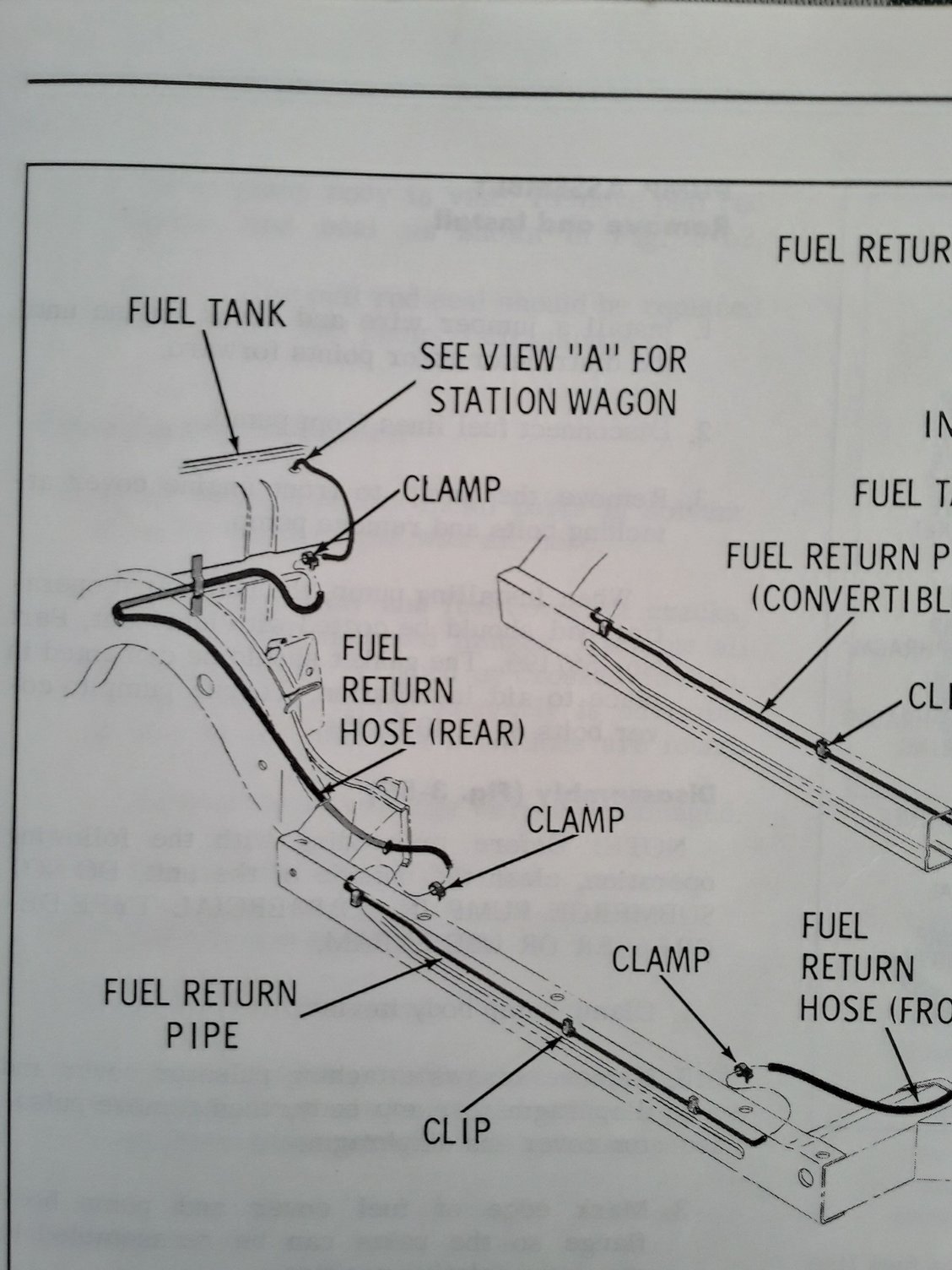

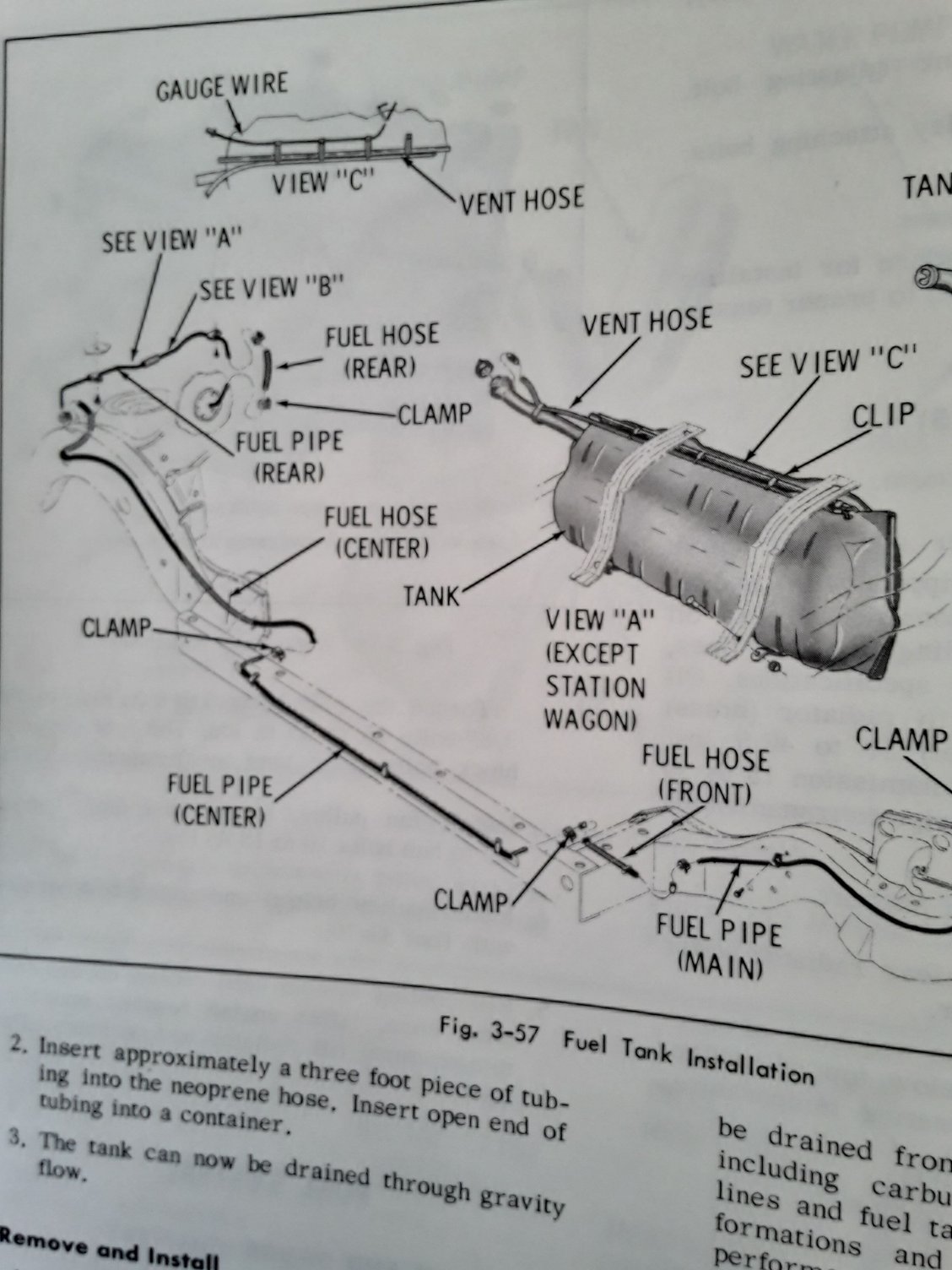

Comparing the new tank to the diagrams in the 64 CSM, looks like they nailed it. The new tank has the fuel return line nipple which would have to be capped on a car that doesn't have it; no biggie. Looks like the filler neck will have to be cut from the old tank and spliced to the new tank using the supplied rubber hose.
