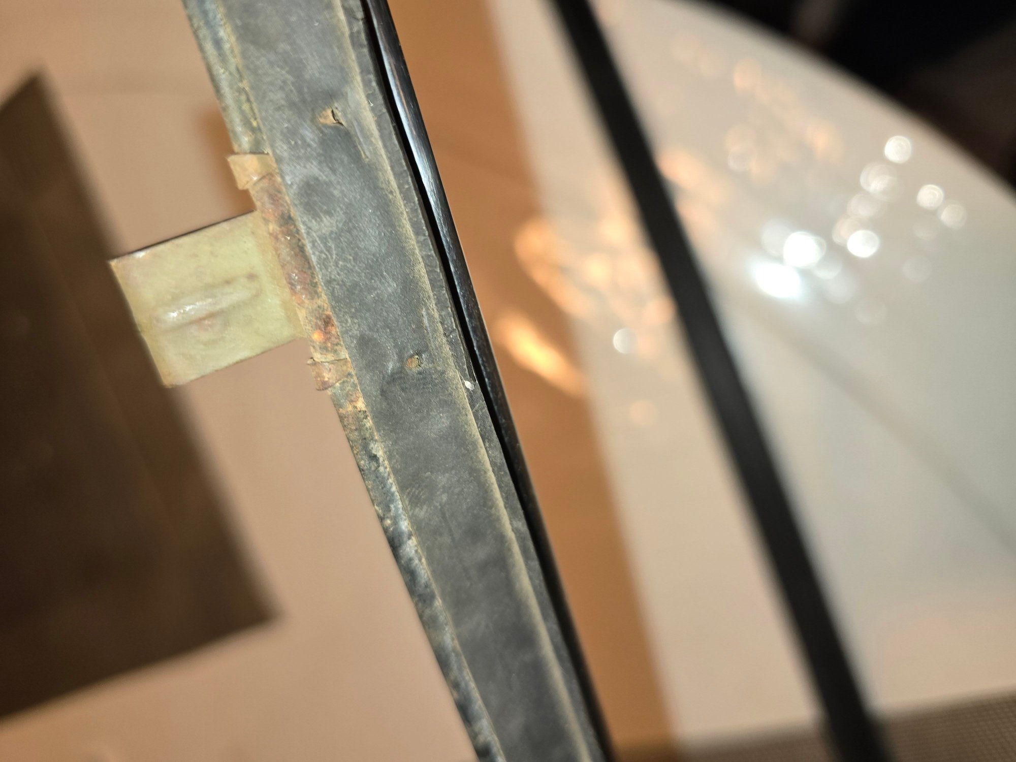

The new part is not a finished part all set up and ready to install, but it is the correct style "window scraper" for my 1964 Dynamic 88 convertible. I started by pulling the door panel because I thought I would have to remove the window mechanism completely to get the old molding out. There's a screw at each end, and I assumed screws all along the entire length, but that isn't the case. I was actually able to remove the 2 screws (one at each end) without removing the window. Then I carefully used a screwdriver to push down on the beltline at each clip location. I was able to release the clips, then pull the beltline out from the rear side of the door.

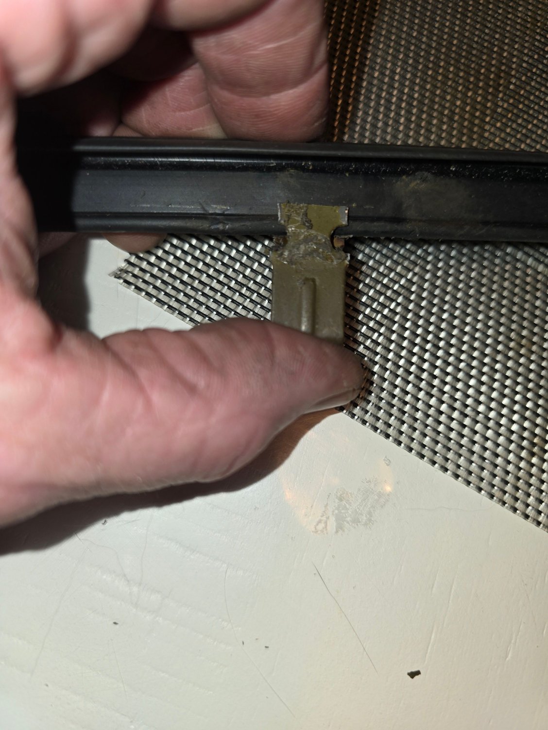

Removed, this is the beltline trim clip still attached to the trim, from the outside of the trim- the side you dont see until you remove it.
Removed, this is the beltline trim clip still attached to the trim, from the outside of the trim- the side you don't see until you remove it.

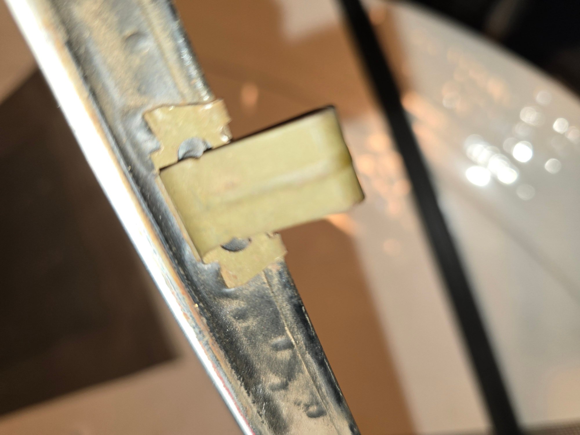

This is the same clip as you would see it if you looked from the inside of the car while the trim is still installed.
This is the location of the clip, after the clip is removed. Little teeth pinch the rubber on the inside at the top of the clip, and another set of teeth wrap around the bottom.

So my first problem is, can I get this clip to grab the new trim piece the same way it was installed from the factory? Can I use an epoxy to attach it? Should I just clip the trim to the door by holding the trim in place and pushing the clip over the trim and the lip of the door? What is the best way to attach this clip to the new trim piece, and then get the new trim on the door properly? I'm not sure yet- and I welcome suggestions, especially from anyone who has done this before.

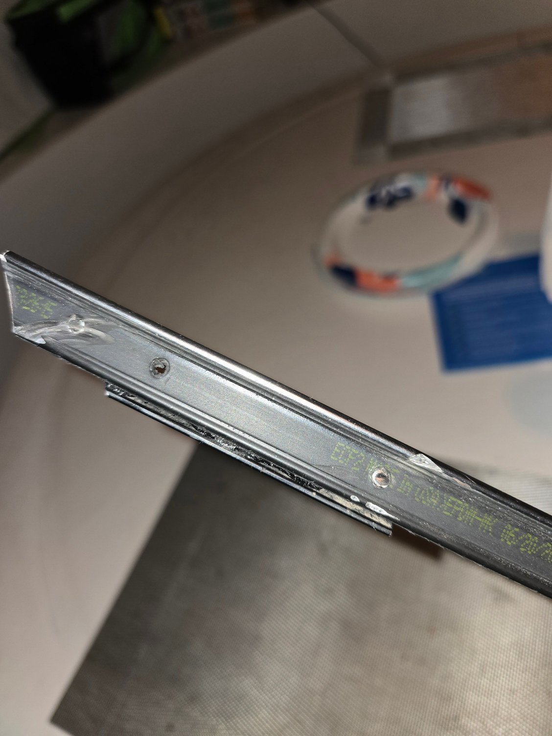

I attached the
I attached the "window block" with gorilla glue and screws, and ground down the back side where the screws would protrude...
clean and neat.

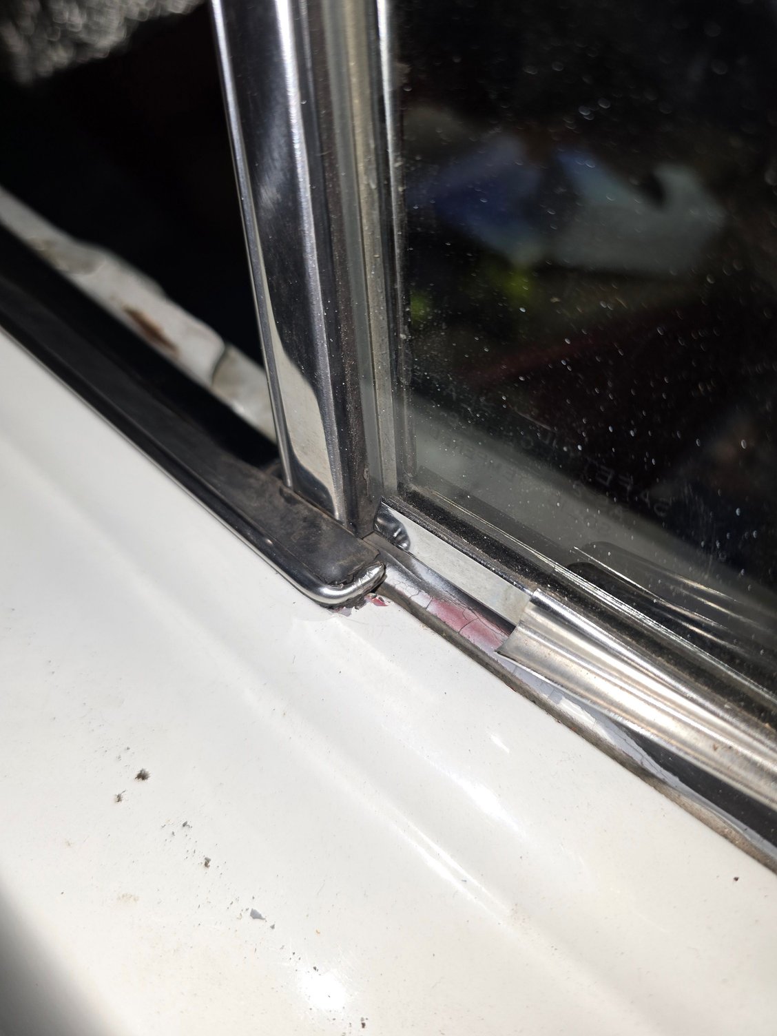

Finished the passenger door beltline trim. It's best to remove the window- working around it is harder than taking it out. I'll post the process when I do the drivers side, now that I've done it once.
wrap at the vent window
before picture, the old part
after picture, the new part installed
finish at the back edge, interior panel not installed
