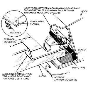

Anyone have info on how to safely remove rear widow trim. Step by step or video would help alot.

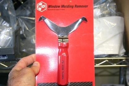

They make a hook type tool, just for removing the trim. Lot of car parts store, should have it. You slip it under the trim, and release the clips that that hold it. I put duct tape, on the bottom of the tool. as you can scratch the window.
