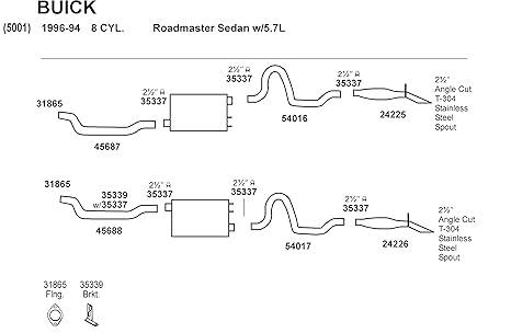

A far better place to start is the 2.5" Walker Dynomax dual exhaust kit for the 1990s Caprice. The 1977-1996 B-body cars all use essentially the same frame. The 71-76 cars have a longer wheelbase and different frame.

http://www.autopartsway.ca/partlist....st_System_Kit/
$921??? and it's cat back instead of $209 for header back. It's fit would need to be a helluva lot better. It is stainless tho.... but why would they aluminize stainless? Something there ain't right

Yeah, you need to learn how to shop. The same kit is $598 from RockAuto. Note that this kit is not stainless, just the mufflers and the tips. By the way, I wasn't suggesting you buy the whole kit. I posted that picture because it has the individual part numbers. Also note that the Summit kit linked above is only 2.25" pipe. The Walker pipes are 2.5".
I personally would buy the head and over-axle pipes separately, use my mufflers of choice, and fabricate extensions to the tail pipes. The two head pipes are $35 each and the two over-axle pipes are $37 each at RockAuto.
