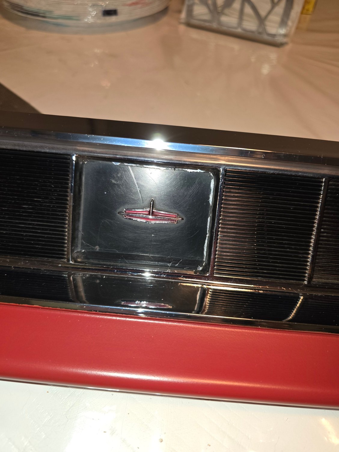

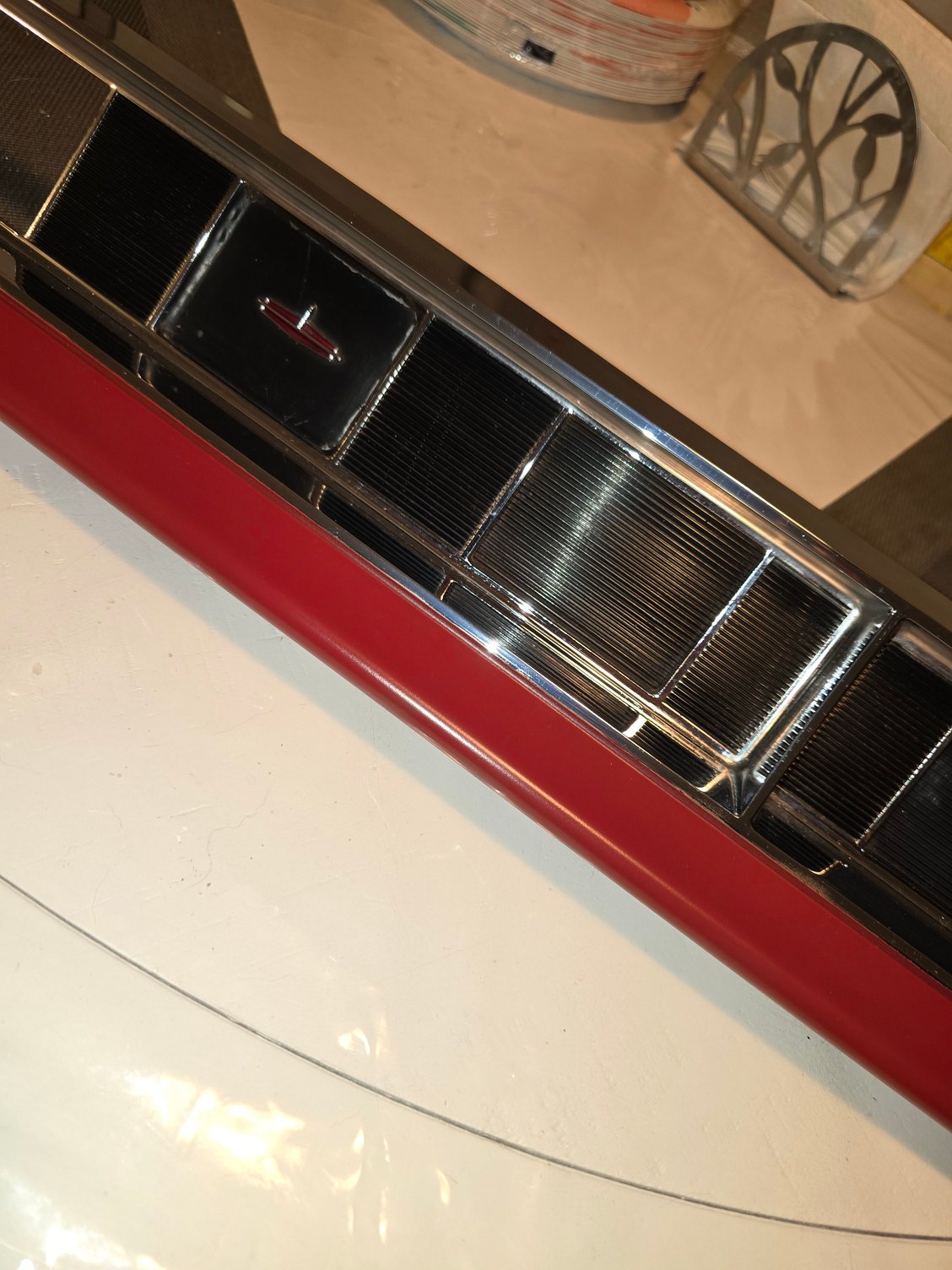

I'll share some pictures of the bezel. It's been painted and polished
color and chrome mostly
badging. It looks pretty good
here's where I'd love to have a clock, and that vent delete is broken in back, scratched and off center
After so much work, a guy would like that to look better, I think...
Like I said, it's broken. Dude used epoxy and a backet, which is fine if he got it right, but he didn't. It's off center, and scratched to **** in front. A lot of work went into making it look that bad- kind of a shame...
Like I said, it's broken. Dude used epoxy and a bracket, which is fine if he got it right, but he didn't. It's off center, and scratched to **** in front. A lot of work went into making it look that bad- kind of a shame...
