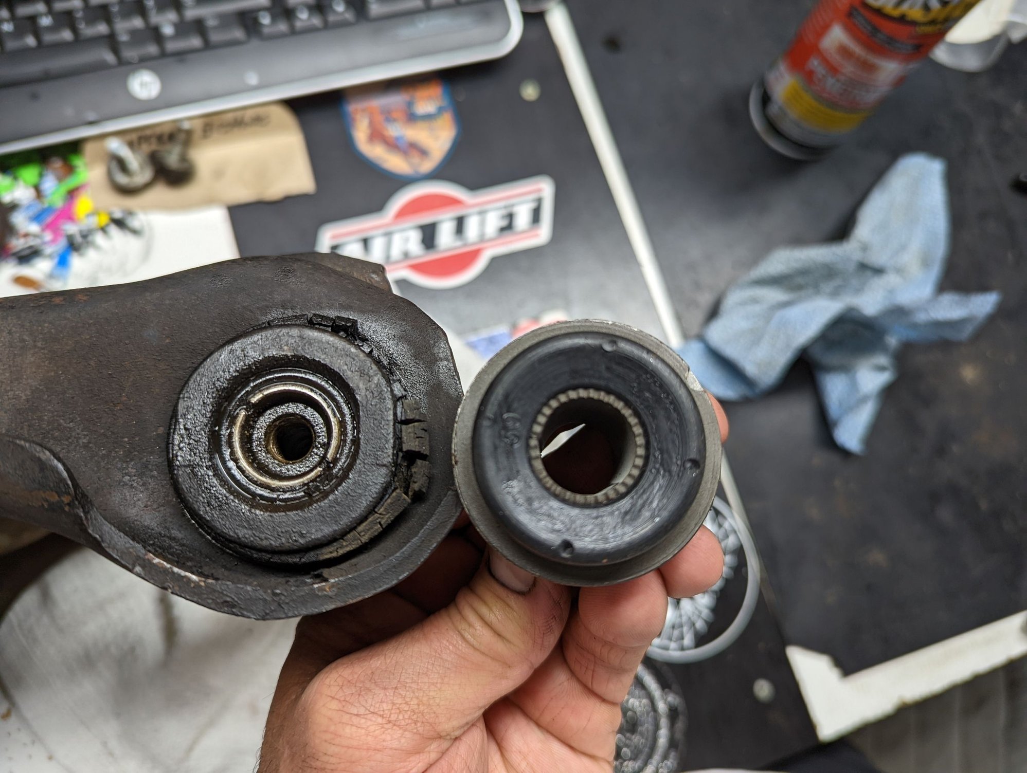

Good morning,
New guy here and obtained this 63 locally about a year ago. Saved up my pennies and now have the resources to get some things fixed. The car came with a bunch of extra parts for suspension etc etc.....All of the control arm bushings are ACdelco from Rockauto and I've never had issues with them, so I took the car to the shop in complete confidence. Low and behold these bushings do not fit. The inside diameter is to small for what's needed. This even goes for the stabilizer bar bushings. Too small! I took the part number and ran it through Rockauto and it matches for a 1963 Dynamic 88. So what gives??? Those parts were free with the car, so those were tossed aside and I ordered new stuff from Fusicks. Again, the bushings and stabilzer bar bushings listed specifically for this car are too small!! The stabilizer bar for this car is just over an inch in diameter. I'm getting 3/4". A week has passed with delivery and now I must get my car out of the shop. Total bummer! Who has the correct parts and why are companies out there selling the wrong stuff??? This car is awesome and we are looking forward to driving it this Spring, but this setback is baffeling. I've read that some of these 63 late models ran 64 suspension, but I'm really hesitant on going through a buy this and that, just to return it over and over again. Some guidance would really be appreciated!!! Thank you!!!

Thank you....the Moog part you referenced is also too small 3/4" K8204. Mine is the larger one at 1 1/16". I did find one on Ebay that is similiar for a later year. I'm going to give that a shot......These control arm bushings are my biggest problem. Thanks again!

1 1/16" is not a stock front sway bar for a 1963. I said the Moog part number was 3/4", which is what the stock front bar was.
The factory upper control arm bushings for 1961-63 full size cars is P/N 5675062, which is the same as Moog BR88. The Moog kit number is K5171, which is long out of production. Bushing OD should be 1.688".
Note that 1964 is different - P/N 388213, which is the same as Moog BR76.

Sorry, my miss understanding about that sway bar. It just dawned on me that this car is equipped with a tow hitch. Maybe why that bar is larger and maybe the suspension is beefier? Thank you for the numbers. I'll look in to these. My new Uppers from Fusicks ID are 11/16" and lower ID is 27/32", I don't have the right measuring devices here at work to check the OD. The mechanic stopped when he noticed the ID on the uppers were too small and wont fit on the bar. I can only assume that the lowers are ok. The search continues. Thanks again.

Once again, there was only one sway bar offered on the 1963 full size cars from the factory. Contrary to what people may say on the interwebs, there was no factory "tow package" offered. In fact, Olds never even offered a factory tow hitch.

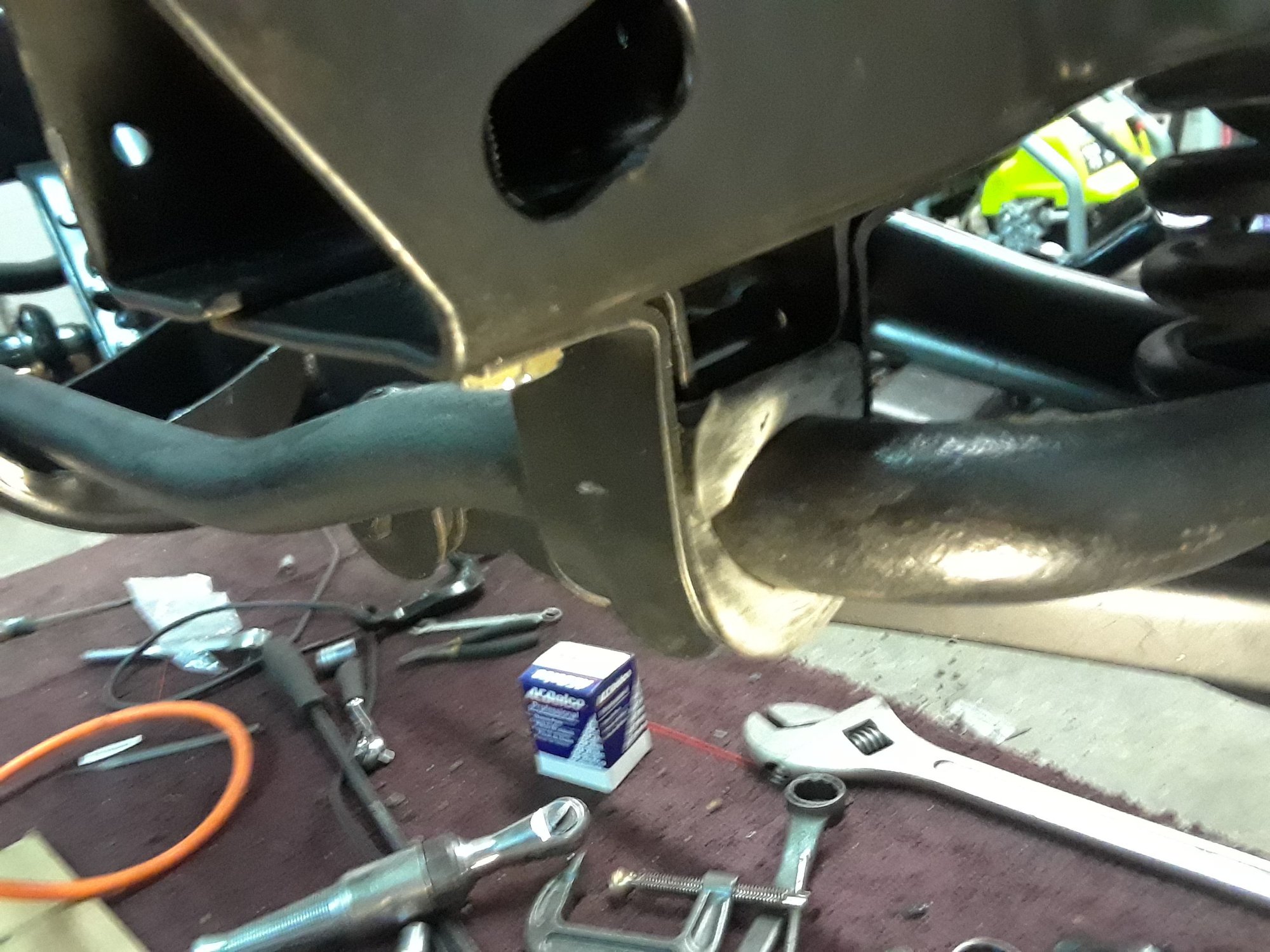

Here's a few pics from my build thread;
This is the Moog bushings installed;
This is the AC / Delco bushing installed;
And this is a pic of the bushings along with the boxes with the part numbers;
These cars handled pretty good for a large heavy car.
The installation of the larger 98 sway bar was an upgrade to make it even better.

I've got one coming similiar to the right bushing pictured. 1 1/16" Saving this photo for future reference if needed.
You have never experienced control arm bushings needing a larger inside diameter? Larger bushing shafts with thicker outside diameters? Since the shop is refusing to take the control arms apart because they claim my bushings are too small, I'll probably have to try and dimantle them myself. Not what I want to do with cold weather and space restrictions. I need to know for my self and learn something new about these cars.

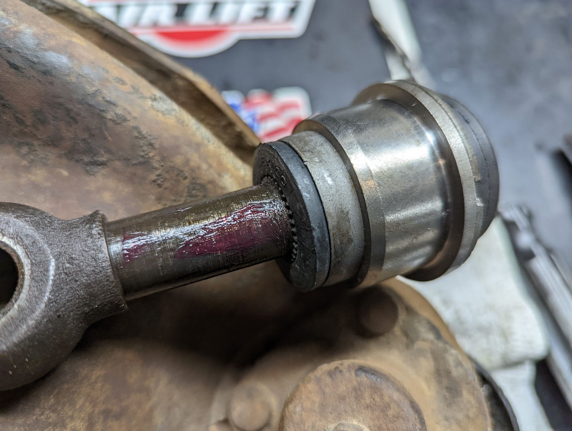

I have the front end pulled apart in my garage right now. Not something I wanted to do due to space and I have the money to farm it out. It is what it is.....From what I can tell right now, the parts from Fusicks will work. The mechanic was worried about the bushing "bar" being to thick and not accomodating the bushing. As you can see, it reduces in size.
I'm looking to get a press and just do this myself. More to come. Thanks!!

This is why there was a question? I'd be skeptical of that "mechanic". The inner sleeve of the bushings is designed to bottom against the step on the shaft so it clamps into place. The mechanic didn't think to look at the open end of the old bushing for comparison?

That's the thing.....I don't know what his findings were or how he came to these conclusions. I've never taken an Olds apart, so I knew this was going to fall in my lap and be a good learning experience for me. Better than possibly having the car stranded in a shop and getting a tow.

Glad to see you're on the right track with your lower control arm bushings.
Do you have the 1963 Oldsmobile Service Manual ? If not, it's the best investment you can make.
Original printed copies are preferred. There are several on E-Bay now;
1963 oldsmobile service manual: Search Result | eBay
Here are a couple of photos from my build thread that may be helpful'
I used pieces of PVC pipe and large sockets to push them in place.
I bought a 1 ton Harbor Freight arbor press and it was barely adequate for the job.
I would recommend a two ton arbor press, maybe get a used one on E-Bay.
If you also decide to do the lower arms ( which I would recommend ) I do have the special tool (plate) that is used to press those in.
I would loan it out for a $50 deposit. PM me.
