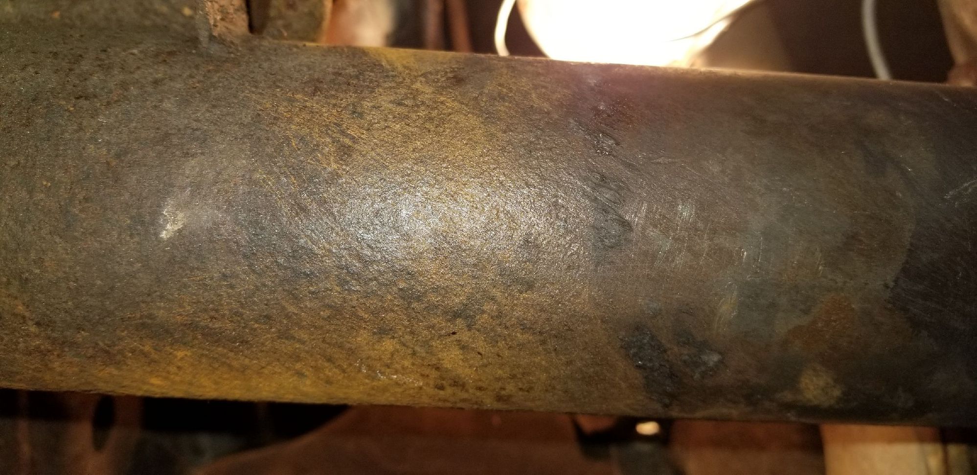

Look on the front of the tube, close to the tail pipe.
Old Nov 16, 2019 | 06:18 AM
Cosmic Charlie's Avatar
Joined: Sep 2018
Posts: 633
From: Newburyport MA Area
This is my Right Axle facing front toward the top - I see nothing - and I have checked like 3 times after cleaning it up +- There is a vent hole on top (without the rubber plug sealing the hole +-)

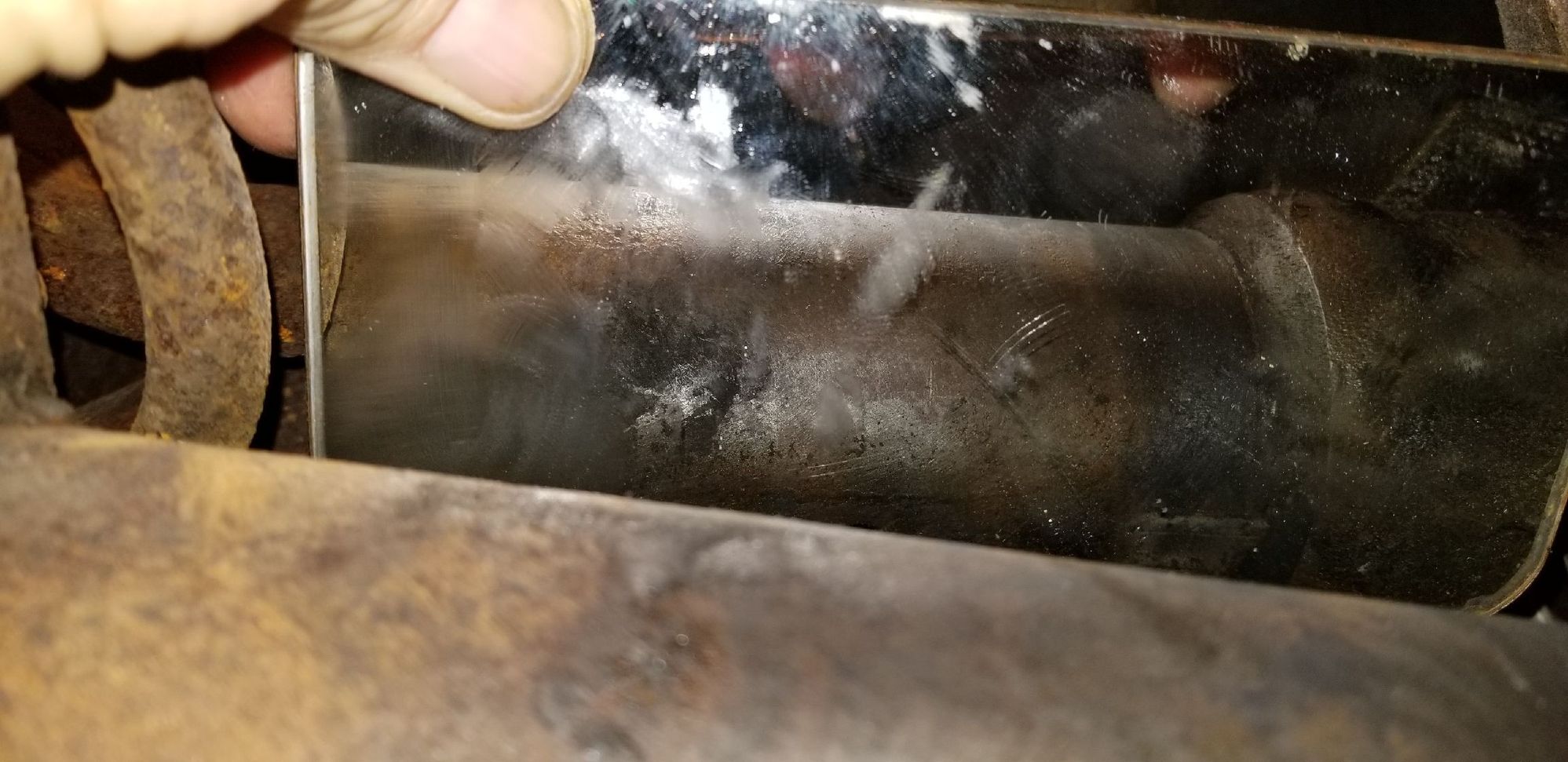

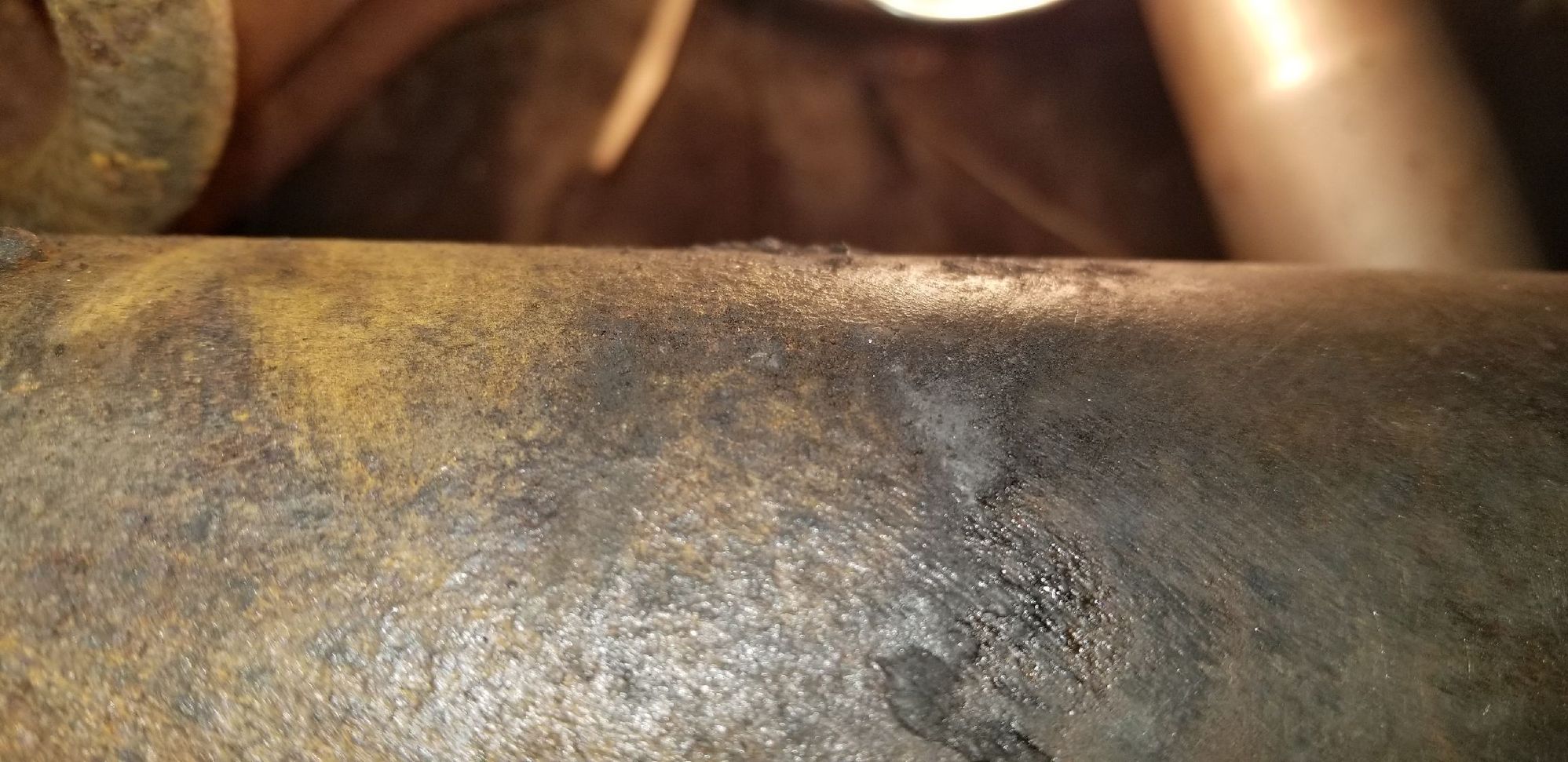

Yeah, I see that. Sometimes the stamp is so faint that it is invisible. Try wetting it with WD40.
Old Nov 16, 2019 | 09:07 PM
monzaz's Avatar
Joined: Jul 2006
Posts: 1,826
From: Richfield, Oh
ALL ARE ON THE PASSENGER TUBE FACING THE REAR OF THE CAR AND THE LETTERS ARE USUALLY UPSIDE DOWN
2 LETTER/ NUMBER CODE
Geez, Not yelling with the caps. . sorry.
IE - R2 SA SC something like that
\Looks like it might be a bit tight where you need to look behind that passenger exhaust tube.
wire wheel / flat file / if it is too rusty it may be a moot point.
