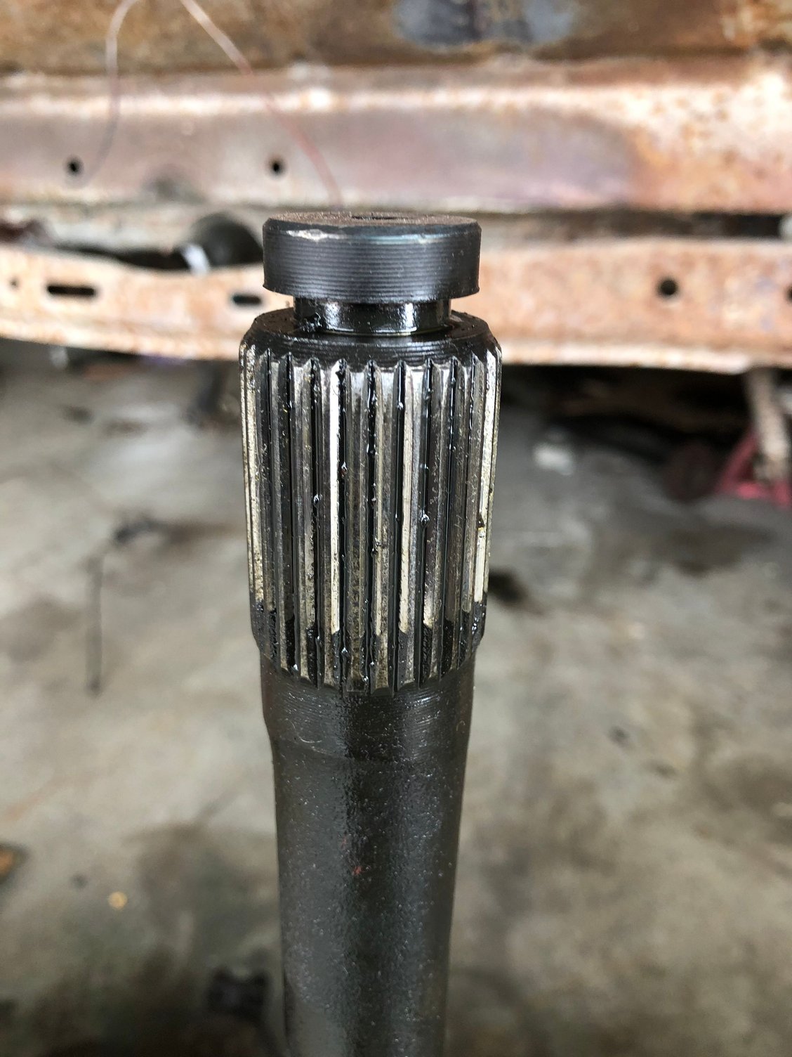

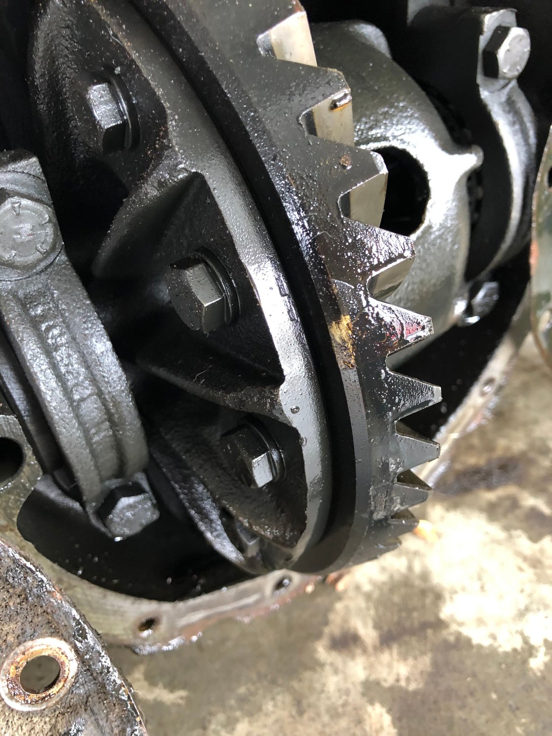

I'm so embarassed about this thread. I hijacked a thread and then gave false information. And now I'm changing information again. It does have a 12 bott ring gear, tapered axle housing at drum backing plate. It also has 28 spline axles. The small axles are my question. I want to add a positraction, and 4.11 gears. Seems that most posi units are for 30 spline axles. It's going to be mostly a street machine but I'm also adding nitrous. I'll also have a pair of slicks or at least drag radials. Thanks for your replies and patience.

How about you post a photo of the cover on that axle, so we can stop guessing which axle you have.

pictures of diff

Chatt, this is the 12-bolt Chevrolet type rear axle that uses the 'C'-clips. There is a pretty decent aftermarket support for finding parts for these. Monaz in this group would be able to help quite a bit in getting what you need.

So you are saying your axles are 28 spline?
I would recount and be sure.
IF they are 28 spline someone has modified the posi unit which is REALLY weird...as all 12 bolt c-clip chevy rears were 30 spline. Period.
Please recount and make every spline and try again. Jim

30 splines. All a 'go' for upgrading. Thanks for all the help!
