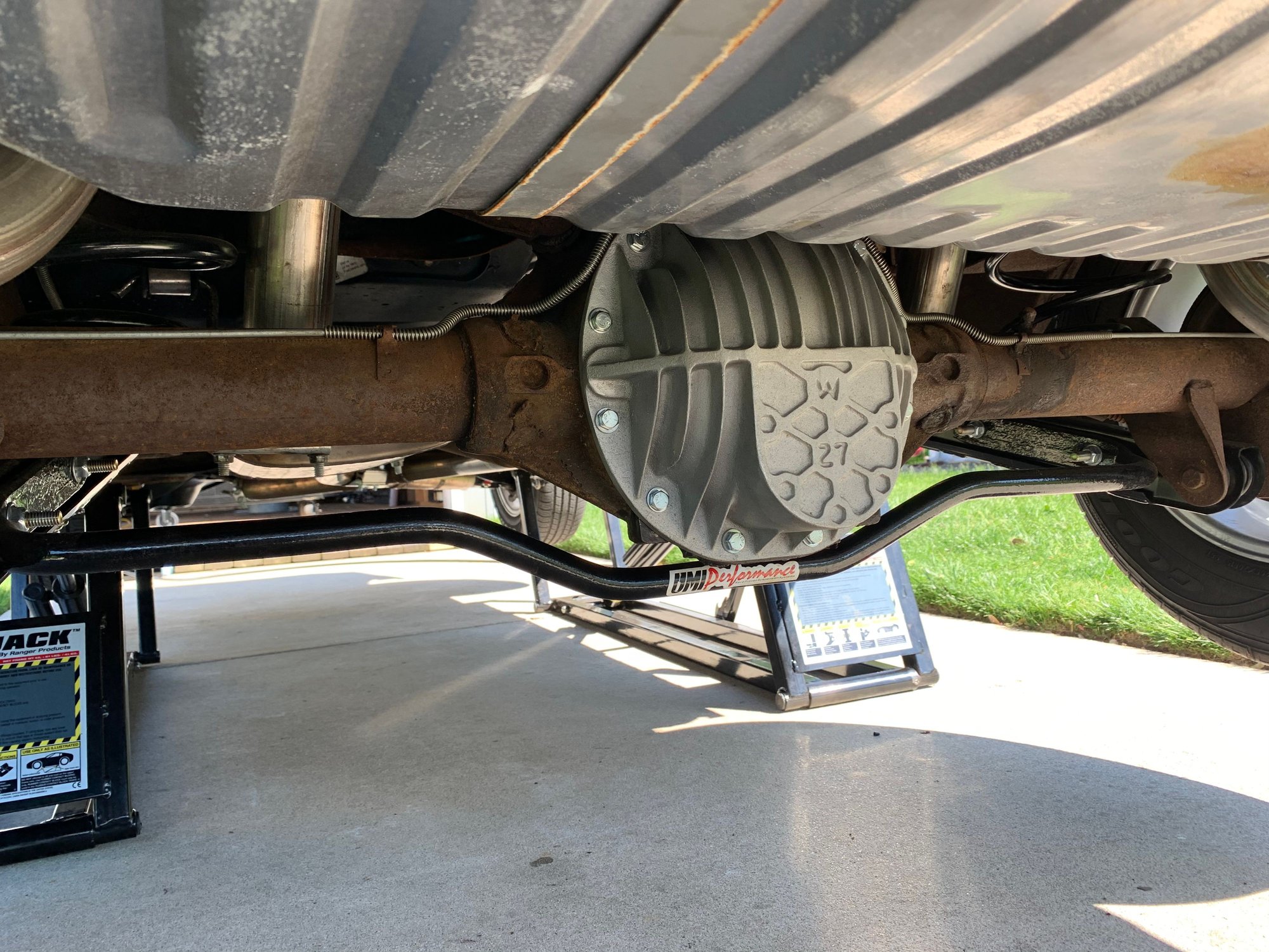

Hi,
Is there any way to identify gear ratio from the attached picture? Forgive me if this is a dumb question, I know very little about differentials. I changed my cover, gasket and gear oil this weekend and snagged a picture of the only stamping I could find.
If what appears to be ‘16’ & ‘41’ in the first part of the stamping that would equate to a 2.56. Am I looking at this correctly?

Yes - you are looking at this correctly. 41 tooth ring gear. 16 tooth pinion gear. = 2.56

that is correct.
Is that a 12 bolt cover 10 bolt ring gear rear? Looks like it
Yes sir. I replaced the cover with an aftermarket cast W27 cover and new fluid. It’s a one-wheel peel and not going to shock anyone but it runs great for highway and around town.
This was after the cover and fluid change.
