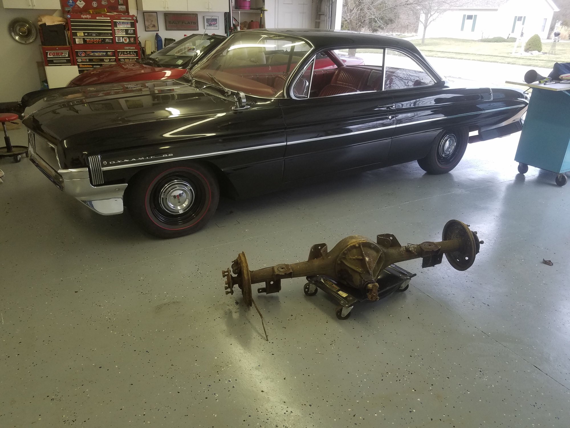

I bought a 9.3 rear end supposedly out of a 61 Starfire. I haven't opened it up yet, about the only thing I have done is digging out from the weeds and dragging it into my garage and Order the book from fabcraft (hasn't arrived yet).

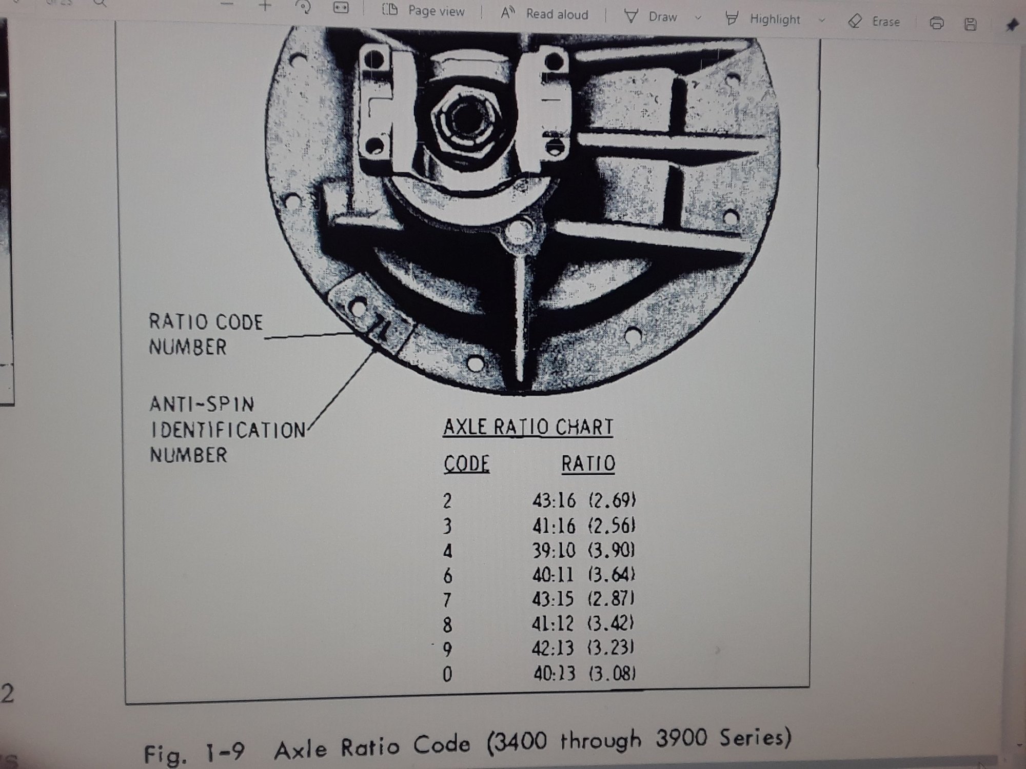

There is a number stamped on the front face of the diff housing in the seven o'clock position as viewed from the front .
It's between the bolts that hold it to the axle housing .
You can look the number up in the service manual to get the ratio .
If there is an " L " stamped next to the number , then it is a " Posi " .
If it is a Starfire rear it should be a 3.42 .

I didn't see anything stamped but this casting number is around the 9 o clock position. It could be too dirty to see the stamping I will have to take a wire brush to it.

Yes. you will probably have to wirebrush the area to see the number .
According to the casting date D 25 1 this part was cast on April 25th, 1961 .

I haven't torn it down yet but I did clean the area that is supposed to be stamped. All I can make out for sure is an "X" and what could be an 8. Unfortunately only one axle spins when I turn the pinion. Backlash doesnt seem bad at all though.

If that is an " 8 " then it should be a 3.42 ratio .
That is a good " get up and go " ratio .

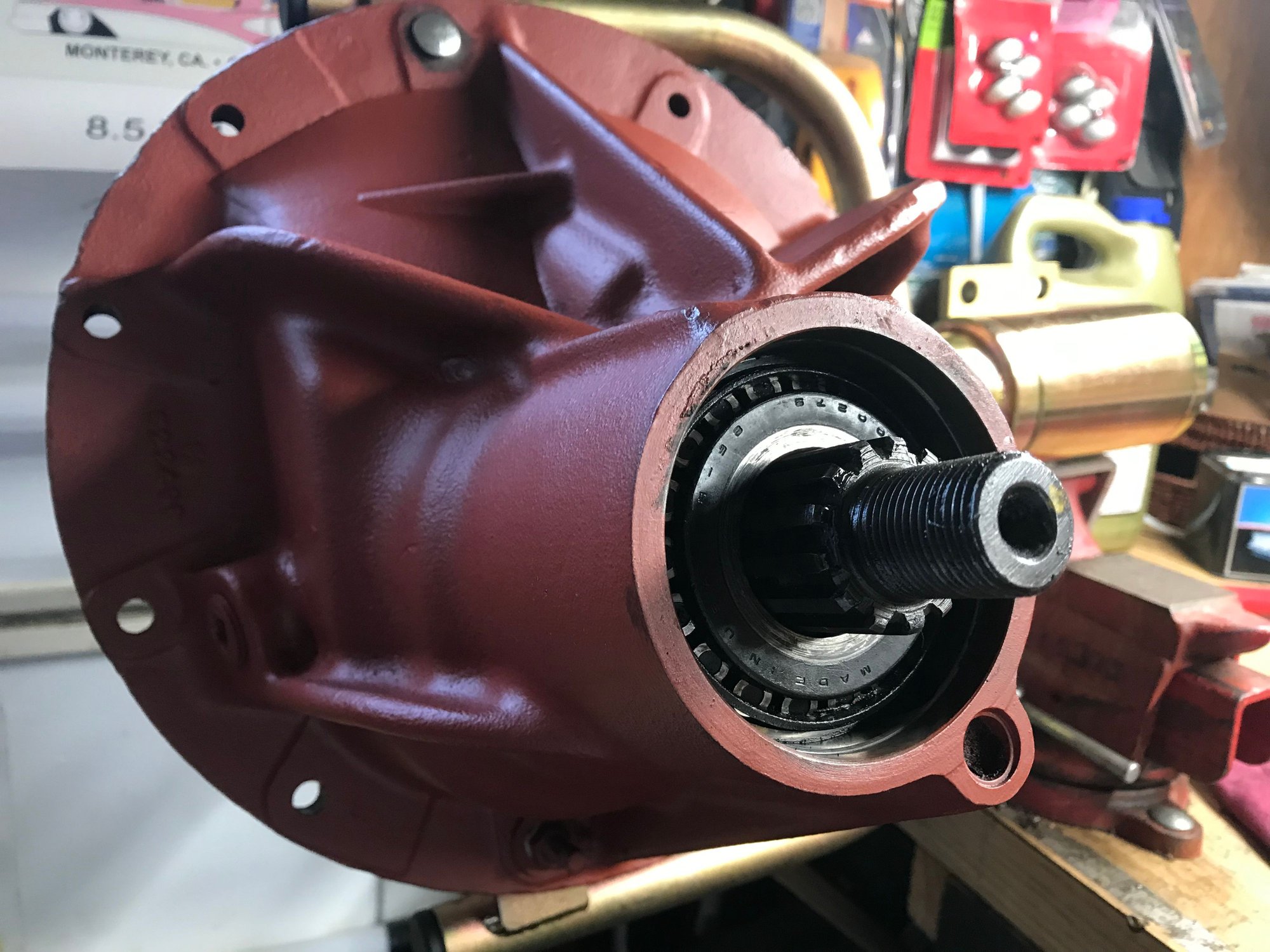

i just redid mine , with big help fro FabCraft and thier book .. a few new tools too .

still looks like old pinion bearing to me?? Jim

Good eye Monzaz .... that was "setting up " ... It took me weeks to complete . Many hours on the utube .
warched this one many times :
still on the brake in period

sorry do not agree with many of his techniques...lol.
to each his own. the tapping of the pinion bearing onto the pinion shaft is totally goofy...
good way to screw up a seal.
