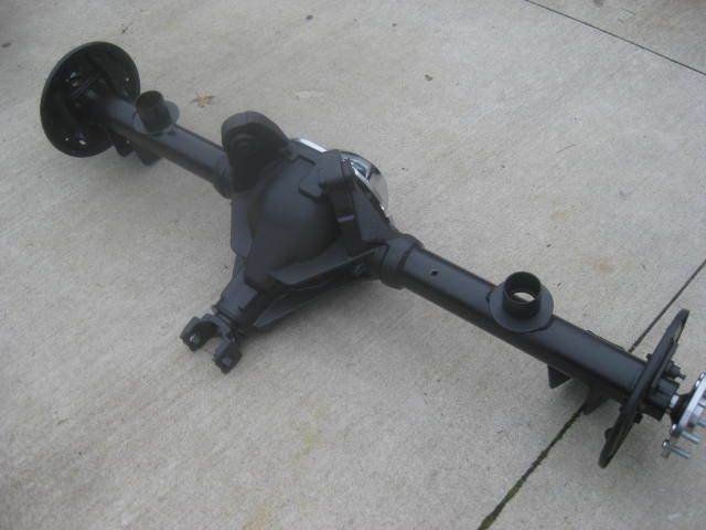

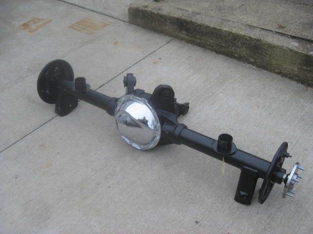

I sell a BRAND NEW Moser 12 bolt for your car for 2400.00 so where in gods name is he coming up with 3000.00???

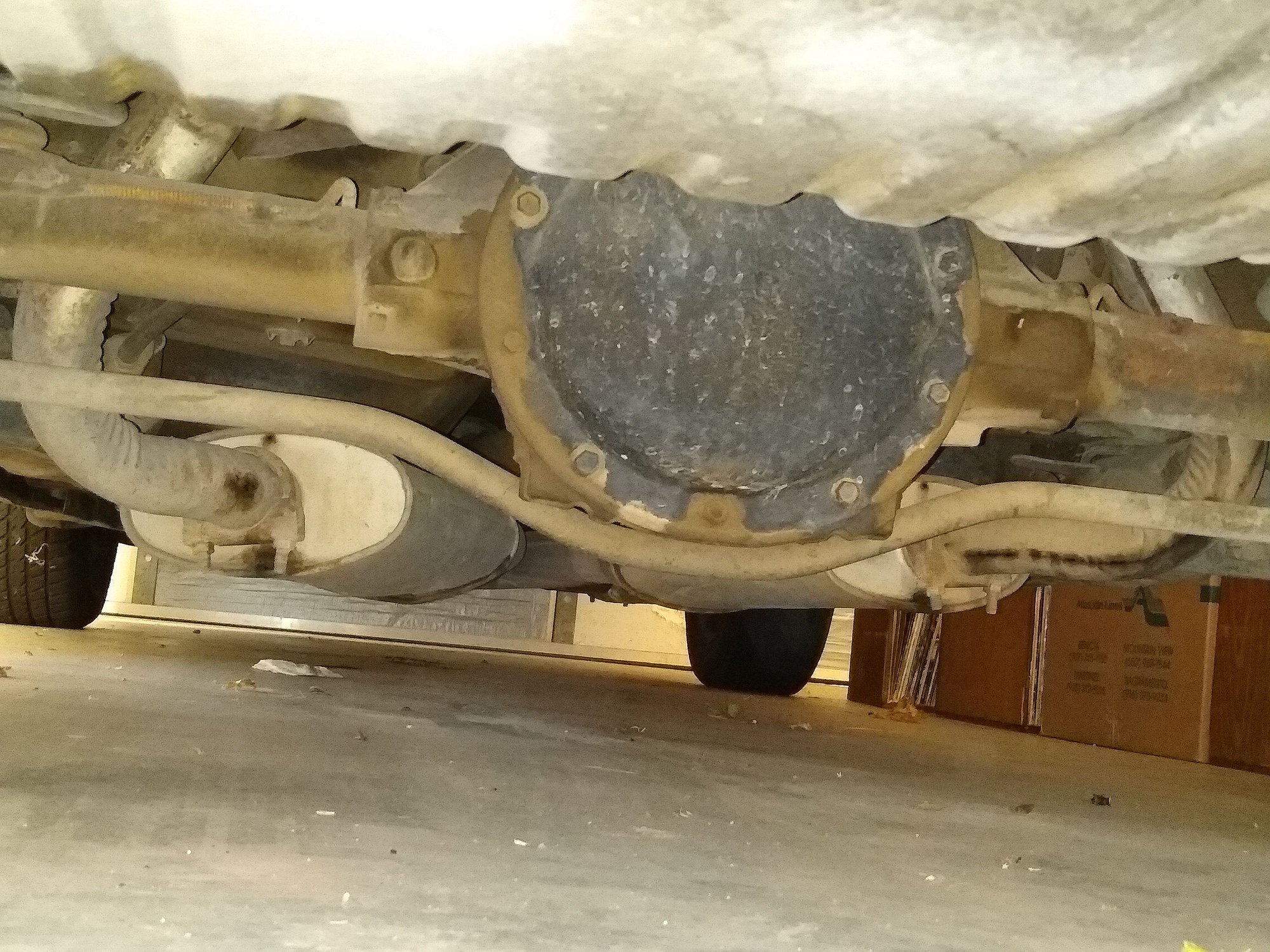

Here are a couple pics. I did what I could, but let me know if I need to try and get something different of a scale is needed. The mechanic never actually pinointed the problem it turns out. To me it sounds like a bearing maybe. The sound is low and grindy and only audible at low speed(usually turning) or in reverse.

Yes, NMolds the pictures you provided indicate that it is in fact an 8.5. The triangular tabs opposite each other on the bottom of center housing are a tell-tale sign.
Everything Rob said above is dead on. These are fantastic differentials known for being durable.
