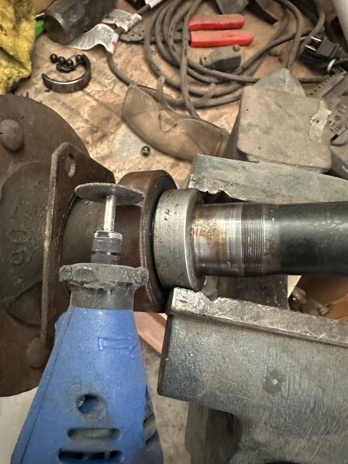

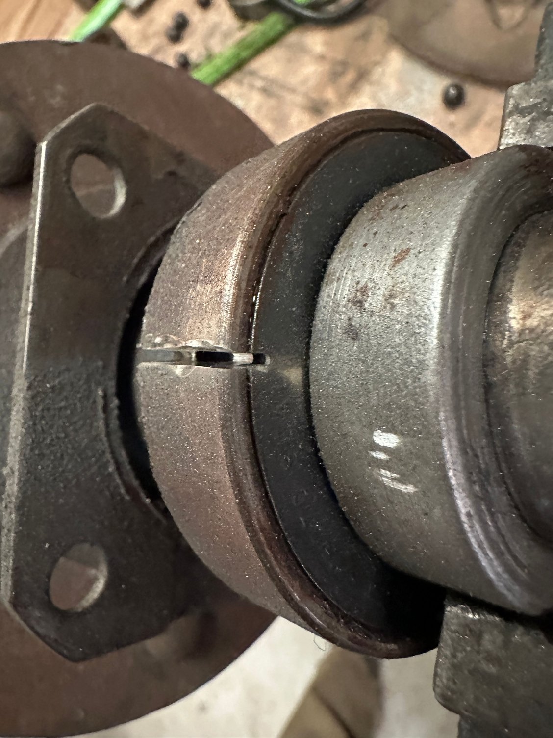

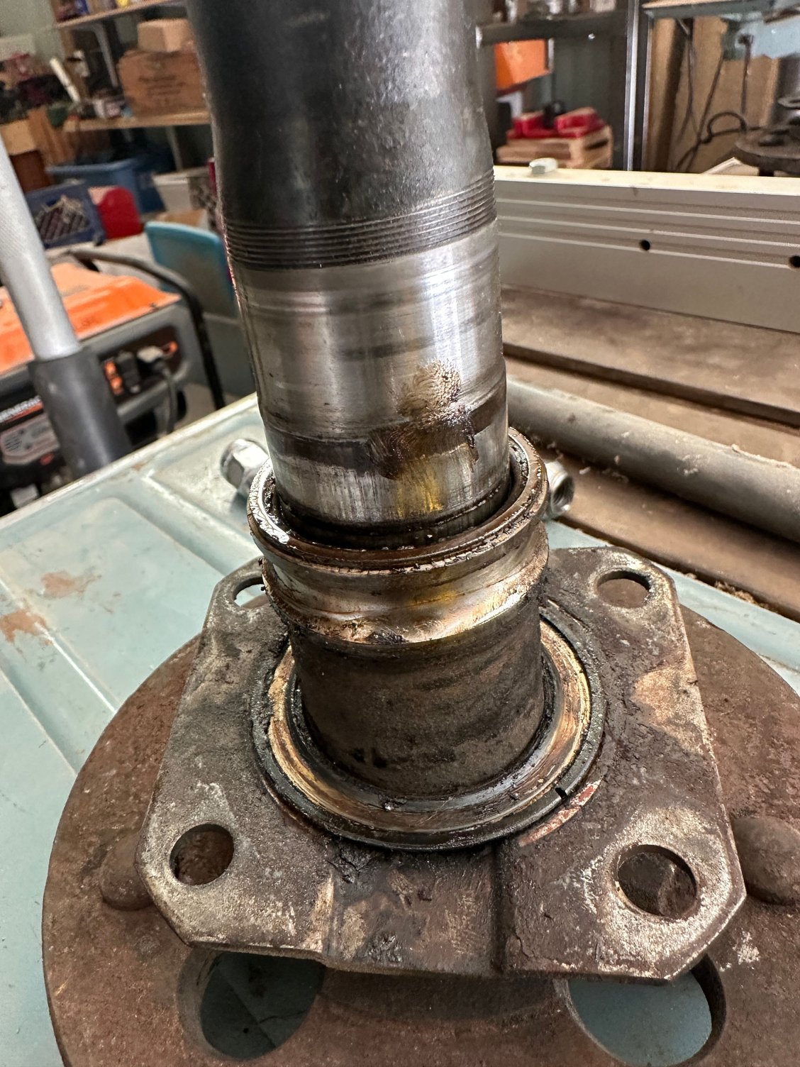

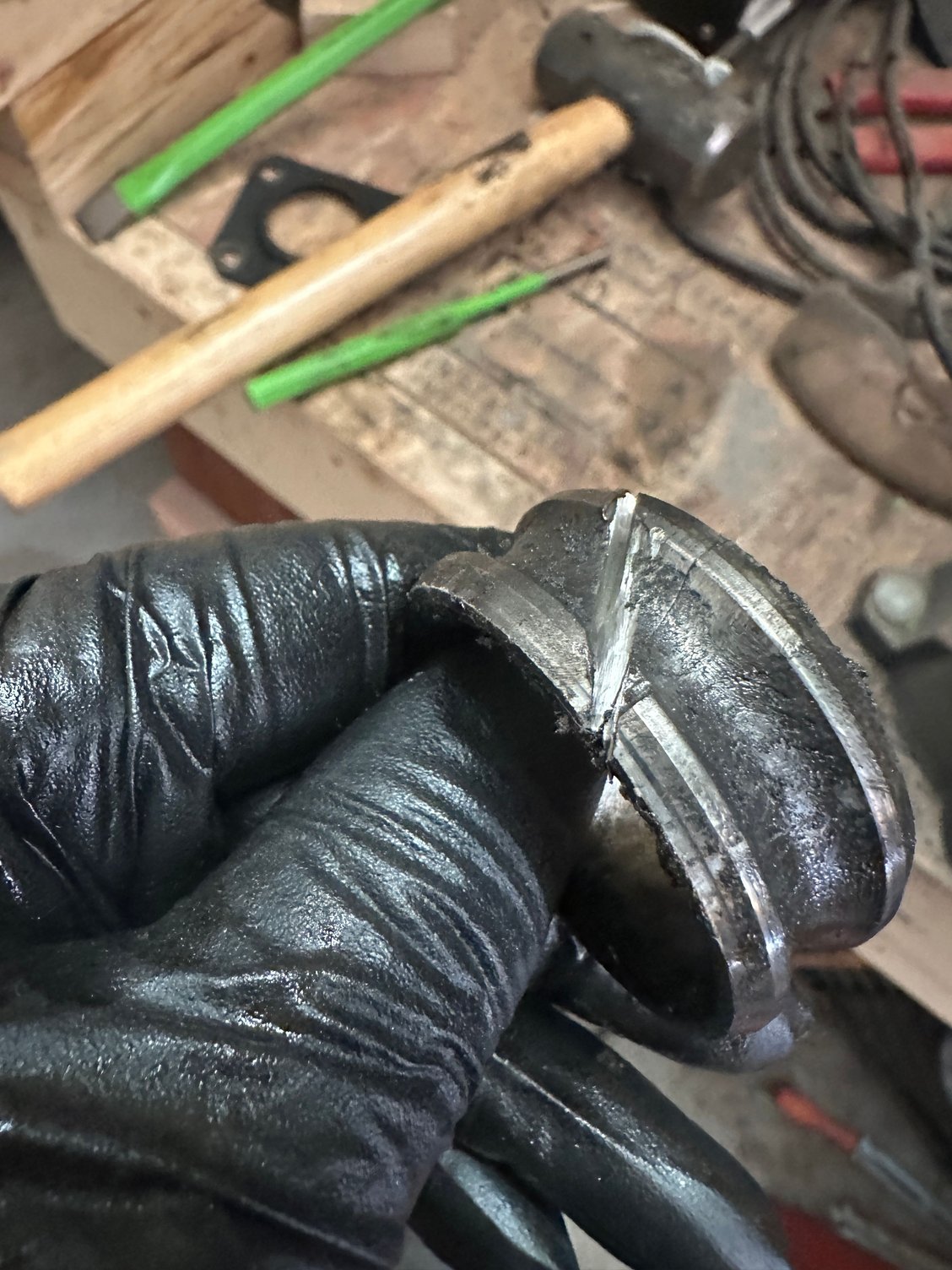

project was much easier than anticipated. Took about 90 minutes start to finish. Used a Dremel with cutoff wheel to remove outer race first so I could access locking collar. After cutting collar most of the way through, slid a cold chisel through hole in hub to tap off. Cut inner race and tapped off. Easy Peasy.

with out a press...That is the way you do it. Good job.

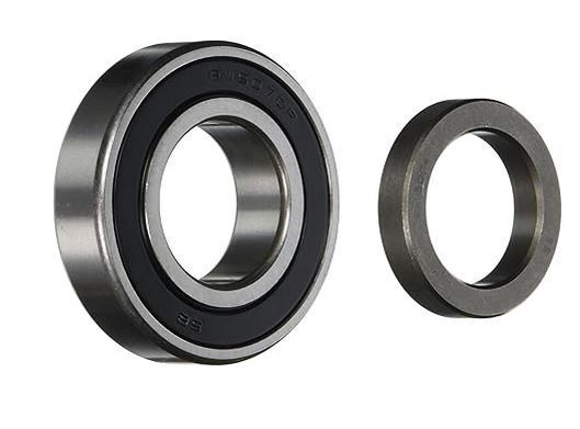

68 442, O type, 8.5, Question....In my quest to find anything that has a USA made stamp on it, I stumbled on this type of RW507CR, the one piece design.
Can this be interchanged with the traditional two piece bearing/retainer RW507CR? I did find the one piece USA made.
One piece
Traditional 2 piece design, of course CSJ...(china super junk).
Old Aug 11, 2025 | 08:14 PM

RW507C IS A BEARING ONLY....
RW507CR IS A BEARING AND (R)ETAINER (the ring in front of the bearing.) They used to sell these parts separately
Jim
