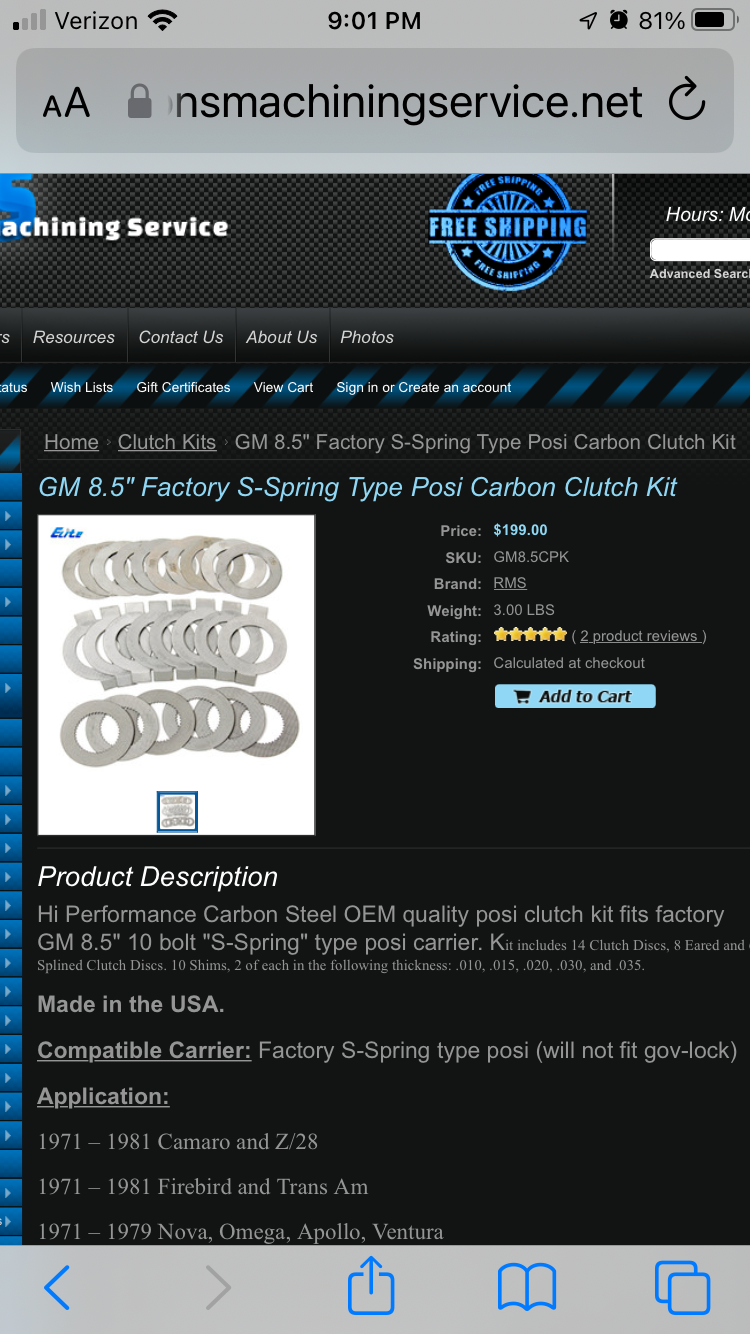

Old Oct 13, 2024 | 09:05 PM
Posts: 15,394
Note the same part number for the 8.5” 10 bolt clutches and the O-Type clutches.
https://www.ronsmachiningservice.net/compare/2034/2035
