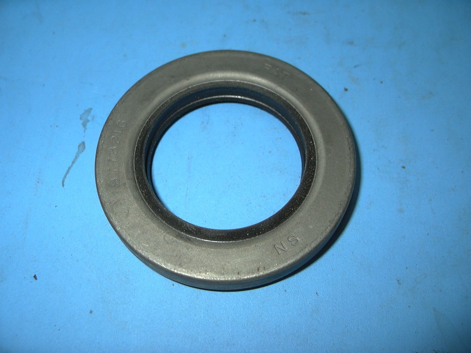

Does anyone know what the right pinion seal is for my 65 442? 2043 seal is not correct!!!! my Old seal has an OD of 2.655 +or - .001 My pinion shaft where the seal rides is 1.649 +or- .001 any help would be great!!

OEM part number is 9773216, 1964-65 F85 and J88 only. This crosses to SKF 16500. ( 2.666" od 1.645" id )

Thank you Joe I figured if anyone would know it would be you!!! I just got back from Napa who had it. $38.00 I probably if I searched around could have found it cheaper but they had it in stock

8620 IS ALSO A GOOD NUMBER FOR THAT Buick SEAL.
