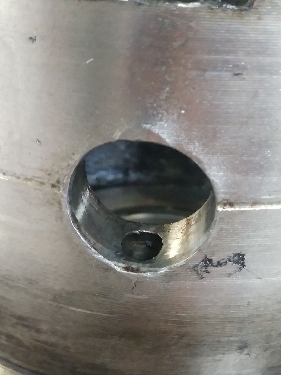

to all !! joe greg at supercars unlimited has a carrier but i cant use my GM ring & pinion, according to the rear end builder the 5/16 bolt that holds the pin in ?? has let loose at one time and has mushroomed the carrier where it bolts in ?? i havent seen it yet, it has been repaired i just brought it in because i wanted it double checked before i put it in the car, he said what probably happened is the car had bad wheel hop that's what caused the implsion inside the rear end, he asked me what we would be doing with the car, it only gets out like 3 times a year and then 5 to 6 times to the track 1/4 mile he said knowing that i should replace the carrier then better safe than sorry !!

pics added !
got the pics, here they are !

Well you will need a pinion cross shaft and at least one spider gear as the thing started to fuse to the shaft...WHICH means the posi was not probably holding tight enough and will need to be looked into also check all the clutches and reshim or replace with new.
That is what I can see so far.
Jim
