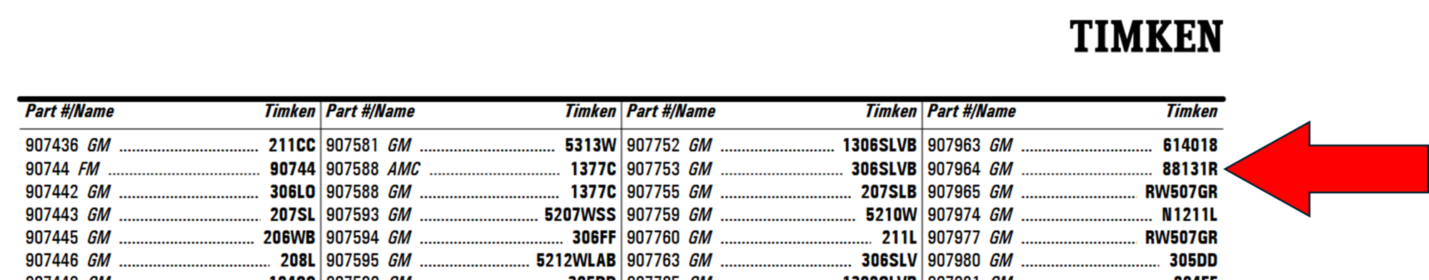

Posts: 50,768
88131R is the Timken interchange number. This is from the 2011 printing of the Timken interchange book. Most other bearing vendors use this number as well (National, for example).
