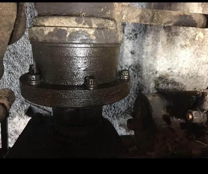

These pictures below are internet pics for reference, not mine.
Looks like someone had to double up on the washers with this one.

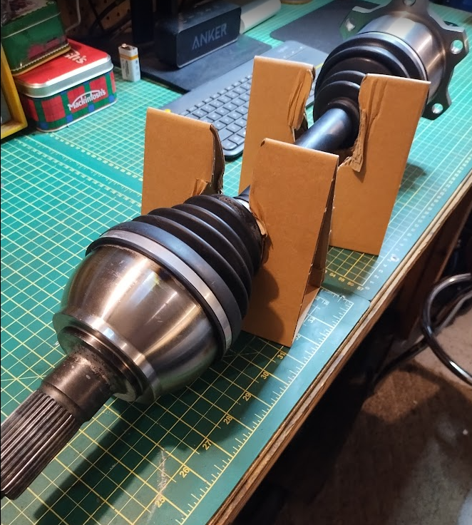

Took a big risk on this purchase. Will it fit correctly? Who knows, but I'll find out. I would imagine these PN's are "technically" for later era Toronados and not specifically for a '66 but will see.

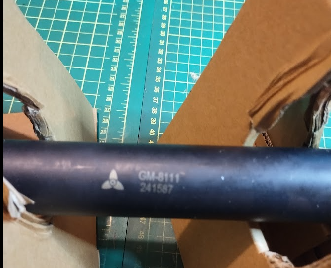

Just curious, what was the actual GM part number on the box ?
The only part number on the box was GM-8111. There's a few companies selling these things and I'm sure they're all the same ones but god knows if it'll work on a '66.
