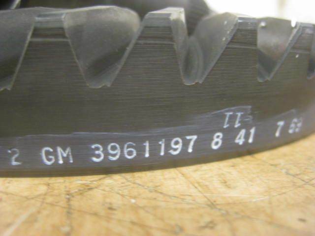

Just remove the rear cover and the outer diameter of the ring gear will have the part number and tooth count of each gear and even date of the gear set stamped into the metal ring.
IT is a whole lot easier than guessing. PLUS if you have not changed the oil in a while you can do that also.

Thank you Monzaz, much appreciated.
When i first got the car I asked my mechanic to check rear end fluid. But my concern was more quantity than quality. He checked via shortcut never removing cover. Adding this to my current to do list, its getting longer... Hoping to get some passes in before season over.
