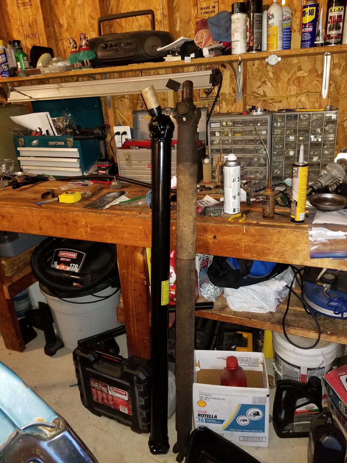

Well they were semi easy to get out, but I had to use a ball joint press to get them back in. I tried to use those videos for reference but mine weren't that easy. Now all I need is my new drive shaft and its all good to go!! Thanks guys

Yup... and I just got my new drive shaft today.

Can you post the length measurements for the two drive shafts?
I need the length to determine which shafts go with the O-Type and which go with the corporate 10 bolt.
I shoulda marked 'em when I pulled em.

Originally Posted by svnt442
Longer is for the type-O.
That I know, but I would like actual length of each.
